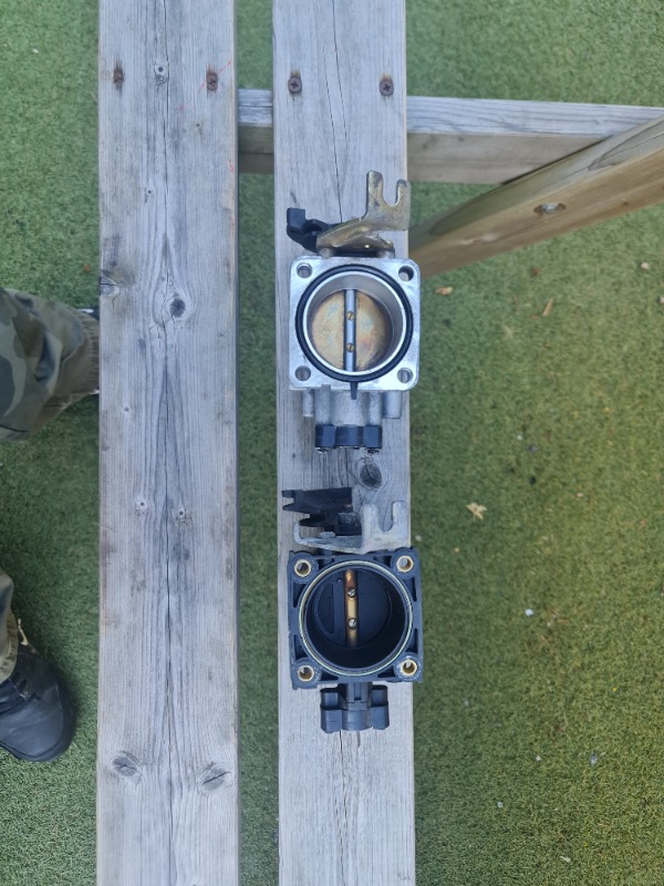

Today I finally swapped the old plastic throttle body for a 52mm alloy one.
I haven't really noticed any performance increase but it seems much smoother and more responsive.
I'm going to look at getting a better air filter to see if that makes it even better.

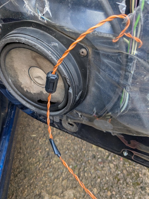

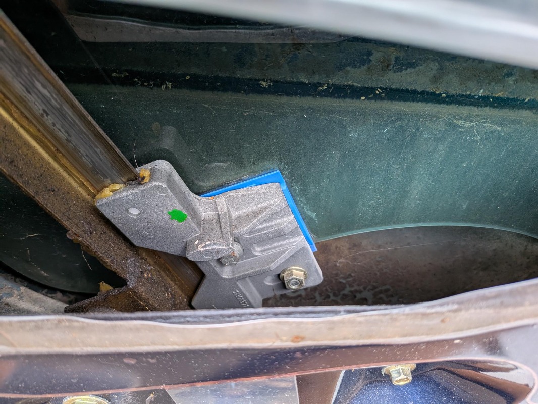

Installed New/used speakers, woofers and tweeters, the old drivers side woofer was still working, sort of,  well I think I got my moneys worth and the passenger side tweeter never did work.
Great opportunity to grease the window slides too.
