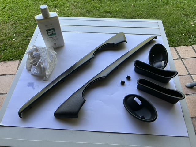

Among other things, I cleaned the door´s plastic parts with Brian´s recommended product, which worked a treat.

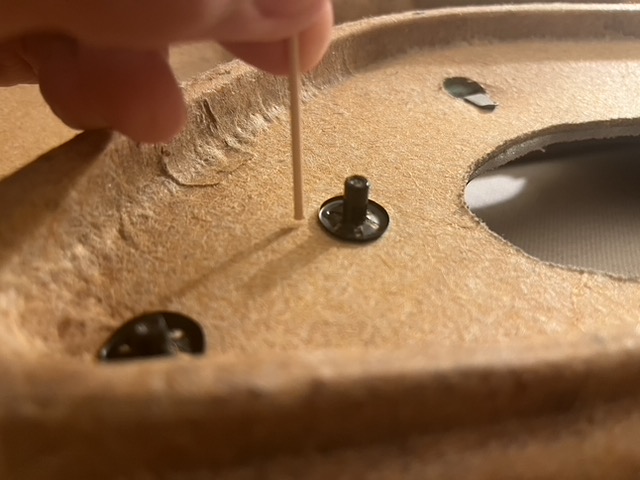

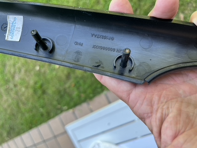

And repaired the small and fragile plastic pieces that affix that ëyebrow¨to the door card. When I dismantled the door I managed to break a couple of them flush with their base. So I cut a toothpick, put it inside the cylinder, and poured Loctite in while holding it straight (the longer toothpick makes for an easier alignment) until the glue hardened enough. Did that several times until the little assy cylinder-toothpick was full to the edge, and cut the tooth pick flush. The result was so good that I treated all the rest of the unbroken cylinders the same way.

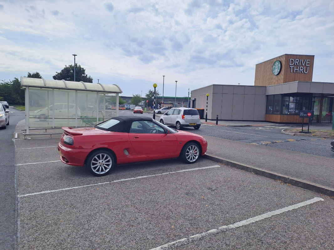

Then went shopping, the MG fits in the parking spaces a lot better than my last car, where I could only park on the edge lol

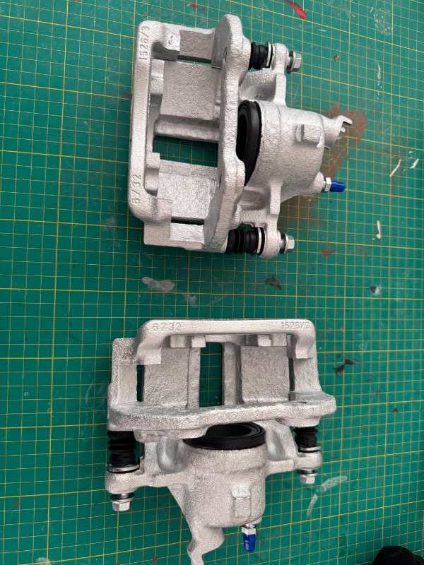

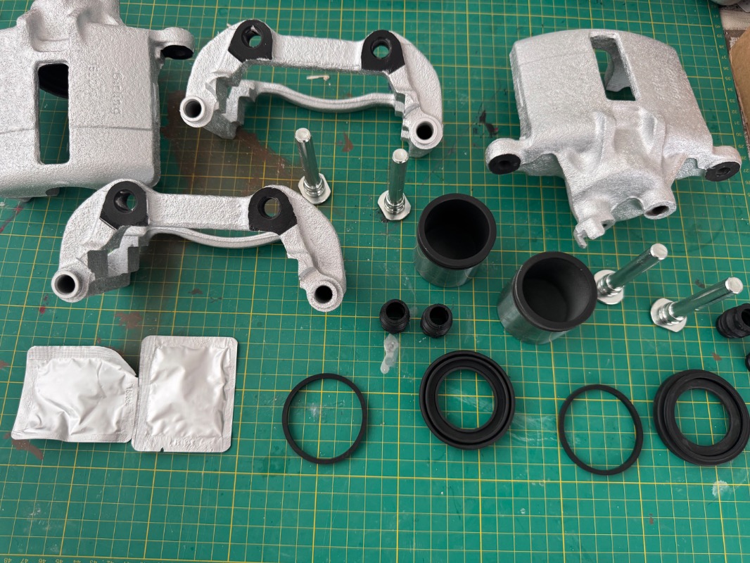

Stripped my front callipers down, soaked them in citric acid, painted with VHT paint and re-assembled.

They look really good. A very thorough job youve made of those
Posted 10 months 4 weeks ago #218355
They look brand new. Brilliant job.
