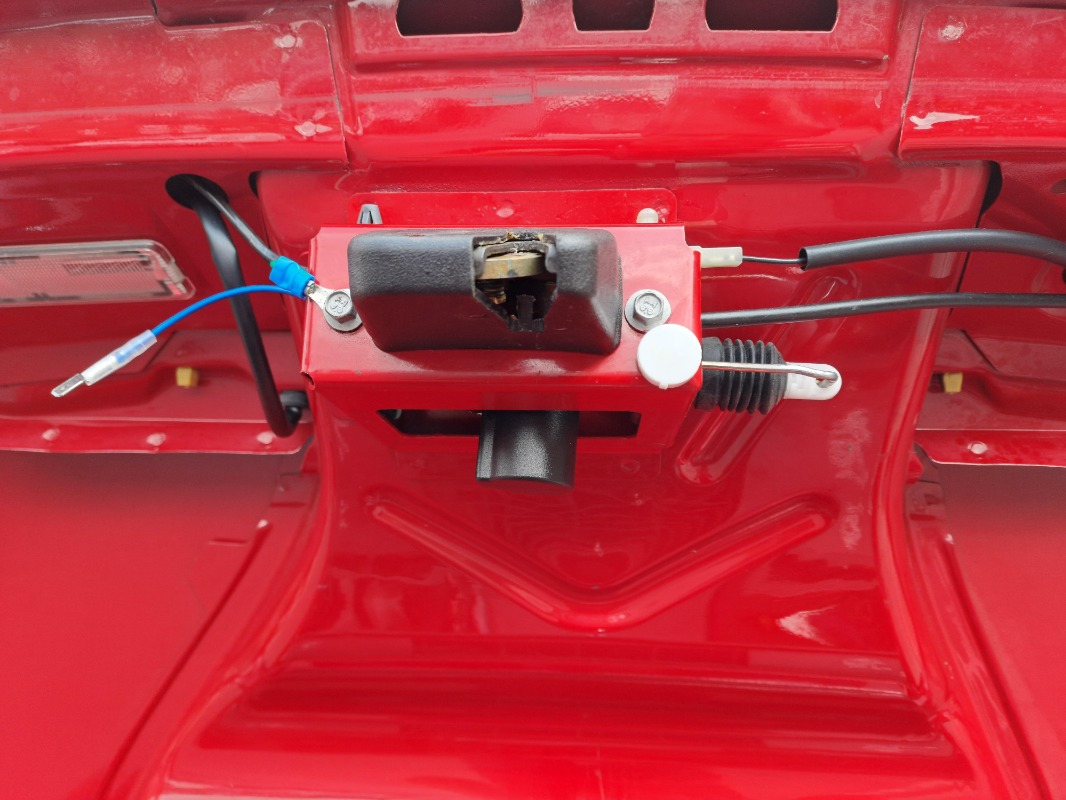

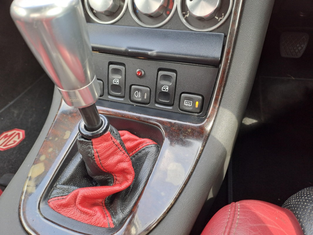

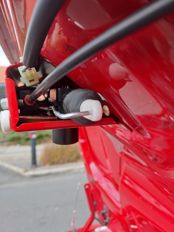

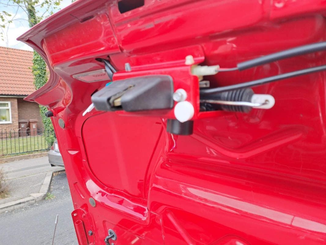

Fitted heated rear window switch and relay (for when i get glass window or hard top ), moved the low coolant warning light from the blank switch to the middle of the facia.
Then fitted the boot popper
by the time I had bent the rod into 745 different orientations, making brackets and spacers I couldn't be bothered to wire it in .
I tested it on the boot light and works fine .... blew the fuse taking the bulb holder out, great idea having a bare metal live right on the edge.
Wont take long to wire it as I`ve done all the prep wiring (on a bit of wood) .
