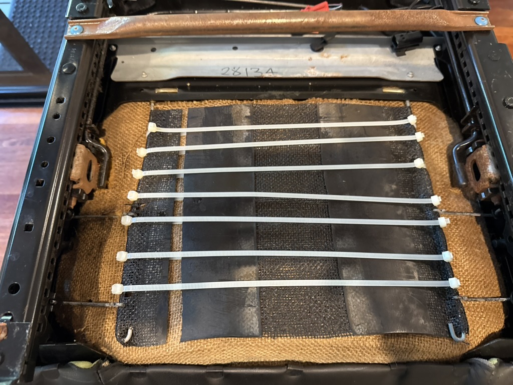

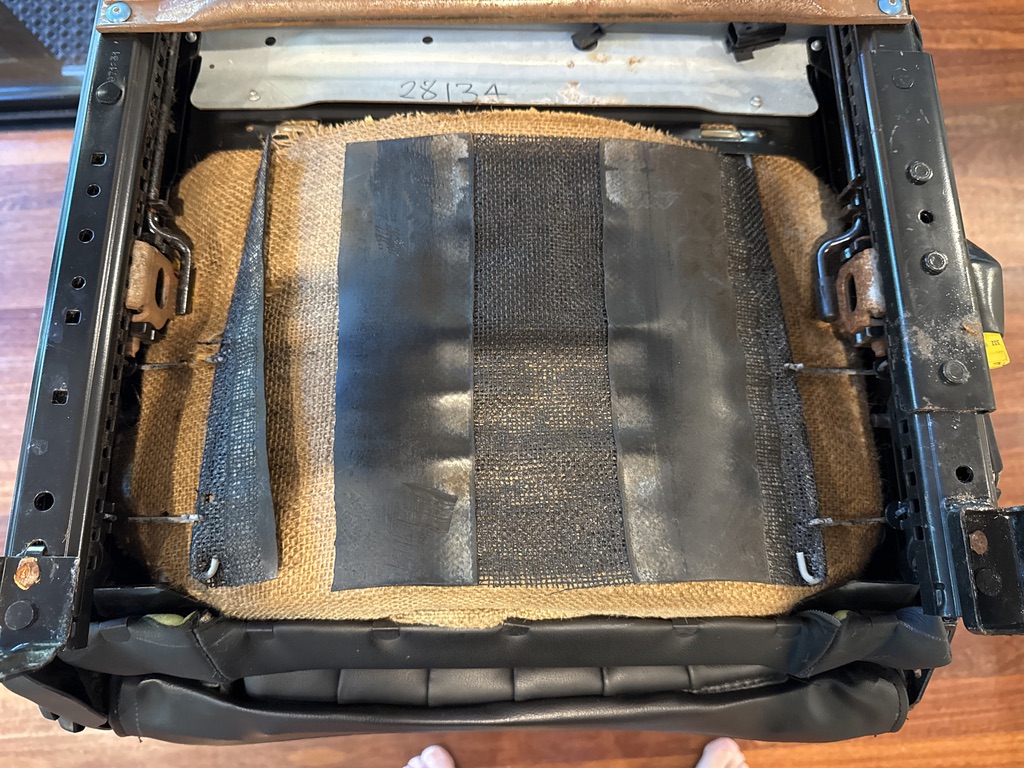

 My weekend was spent fixing the sagging drivers seat and what a right PITA it was to remove the rear inner runner bolt!

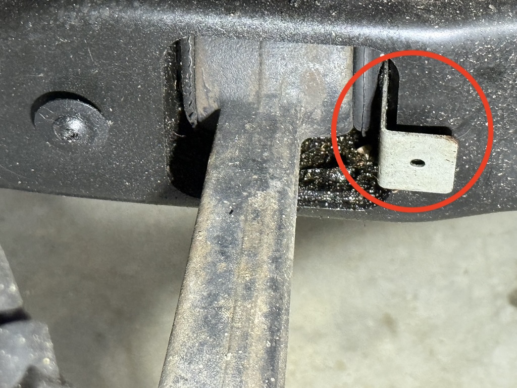

...and can anyone tell me what this little bracket is for? I noticed one on each side at the rear whilst greasing the suspension.

The seat diaphragm has split in 2, if the cable ties don't work you should be able to get another diaphragm, my Triumph TR7 has a similar set up and I was able to get replacements for them from Rimmers.
No idea about the bracket, it's probably just there to bamboozle unwitting owners!

As I understand the little pronged bracket is supposedly there to locate on the bushes as a means of preventing them turning within the lower arm. When I replaced bushes with poly ones I could not physically replace them (brackets) on/in my 97F so I haven't got them fitted now. You will have a job to find any new ones. G.

That makes sense Glynn.

Someone said those brackets were shims for the bush so I kept them

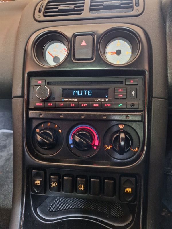

Replaced the Pioneer digtal radio that ran via an App with a Blaupunkt retro style radio and CD player.
The sound on the handsfree is amazing. Sounds like an old valve radio.
