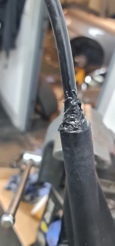

Today I tackled the leaky oil filler contraption and the failed dipstick gasket, as i was giving it a service as its done 1k since a new MLS head gasket.
Not sure if the seal on the oil filler reservoir had rolled the internal O ring at some point or if its just gone a bit funny after 23 years, and decided not to seal anymore. It was certainly quite loose on the dipstick tube.
Whilst new seals and plastic holders seem to be available, I didn't have one to hand so put the old one back together and then coated it liberally with stickaflex.
New gasket:

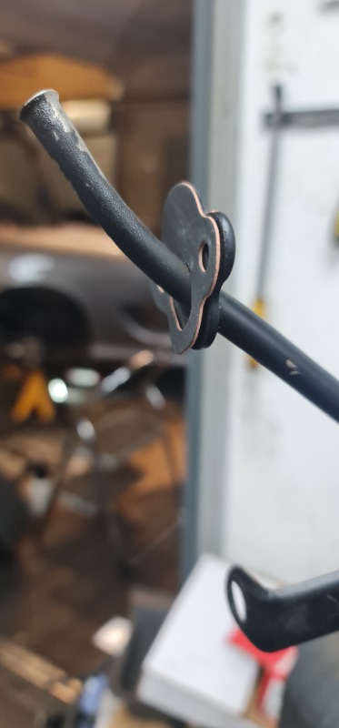

New plastic seal thingy that I didn't have looks like this:
Bit of a fiddly job, not much in the way of access up there. There's a 5mm allen bolt holding a bracket on to the dipstick tube which the guides I'd read hadn't mentioned. Unfortunately I cant fit a 2 - poster in my unit, so it's stands and jacks and rolling around on the floor swearing alot.

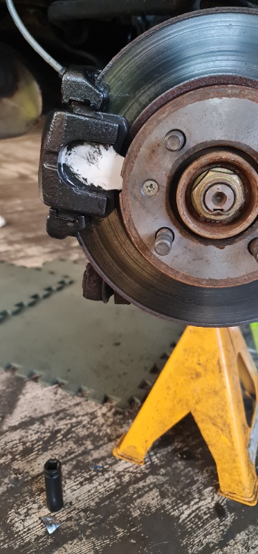

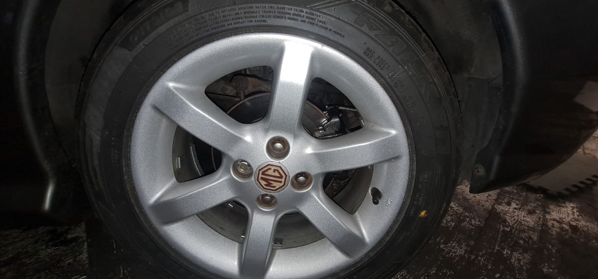

While th dipstick tube was drying I painted my rear calipers as the rear was in the air, and its raining tomorrow so they'll have time to dry off. Decided to try hammerite hammered black, which I thought would look decent -  it goes on thick and gives a really good finish, complementing X Power grey really well by being a bit darker and still having a bit of sparkle. Although it doesn't really look that good here, I'll get a better photo later.
Although this is a crap picture I think it suits the car well :-)
Checked rear wheels for play on ball joints etc and couldnt find any, which is reassuring :^)

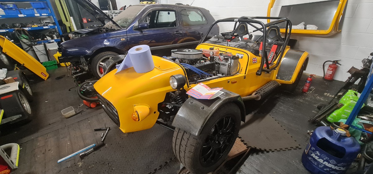

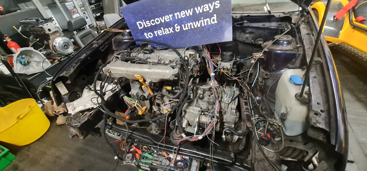

Did a bit on the mk3 Golf too, test fitting new calipers and 17"s, reminded myself what a thing it is and should really spend some time on that soon, and I helped my mate troubleshoot his V8 Westfield which keeps dropping oil pressure For No Reason and is now due its third set of bearings in 18 miles  as a result :'^(

What engine is powering that Westie? is that a RV8 I see in that pic?

It is indeed, a TVR head Rover 3.9 V8, doing about 230bhp. When it isn't dropping oil pressure and shredding big end and main bearings

My mate worked out, it had been hit on the sump a few too many times by previous owner and the oil pickup was down to about 1mm clearance as a result - it was dropping oil pressure on high revs when up to temp but fine on hot idle. Bit of a conundrum. Drilling a few holes in the oil pickup shroud appears to be the answer, as well as reinforcing the sump with some added plates as it's very low.
Hopefully this is the last set of bearings and oil, and then it'll be ready for a proper drive out. It sounds absolutely glorious though, not much chance of keeping up in the TF :-/

Can I ask about the “press insert” you illustrate & are you applying it to the dipstick?
I am unsure whether it is the correct item as it looks more like the receiver for an equaliser pipe in the inlet manifold.
Just check.
Posted 1 year 3 weeks ago #216431
As far as I could tell from other forum posts elsewhere, it's the same part. I don't know alot about these cars or engines but it does look alot like it? I'll see if I can find the forum posts I found this info on. Give me a few minutes
