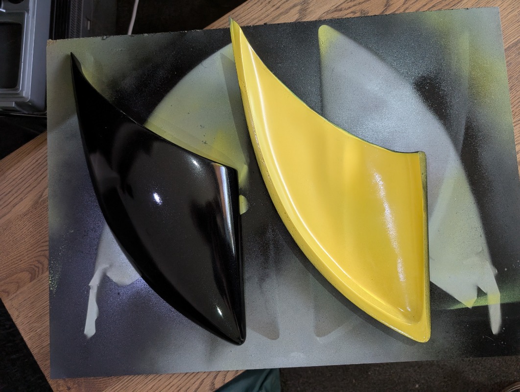

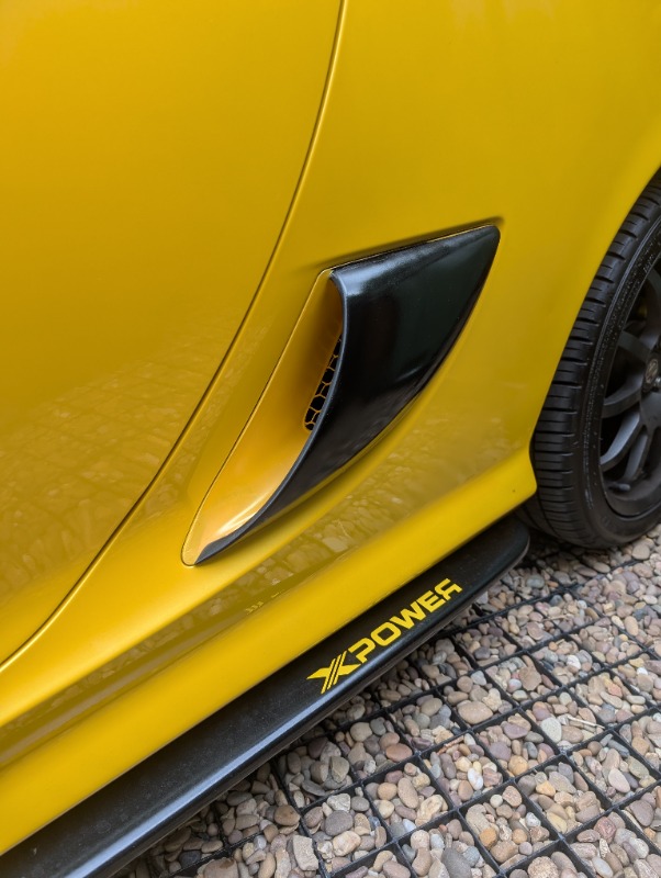

Another day, some more changes to the overall look of the car;
Picked up some Jakabi side scoops and painted them the obvious panther black on the outside, but chose to go sunspot on the inside wanting to create a sort of reflection chamber of that glorious yellow inside.

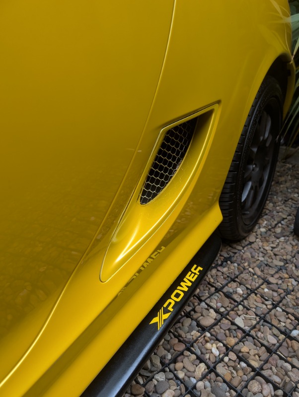

In order to avoid making the change irreversible i also bought a spare set of intakes (in green) which i then painted in sunspot (including the grills which i readhered as they were hanging half off) in order to preserve the originals so that going back to standard requires nothing more than a piece of masking tape and a big flat screwdriver.
and there we are.

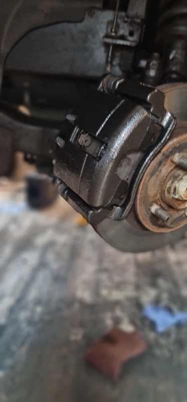

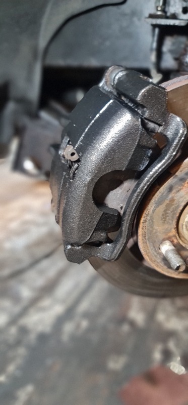

Finished painting calipers today as I cant take a car with only 2 rear calipers painted to a place called retro sports cars can I?
brake pipe joiner arrives tomorrow, hopefully, to replace the bias valve - research suggests that the brake pipes are a USA spec SAE single flare where they mate to the bias valve in the TF, rather than a bubble flare, so that's likely why some have had issues fitting bias valves to standard lines, as these will probably be fitted for bubble flares which are more common in Europe. I think. Maybe. Will report back.

Really quite impressed with the "Hammered black" hammerite finish, has a bit of texture that does a decent job of hiding any pitting and it's more like a very dark sparkly grey, one coat and it's decent enough for a quick on the car job until a proper caliper refurb. Plus, I've been given intel for a failed MOT, failed HG 160 model that's been sat in a garage nearby for 5 years, so I've sent enquiries as to availability... if that's cheap enough then it'll likely be a different set of calipers I'll be refurbishing next.
