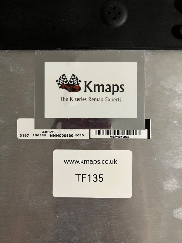

I'm away at the end of the week to my sons hotel but when I get back it's remap time!!
My car goes really well and I am dreading finding it has already been done.
There is the remnants of a 1inch square sticker on the outside of the Ecu but just the backing sticky stuff.
These are the stickers on the back of my ECU
Joe, it’s not only the 10-15 HP gained, it’s mostly about the torque improvement, I think

Posted 1 year 1 month ago #216105
Thanks Pedro!
It doesn't have the big stickers but it may have the remnants of the lower one. Will try have a better look today.
It's not documented anywhere in the paperwork but then again I won't be either!
It goes really well so if it's not done I am going to be happy.
