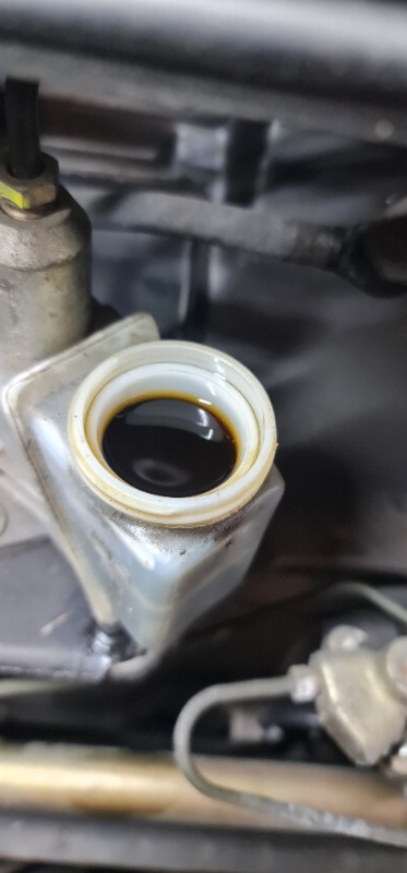

Anyone have any idea when my clutch fluid is ready for renewal? :-/
I didn't have time to full bleed the system, so kept filling and draining the reservoir until it looked less like coffee and more like DOT - took about half a liter of draining with a syringe and then filling over 20 minutes... is this normal or should I expect to have to change slave seals soon?
This is the problem with most garages, they're parts fitters and a "service" is an oil change, if you're lucky...
