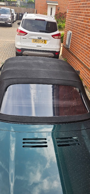

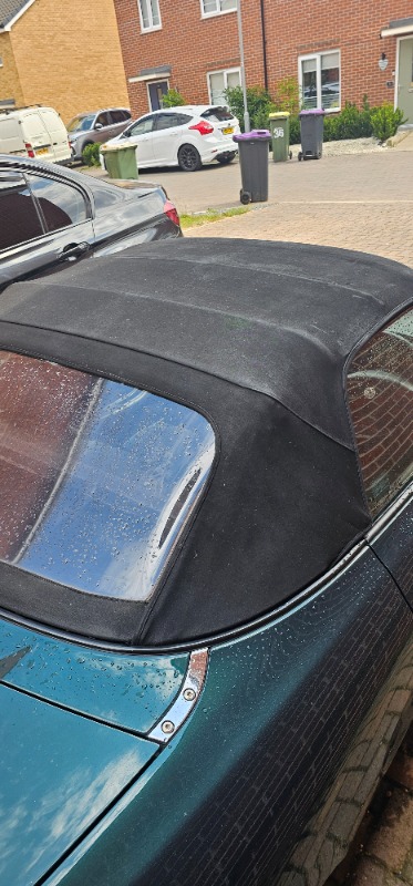

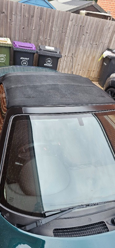

Hood was looking a little tired so over the past couple of days i've been cleaning and restoring
before after a good scrub
During using the colour restorer
after the sealant applied
pictures don't do it justice
I've done an AP but put pics in wrong order ha ha

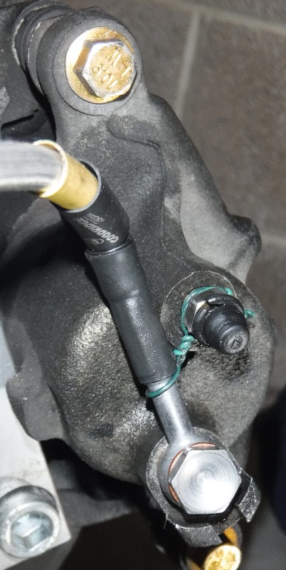

Joe_Pineapples:
You said: "Ordererd goodridge hoses,"
2 cautionary tales you should think about:

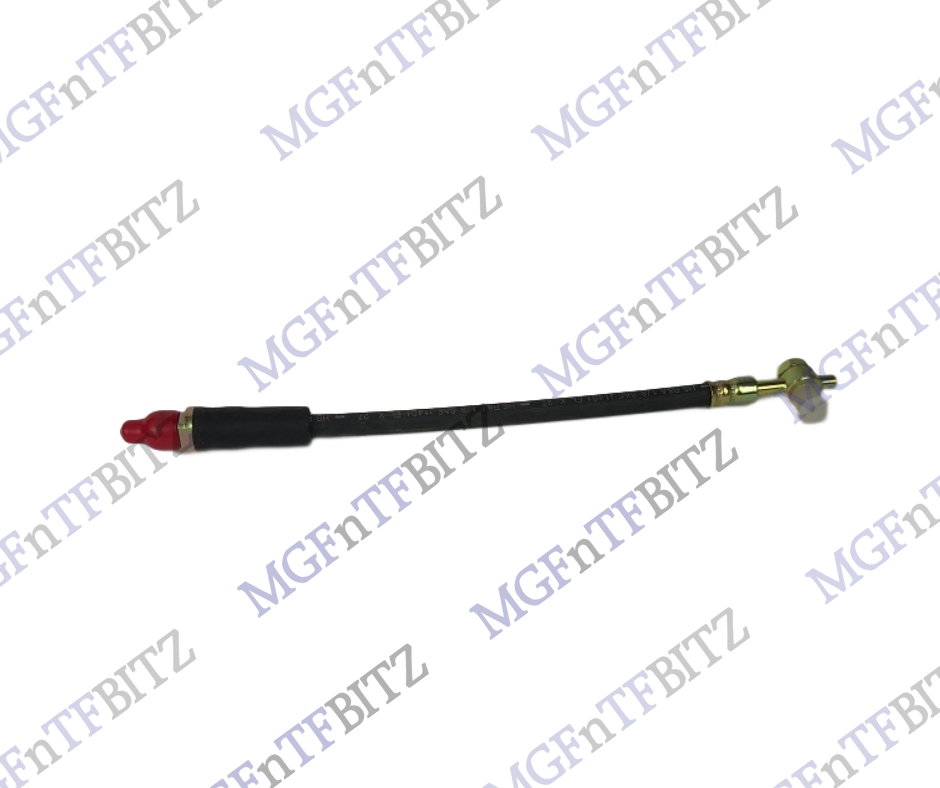

I also bought & fitted Goodridge braided hoses.  My local garage fitted them before the MOT, because I do not possess a pressure or vacuum bleed kit and O.K., I was feeling lazy!
They said they were not happy about the FRONT hoses, and actually took them off and re-fitted my old rubber hoses.  They said that the front hoses should have an anti-rotation feature, as per the OEM hoses:
The relevant "anti-rotation" feature is on the extreme right in this picture.
I overcame this deficiency, using twisted, plastic-coated wire to provide a restraint.
I am not convinced that this is really necessary, but without this, on one side, as the banjo nut is tightened, the braided hose tends to move AWAY from the bleed nipple, which would leave the hose under tension at some combinations of full-lock and full suspension travel.  NOT GOOD!
The other point which worried me enough to change all the stainless steel banjo bolts to these:

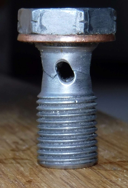

The reason being that when I tried using the St Steel bolts this happened:
And before anyone asks, I did tighten it with a good torque wrench, which I checked immediately with a luggage weighing scale applied at 12" from the axis. (makes the maths easy to check a ft.lb torque)
I believe that st. steel has far lower tensile strength than high tensile steel.  The St steel bolt design is, IMO, a poor design because the fluid transfer hole is drilled through, rather than being a single sided hole as in the both the OEM bolts I removed, AND the new bolts pictured above.  The through hole deprives the critical area, Where it failed, of twice the cross-section area, thus greatly increasing the tensile and shear stresses in that zone.
It is possible that the garage who used those same bolts in their initial fitting of the front hoses, may have overtightened the bolts, but we will never know at what point those bolts started to yield. it was still intact when I tried to use it, but only just.
The following user(s) said Thank You: TA22GT, Joe_Pineapples
Posted 1 year 1 month ago #215255
This is a valid point, I have some OEM stainless unions which have by on & off & torqued to the appropriate value; I will look at them. The other point with the fancy hoses is some are too short. If you look at the picture of the union trussed up with wire you will notice that 180* from the exit of the banjo, there is a gap in the casting. That is to fix the position of the hose to prevent rotation; some pipes are too short to be able to dress the hose correctly through that gap & up to the body mounting connector.
