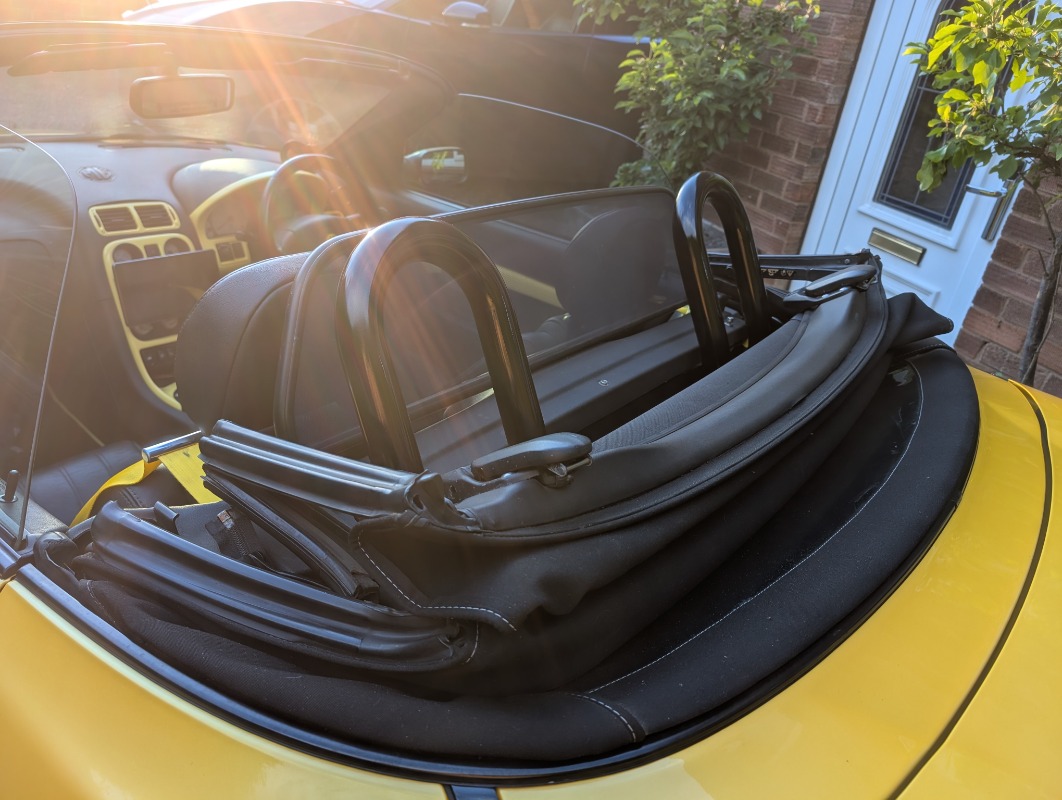

Yesterday i finally got round to painting my rollover hoops, someone did say MG did actually make these ones in other colours but i've only ever seen them in stainless steel/chrome effect, which as i'd "deleted" the rest of my chrome just stood out too much, so here they are, (of course in Ford Panther Black)

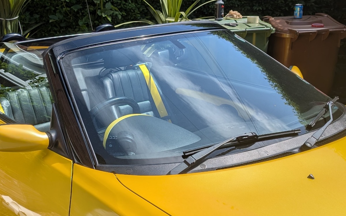

Then after yesterdays voting i decided to have a go at wrapping the windscreen surround, there's a few bubbles i couldn't quite get out here and there, but all in all it looks decent, maybe at some point i'll get a professional to do it now that i know it looks good.

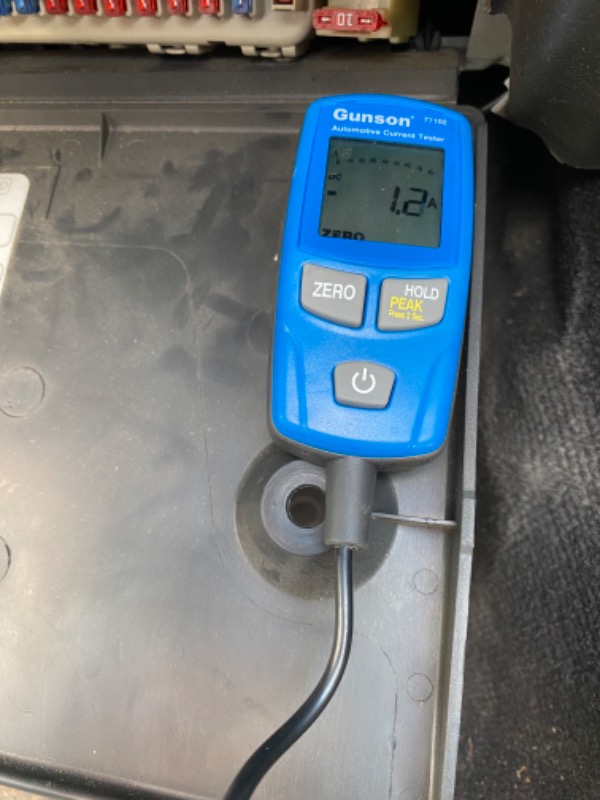

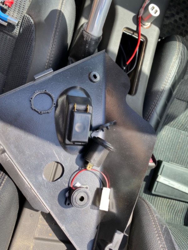

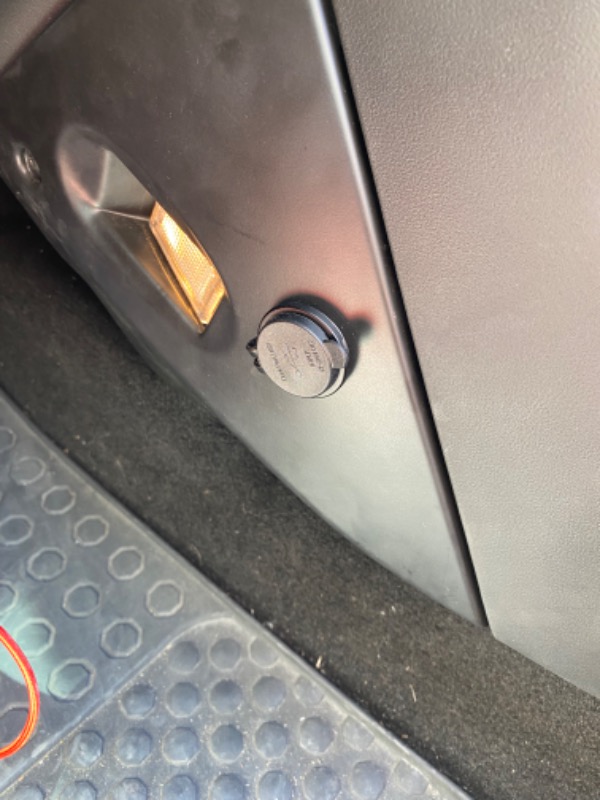

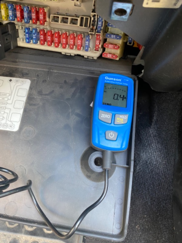

Well, not quite in the same league as KC’a work, but got sick of USB wires being too near the gears and handbrake. So mounted a dual high charging USB
socket in the passenger footwell.
Sacrificed the original cig lighter but can be resurrected if needs be. Soldered the wiring to the cig lighter pair and covered the joints with heat shrink. The wiring loom to the socket has an inline fuse of 5A, the 0.4A is my iPhone charging, the 1.2A is mine and wifes Huawei P20(?)
The round thing is the buzzer for the low coolant alarm. Works perfectly, but will see how it performs in the winter as it’s permanently fed and the blue LED is lit. 🤷‍♂️
