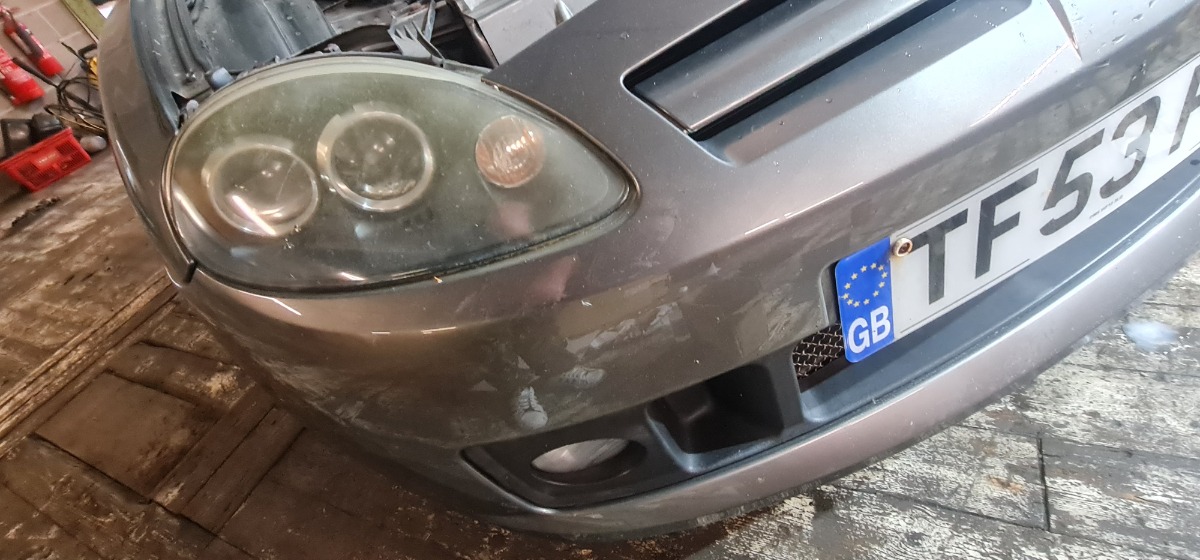

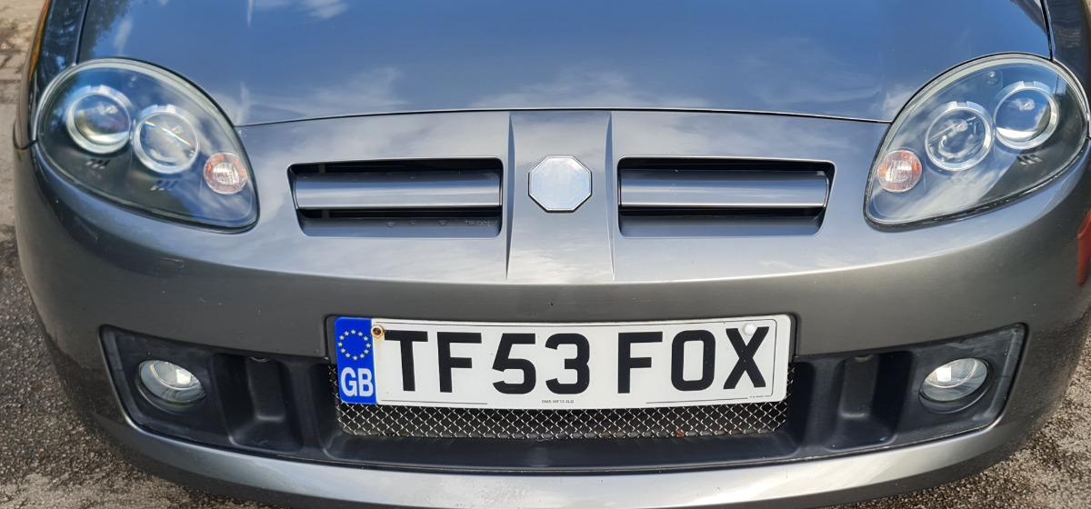

In slightly less contentious enhancements, the previous MOT had indicated an advisory for the dulled headlights. A year on they were looking pretty poor indeed, now it's mine I thought I better sort them out. Looking pretty good now, or at least not embarrassing anymore.
Fixed the broken passenger side washer jet, which had cracked it's joining piece. Some quality plastics on these, aren't there :-)

Looking much better mate!

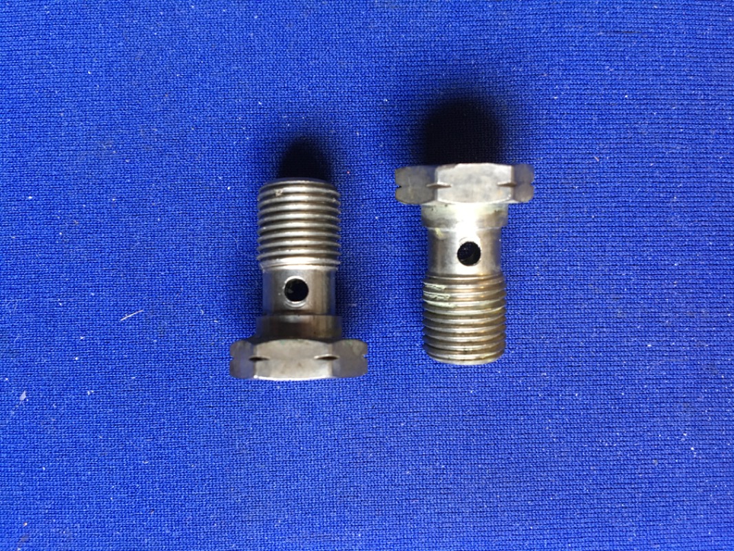

  I’ll put a picture of a couple of my stainless banjo bolts. These have been knocking about for ages & been on & off a number of times.
If you were to put one of each next to each other, I would be inclined to identify one as lead!

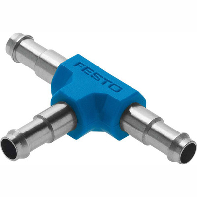

Festo make very good metal T and Y pieces in a range of sizes.
You'll find them at any friendly local industrial supply house,  amongst the pneumatic fittings. I've No idea what they cost as these sorts of things have a bad habit of falling into my tool box at work!
