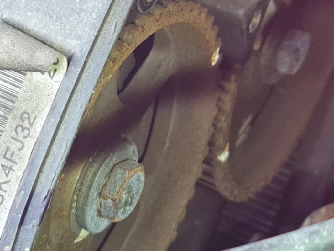

After getting our latest member through it's mot (reminder to self don't believe a word the previous owner said..)
Anyway as the car has been in storage for a few years I wanted to give it a good service before the summer finally arrives.
I'm really glad that I was going to change the cam belt but it looks like the previous owner gave me a start by removing the covers..
Posted 1 year 4 months ago #211921
Well done on the MOT! It always takes a weight off my mind when I get that little slip of paper.
I'm sure those sprockets will clean up but why expose them like that and it means finding covers now. Good luck with the belt change.
