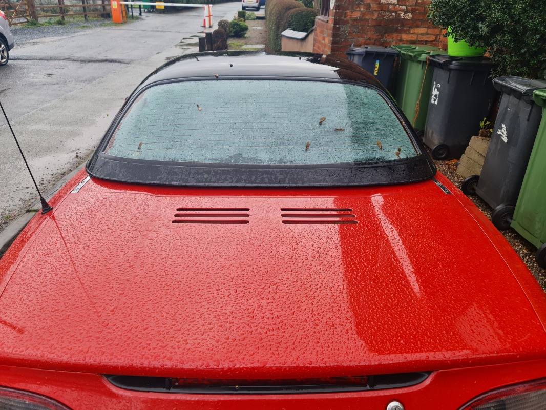

I've fixed the heated rear screen on the TF hardtop at last as the original connection pads had been missing when i got the car.
Several times I attempted to stick some brass pads with lucar terminals to the HRW'S conductive foil with a special conductive glue but each time they came off despite following the instructions and applying heat whilst drying.
In the end i came to the conclusion the conductive glue may well be nicely conductive but it wasnt actually a strong enough glue to keep the small metal pad and its length of wire stuck properly to the screen.
I then used JB Weld to glue the pads to the foil sections on the screen, trimming off the excess glue. Once hardenned i then went back in with the conductive glue but used it to cover the pad and area of foil immediately around it. I repeated this twice more to make sure of good conductivity. This has done the trick and the conductive glue around the edges and over the top of the pads has worked better than worrying about having an actual conductive bond between it and the foil.

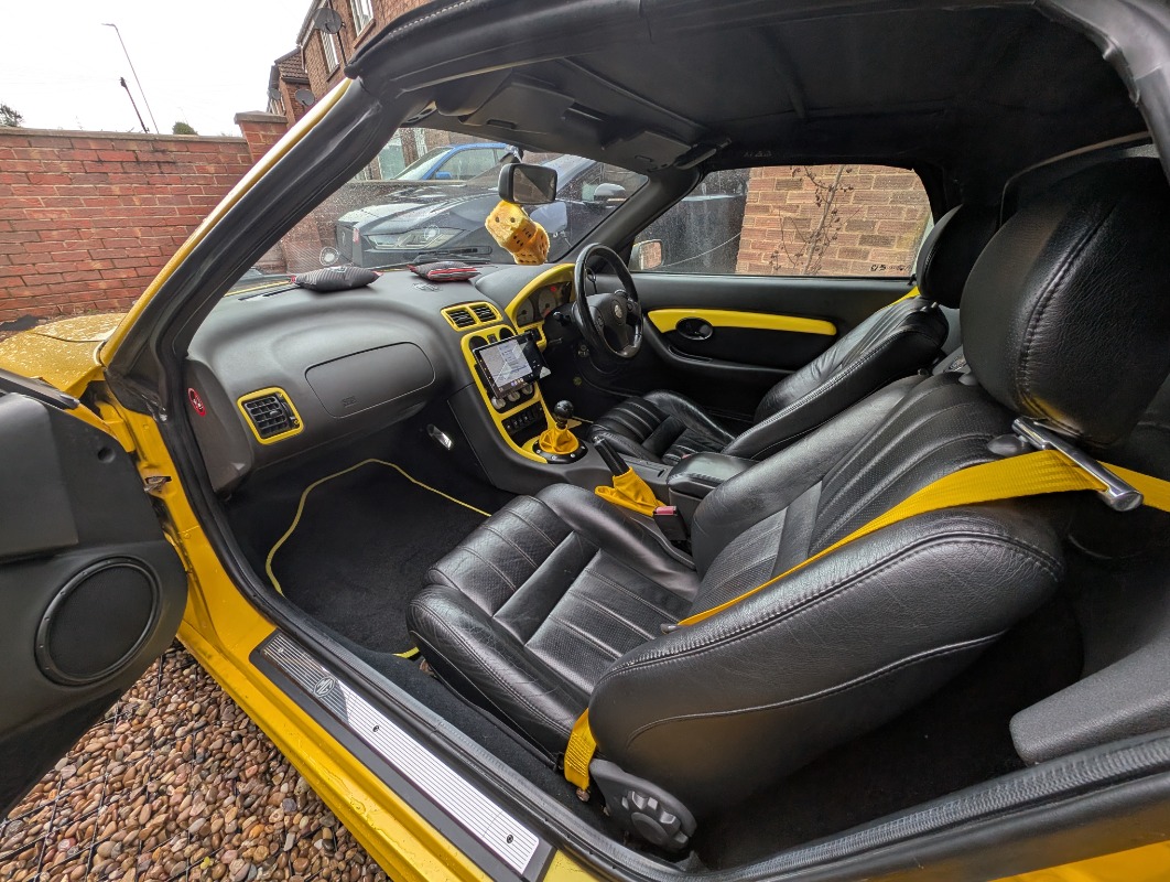

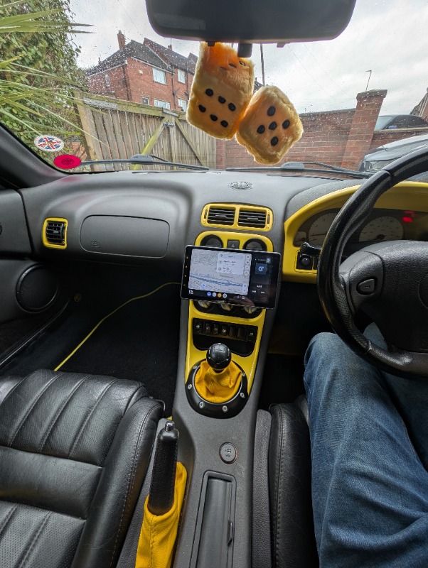

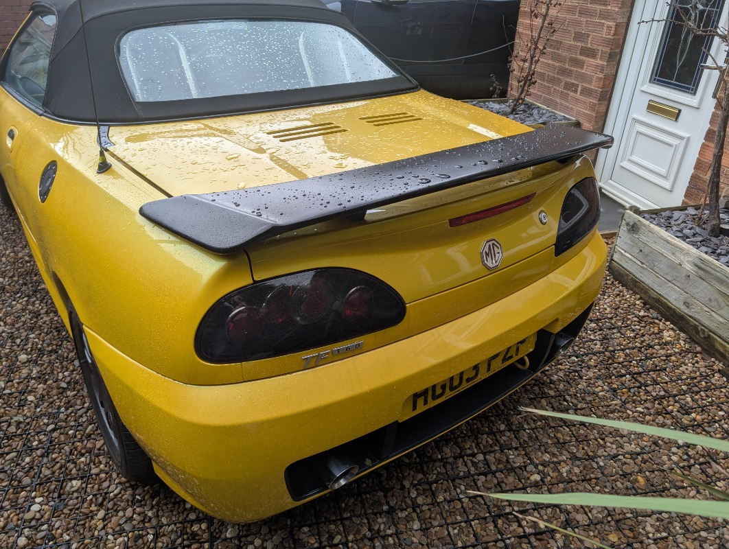

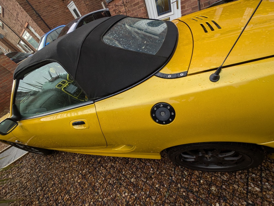

I had a really productive week to be honest! I finally got round to fitting the trophy spoiler I picked up after sanding, and repainting it (bonus points if you know the shade of black I used 🤣)  and I think it looks pretty great to be fair;
I also did some more work on increasing the amount of yellow in the interior, not to everyone's taste I'm sure but don't worry I have a box full of unpainted parts if I ever wanted to go back to standard.
You'll also note I've been deleting the chrome as I go, the door handles inside and out are wrapped, the gear knob and surround are now black, the chrome lighter has been replaced with a simple USB charger and the chrome ashtray has been swapped for a black one.
That chrome delete continues on the outside with the rear deck trim, fuel cap and door handles all now wrapped in black, and of course the Ultralight wheels I fitted the other week:
It's not all been cosmetic though, I also fitted Bruce's low coolant alarm kit and did some lubricating of the throttle pedal, though I'm now convinced it needs to come out and have the bushes & pivot dealt with but that's a job for another day.
Last Edit:1 year 4 months ago by KidCreation
Last edit: 1 year 4 months ago by KidCreation. Reason: Spelling mistakes
