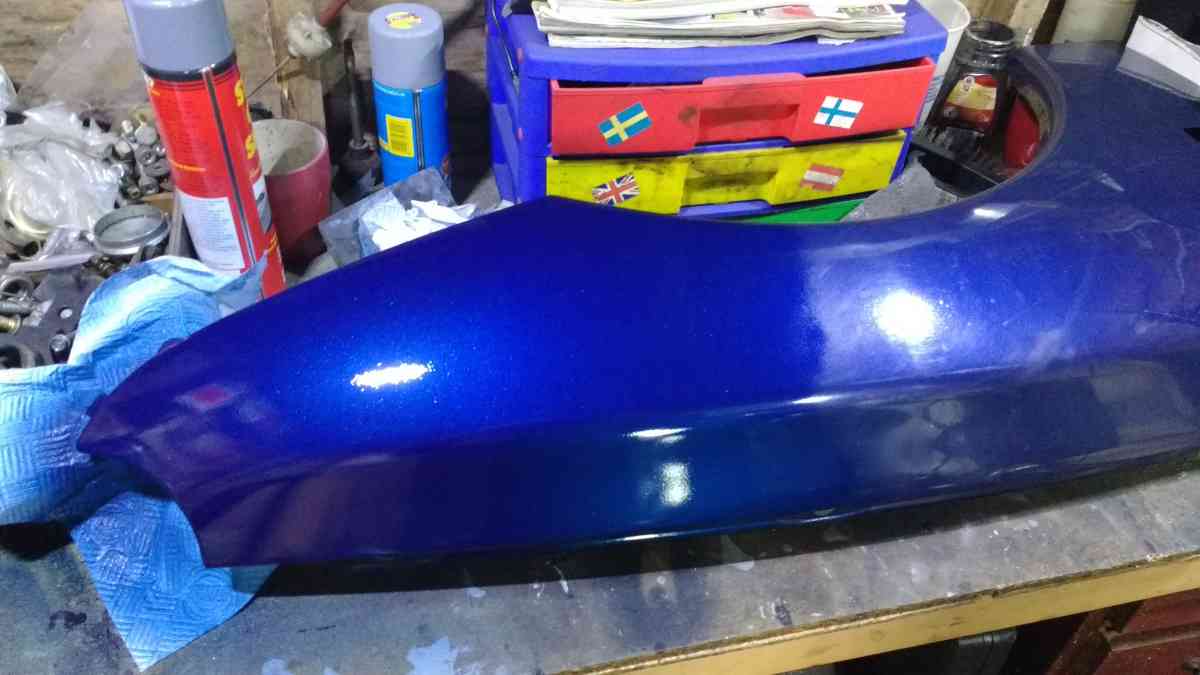

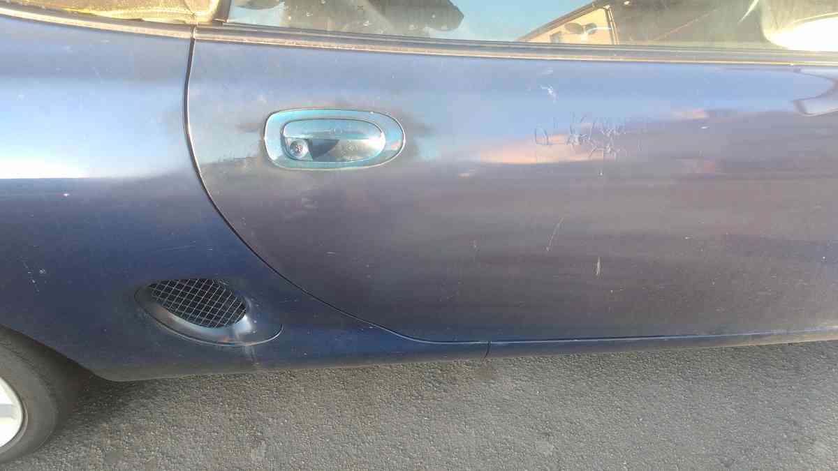

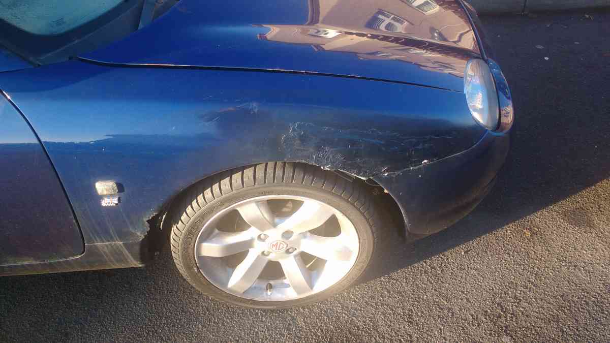

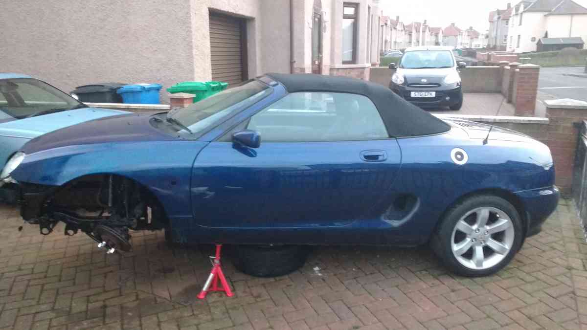

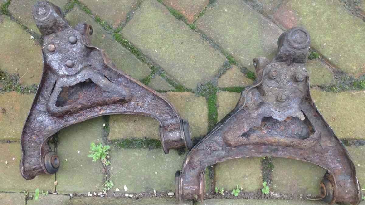

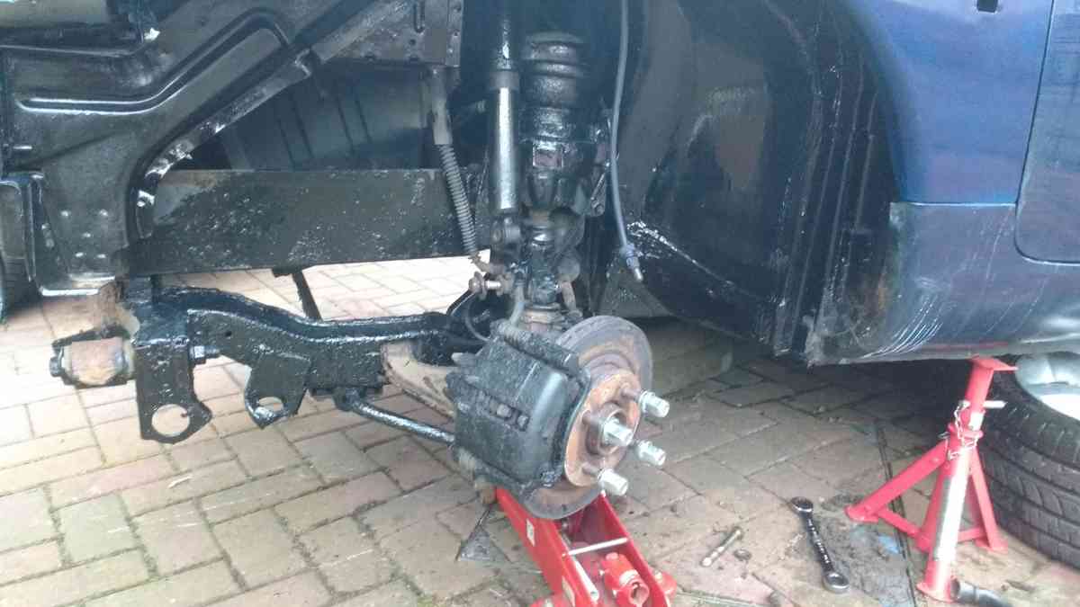

After
recently buying what may be the world's worst MGF still with an mot he's is the list of work done in the past few weeks....
2 replacement wings
2 replacement wishbones
3 drilled and tapped subframe mount holes
Nearside rear track control arm replacement
Replacement hood
New bonnet cable
Replacement interior mirror and mount and wiring
Replacement mike Satur wiper linkage
New wiper blades
New alternator belt
Repairs temp gauge wiring
2 new rear abs sensors
Repair airbag wiring
2 new rear tyres
New front discs and pads
Unstick all callipers
Repair stuck handbrake cables
More to go... And it'll still be a tatty VVc...
