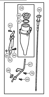

These brackets all tend to suffer from harmonic vibrations and end up cracking.
When I had to replace mine I tightly wedged some rubber tube into the fold, in the hope that this would dampen the vibration.........so far so good.
Oh...and the washers would've been used to replace a lost spacer.

Is there supposed to be a spacer? I've consulted the workshop manual but couldn't find a drawing showing how the bracket is supposed to attach. Mine's a MEMS3 MPi with the plastic inlet manifold. - grateful if someone with a similar engine can check theirs.

OK, answered my own question (see above). There is indeed supposed to be a spacer:
65 in the drawing is part number LQZ100050.
I wonder how deep it is?

Just ordered the spacer LQZ100050 and the genuine screw FS108255M from good old Rimmers. Needless to say the P&P exceeds the cost of the items but I might as well do it properly.

Isn't that where the red one is welded which shouldn't be a problem on the new one as it is a single piece, folded and bent.

No, I don't think so. The plate that fits to the manifold has been welded on to the rest of the bracket. You can see where the metal is overlapped. Doomed to fail but it's also cracked across the metal. The replacement is s/s is one piece and a heavier guage so hopefully with give years of service.

Nah it was probably cobbled up by welding bits from 2 broken ones, over lapped in the hope it would be stronger, that cocky shit weld is in no way professional.
(so called as it resembles cockatoo shit)
Add to that the red paint is a bit of a giveaway, the factory painted them black.
And before someone suggests that the red was some attempt at customising, I ask: Have any of the other normally black bits been painted red? No?...
I rest my case Milud
The one on my car had a cocky shit weld repair, that had of course cracked through as the weld made the metal brittle.
If your gonna try and fix one of these, then the crack needs a small hole at the end of the crack to relive it, then the line of the crack needs to have a chamfer ground along the length and be oxy-welded even then it will eventually fail unless the harmonic vibrations are somehow dampened.
Just welding up the crack using arc or mig welding will only fail again in a very short time.
