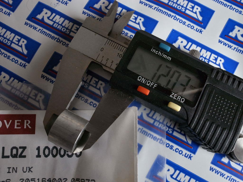

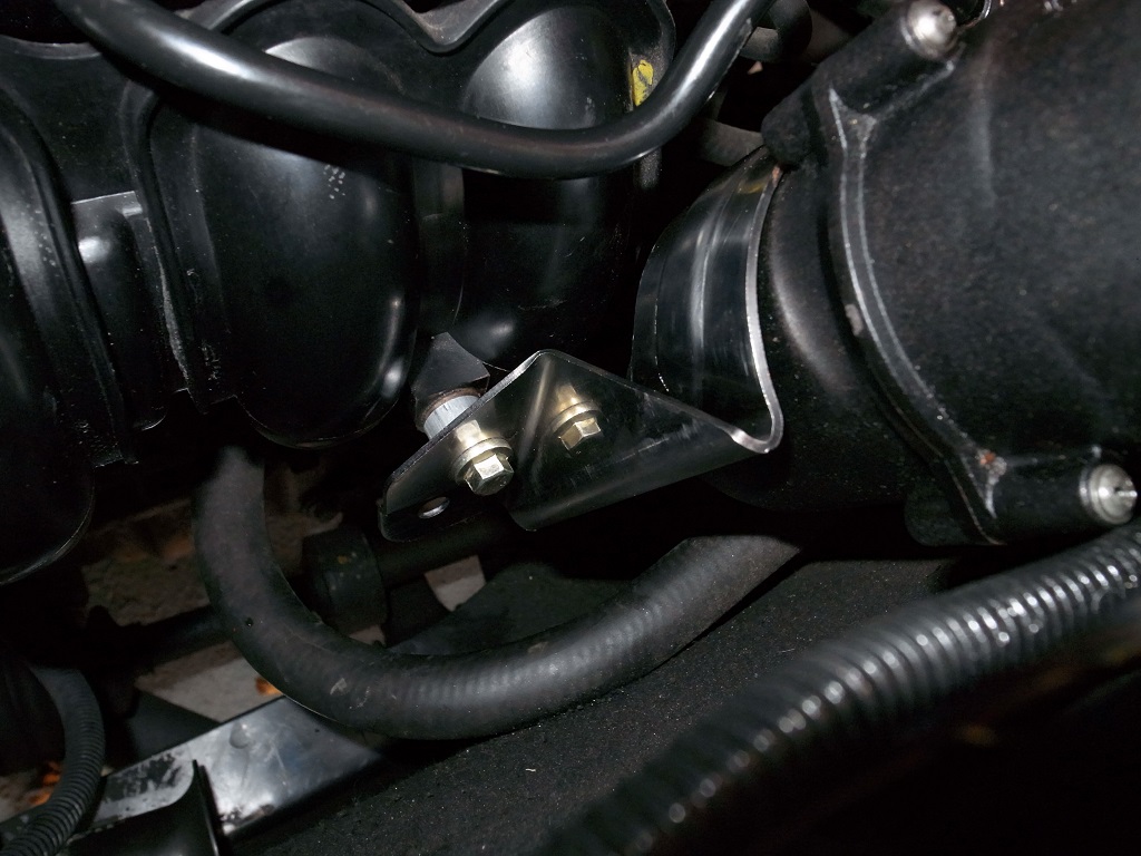

Blow-in wrote: Just ordered the spacer LQZ100050 and the genuine screw FS108255M from good old Rimmers. Needless to say the P&P exceeds the cost of the items but I might as well do it properly.
Richard
The bits arrived from Rimmer's today.
For the record the spacer is 12mm long (9mm internal diameter). The screw is M8, 25 mm long and with a 10mm hex head and comes preloaded with a locking compound. The torque required is 10 nm or about 7.4 ft lbs.
As fitted:
Richard
