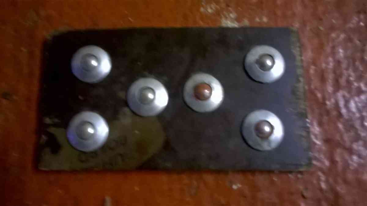

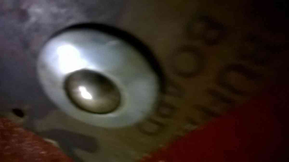

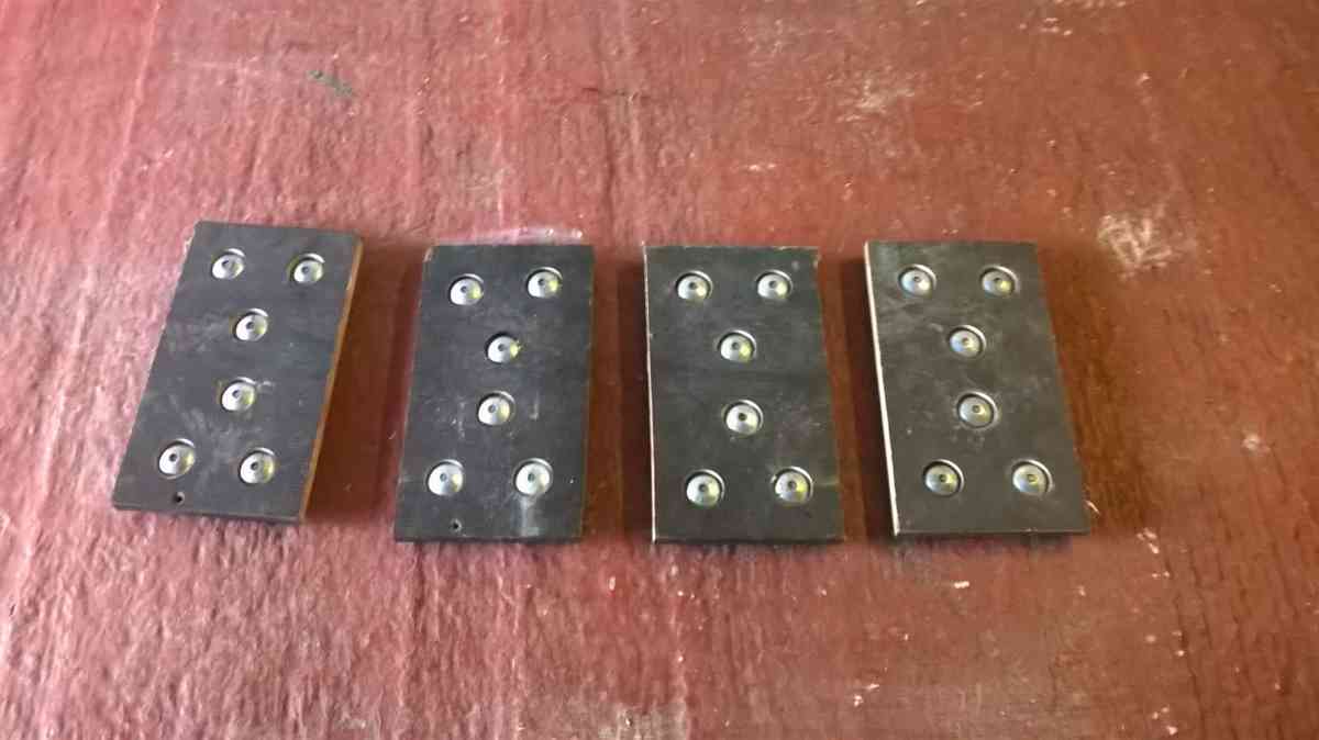

well this week i made some skates so me and the tf can go skating......mot shortly and ive replaced a rear upper balljoint and have one more to do.......maximum space in the garage is a must have.........so moving the tf has close to the wall has i can gives me maximum space in the garage........id obtained 24 ball bearings in casings some years ago which i used for moving heavy benches in the workshop and then had some skates in mind......this skate is upside down to show the rolling side of the ball bearings
i cut some thick laminated plywood into equal size pieces and cut the holes for the bearing cases....they were a nice tight fit........6 bearings on each skate
it didnt take long to cut the holes with a hole cutter in a pedestal drill....finnally four were made and i was itching to try them out... :woowoo:
they are unfinished at this stage....i am going to add small pieces of timber at both ends of the skate to cusion the wheel so it doesnt roll off......

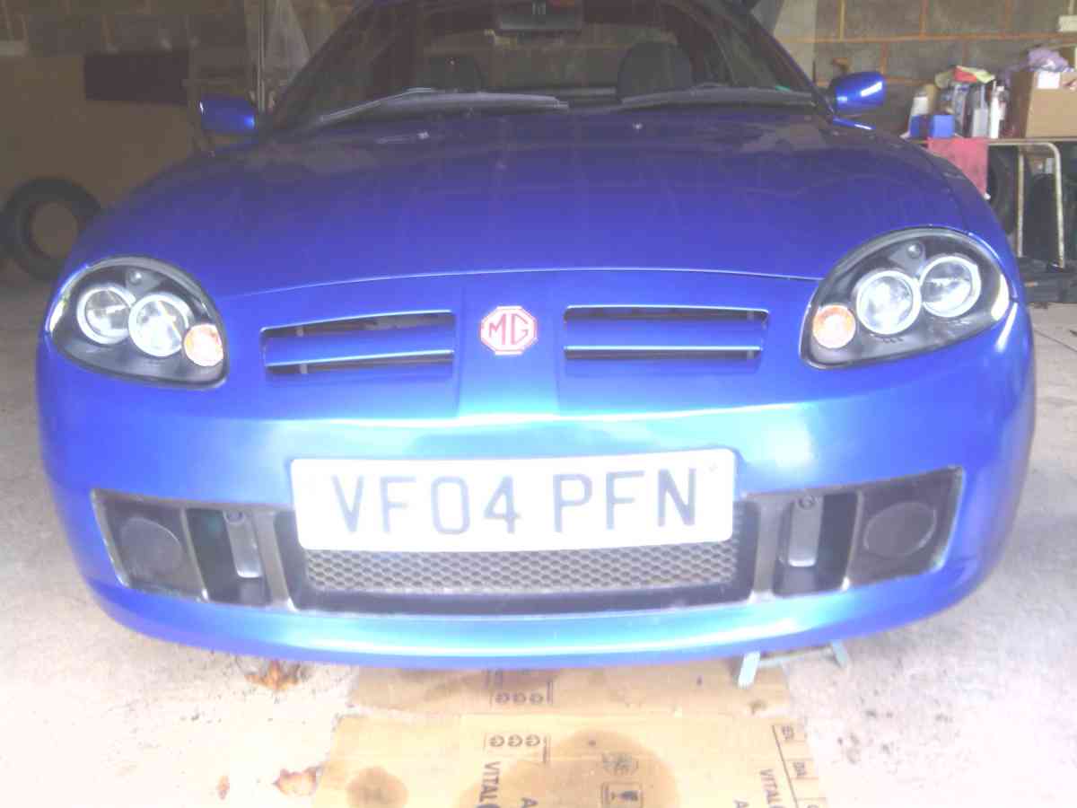

so jacking the car and placing on the skates doesnt take long

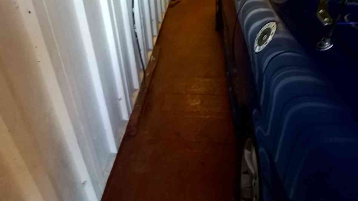

and once in place i can push the car closer to the wall....handy for the hybernation period......all in all ive gained about 2ft more space using the skates which is a lot when you see the extra space ......picture below is before the skates used

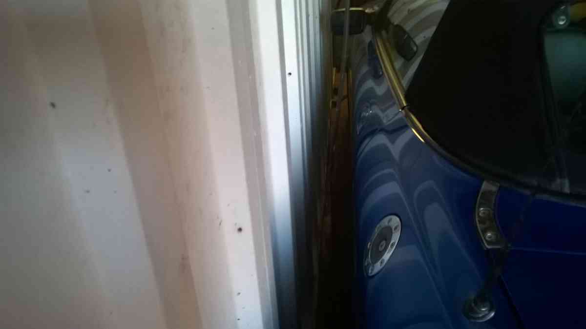

and this picture is with the skates fitted and pushed to the wall......i plan to put a permanent buffer to stop the car touching the wall........
