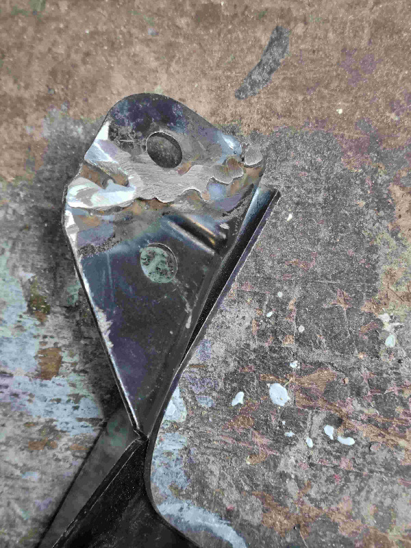

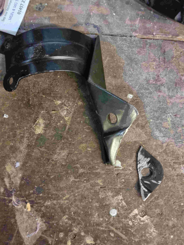

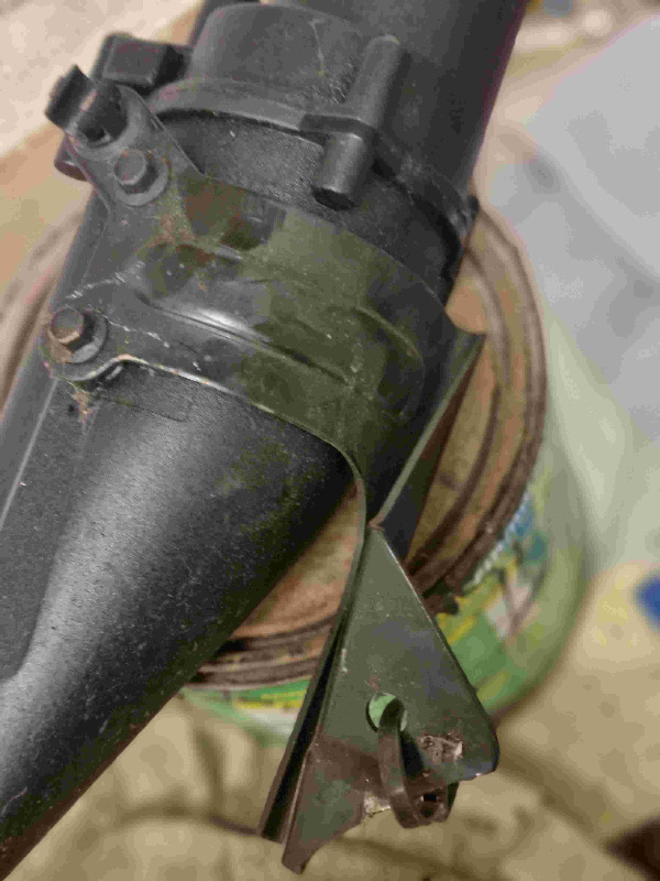

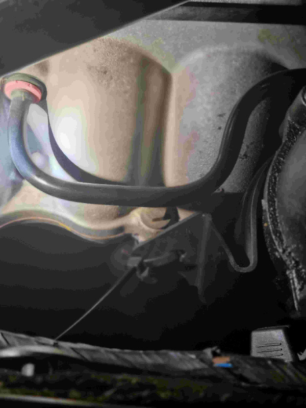

I repaired the mounting for the remote oil filler/ dipstick tube assembly on my 135. This never looked quite right and didnt seem very solidly fixed so the other day I took a closer look.
The way the filler assembly is supported by the manifold differs according to the type of inlet manifold. Id been used to plastic manifolds (on a Mk1 F 120 and Mk1 TF 115) where the oil filler assembly bolts on a simple bracket to the right. The early metal VVC manifold has the same arrangement i think.
The 135 though relies on a more complex shaped bracket that curves around the assembly and bolts to the manifold on the left. Except on mine this was just held on by a cable tie.
Once the cable tie was off and the assembly lifted away this revealed the manifold end of the bracket had sheared off leaving the bottom part still bolted to the manifold.
Given that the thing had snapped you'd be forgiven for thinking this was a plastic bracket but I was surprised to find it was mild steel. There was no sign of bending or metal fatigued, it had mysteriously just sheared.
Now thats a bad thing in one way as I've no idea how a steel bracket supporting something as light as an oil filler would ever have sheared but it's actually rather good because fixing this became just a 5 minute Mig welding job.
Using a couple of mole wrenches to hold the broken halves together I cleaned off the paint and then welded it from both sides. No prizes for neatness but it doesnt stick out like a sore thumb after grinding and primer.

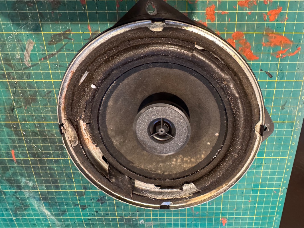

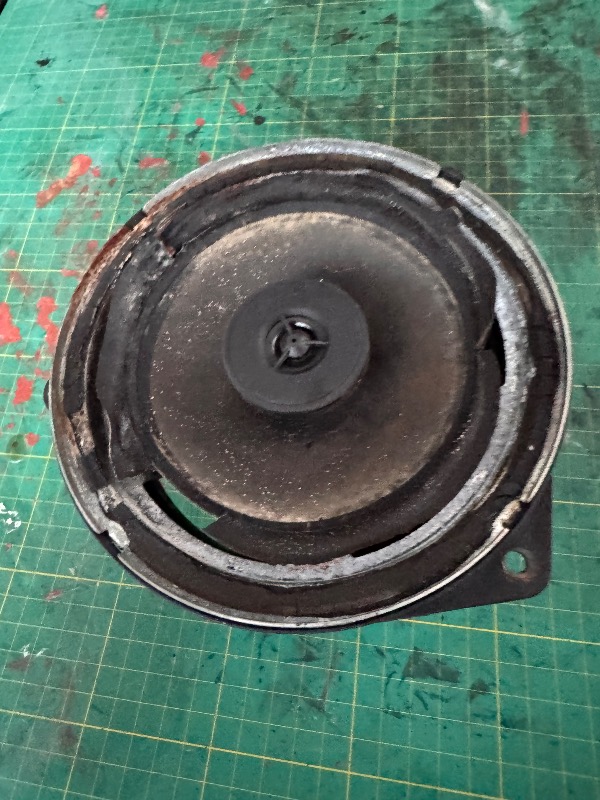

    As it’s so cold, I thought I would do an inside job and decided to remove the door speakers as I had a pair of Pioneer speakers left over from my camper van build.
i think I got to the door speakers in the nick of time.
Posted 7 months 2 weeks ago #220681
Blimey I bet those speakers were sounding a bit ropey with so much of the cones surround having disintegrated.
If you happen to find the T bar speakers are in a similar state as that then give me a shout as I have a good original pair of rears you can have for the cost of postage only

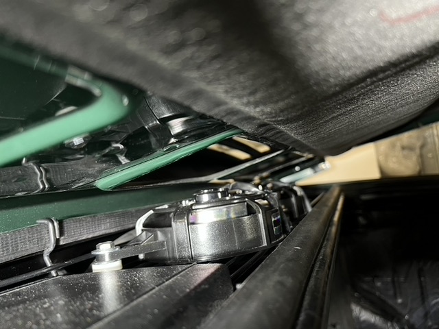

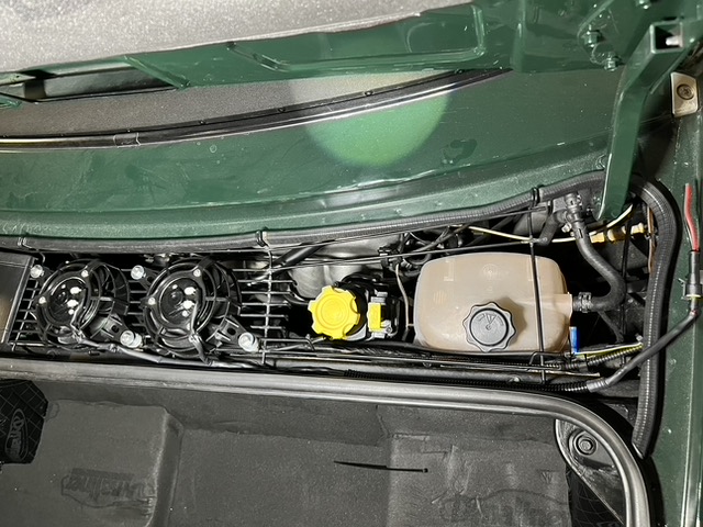

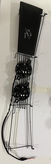

Following Cobber´s and AP´s path, fitted two 15w fans to the TF´s engine grille. They will be connected to the right lateral vent fan and will come off with it.
As predicted, they hit the more anterior part of the boot lid ventilation "hole". But I intend to widen it and improve the turbulent air flow by obliterating the current nooks and removing the ledges. Of course the boundaries will have to be reinforced.
But that will happen, hopefully, next spring.
