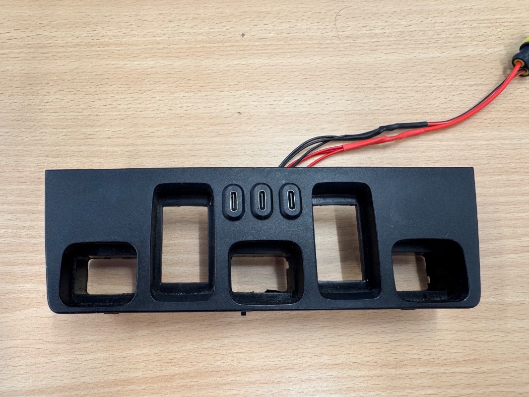

I have added three USB-C ports to my dash, next onto the wiring.

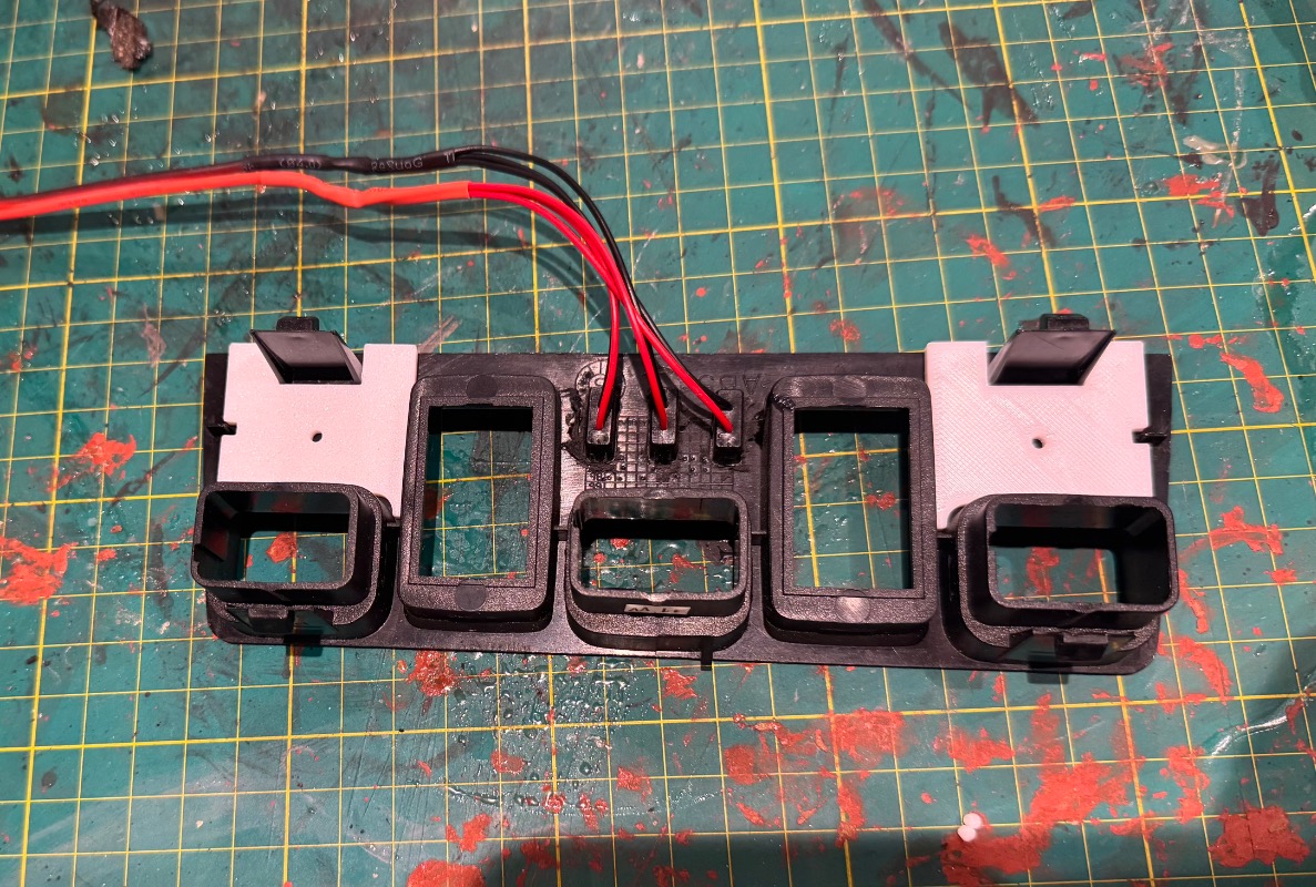

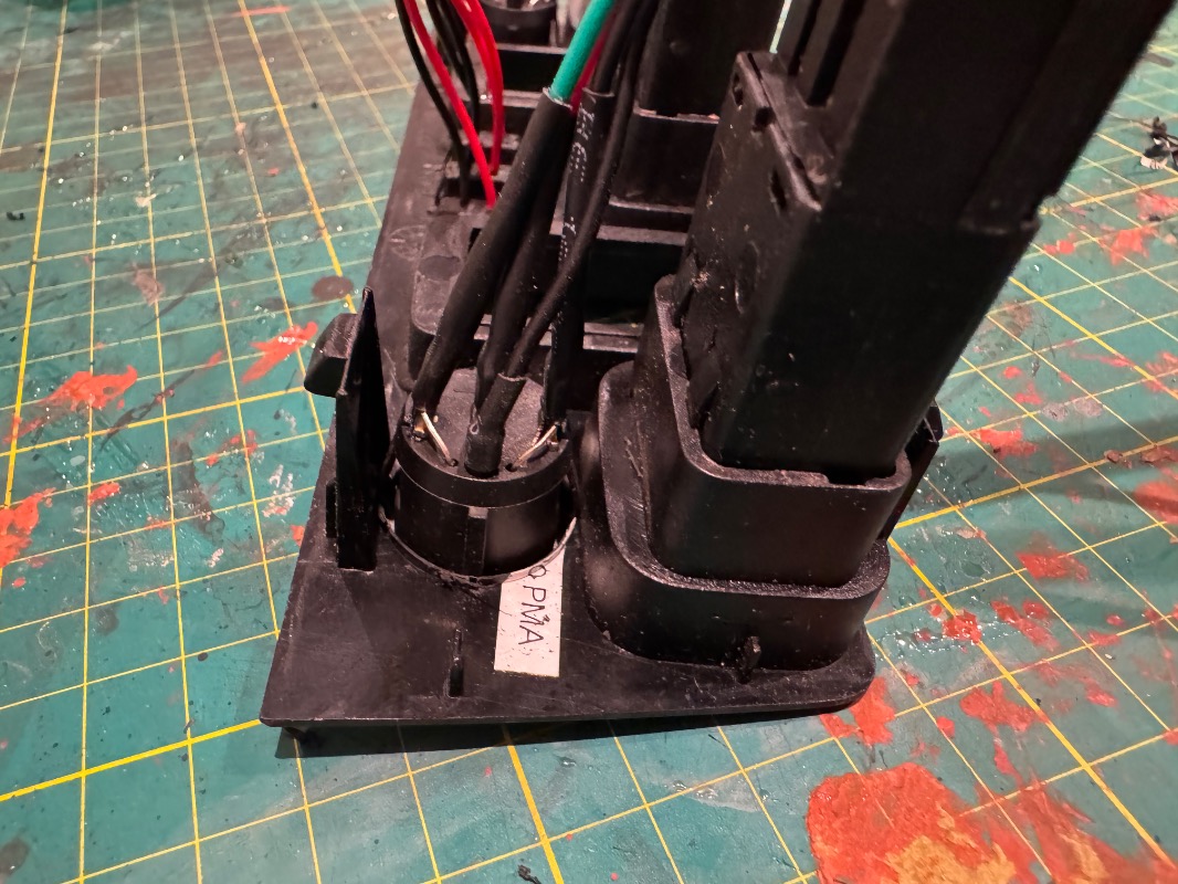

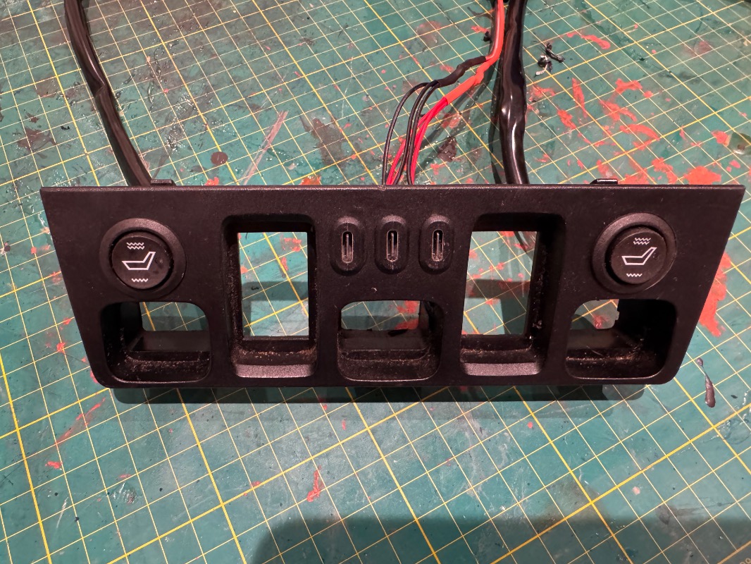

Raining today, so couldn’t do much, so I decided  to fit the heated seat switches, which I have been putting off as there is not a lot of wiggle room.
i printed off a couple of drill jigs to try and make sure I got the holes in the right place.
Drilled a pilot hole and then slowly enlarged the holes up to the final size, and filed the key way with a needle file.
