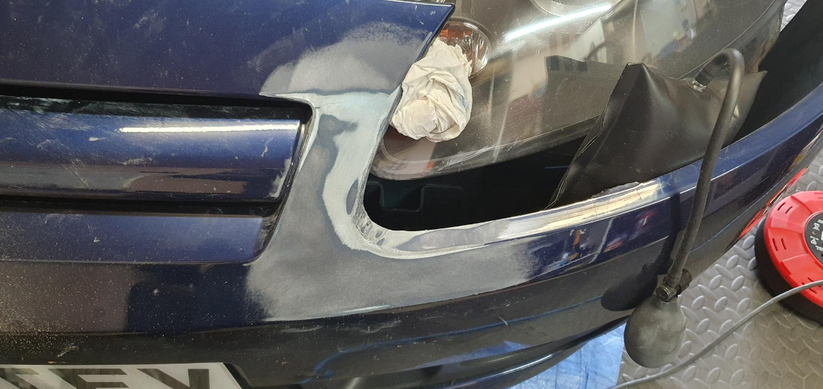

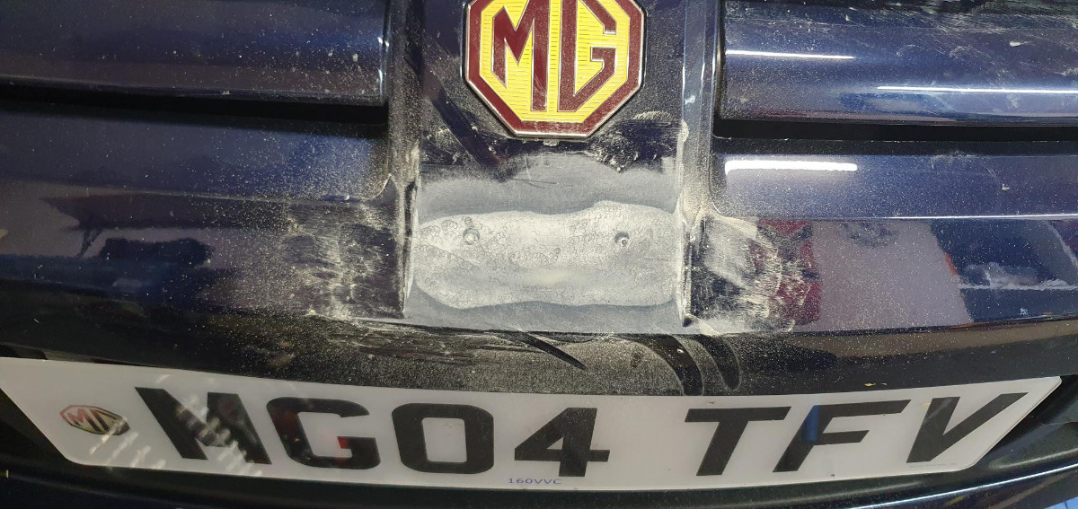

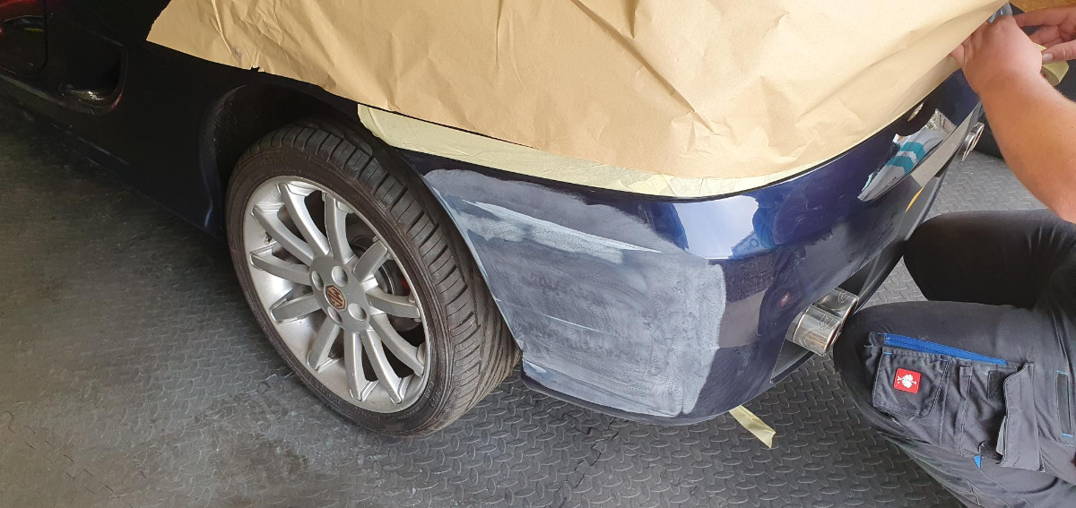

 More importantly...the chips away guy is here now to deal with the bumpers and getting busy ....
Before -
During -
Last Edit:9 months 1 week ago by Dan1971
Last edit: 9 months 1 week ago by Cobber.

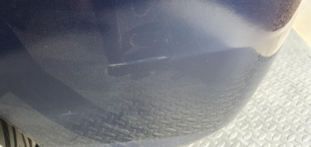

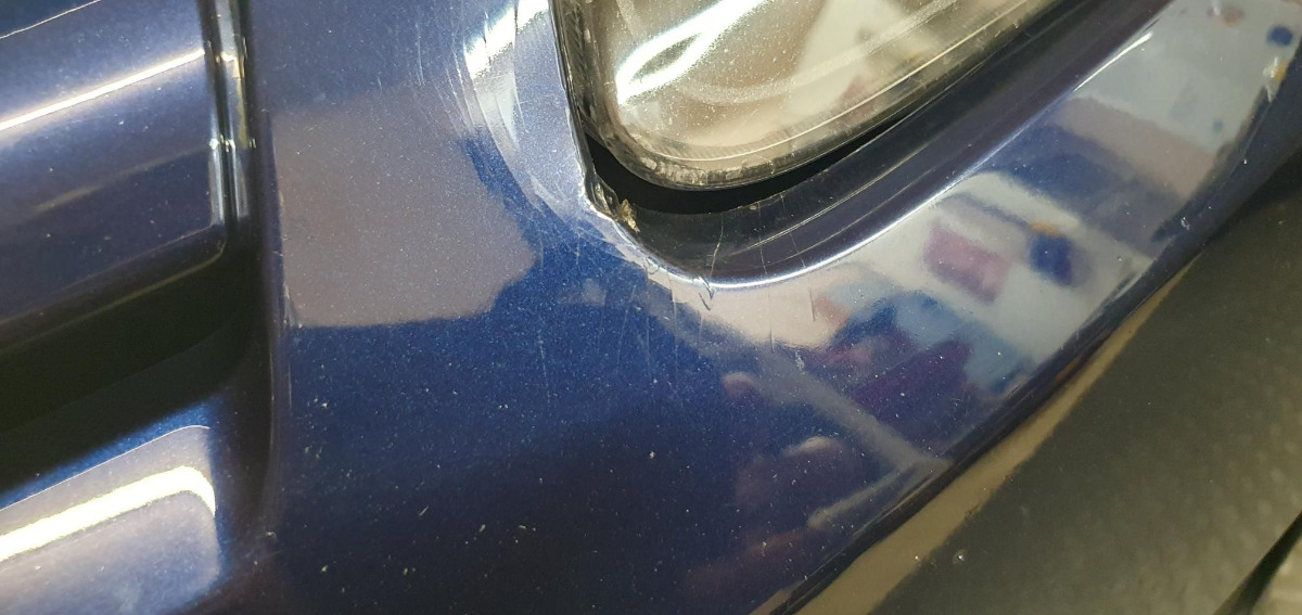

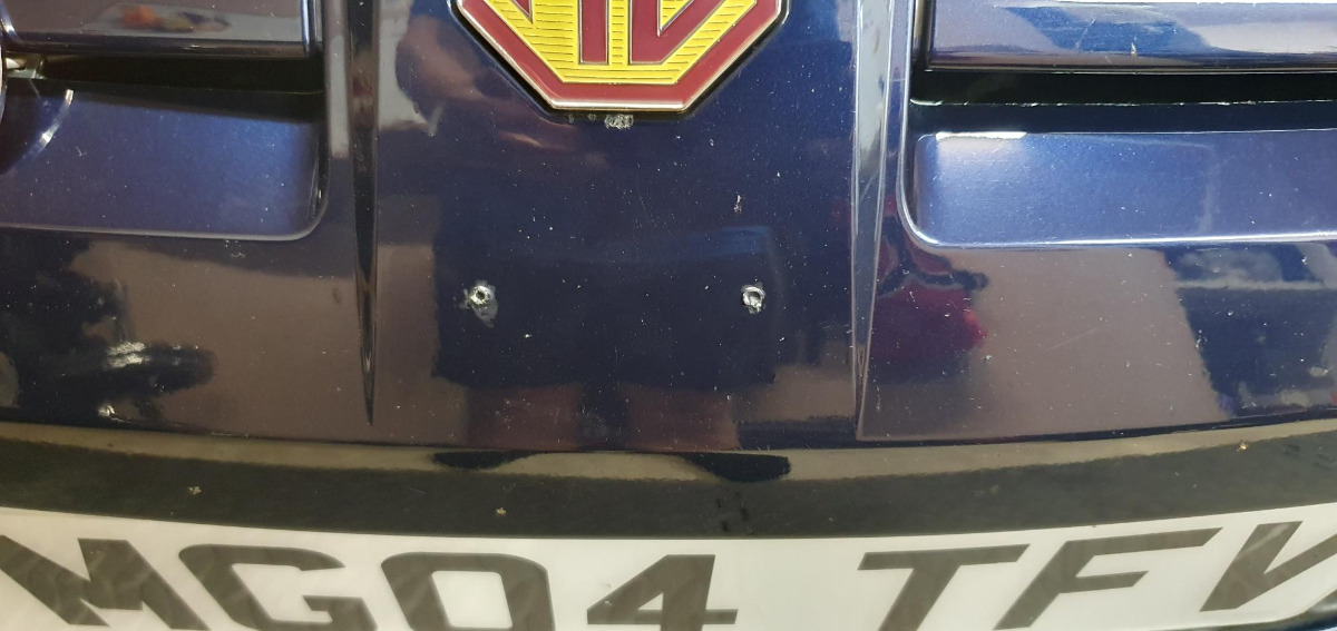

Posted 9 months 6 days ago #219635
Well - the after didn't go too well. The holes are filled and the cracks covered nicely, but sadly the clear coat on top of the areas that were not sanded, primed and painted has reacted badly and looks like lizard skin.
Fortunately, the guy is as gutted as me and likely the whole bumper will end up getting done at his unit in a couple of weeks.
Ah well ...
Last Edit:9 months 6 days ago by Dan1971
Last edit: 9 months 6 days ago by Dan1971.

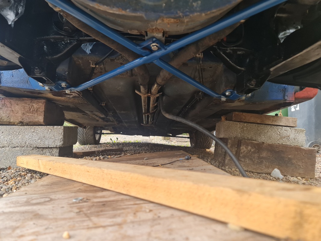

I finally managed to get the front subframe back in and swapped the coolant pipes for stainless one's and in the process gave the system a good flush.
painfully slow progress..but I will get there.

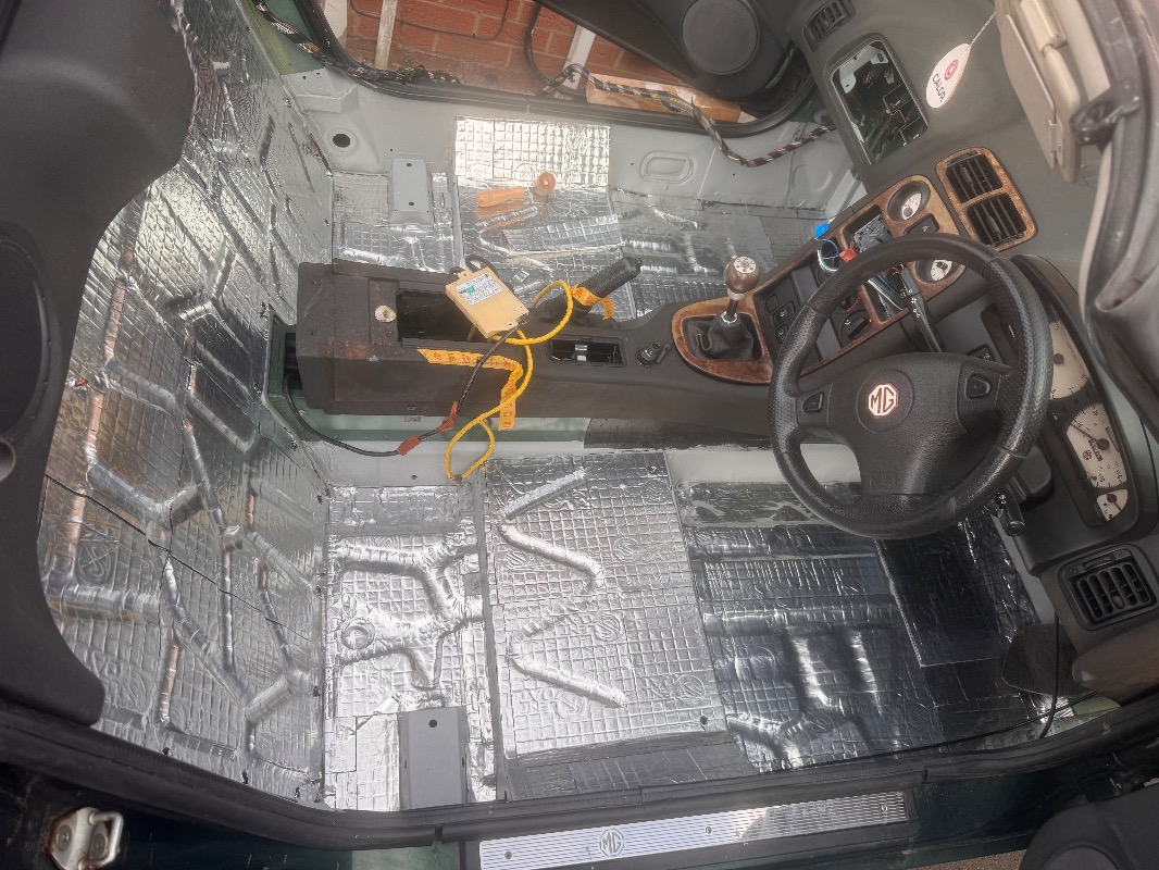

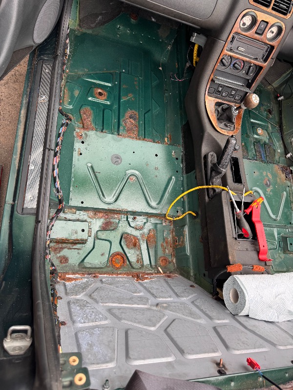

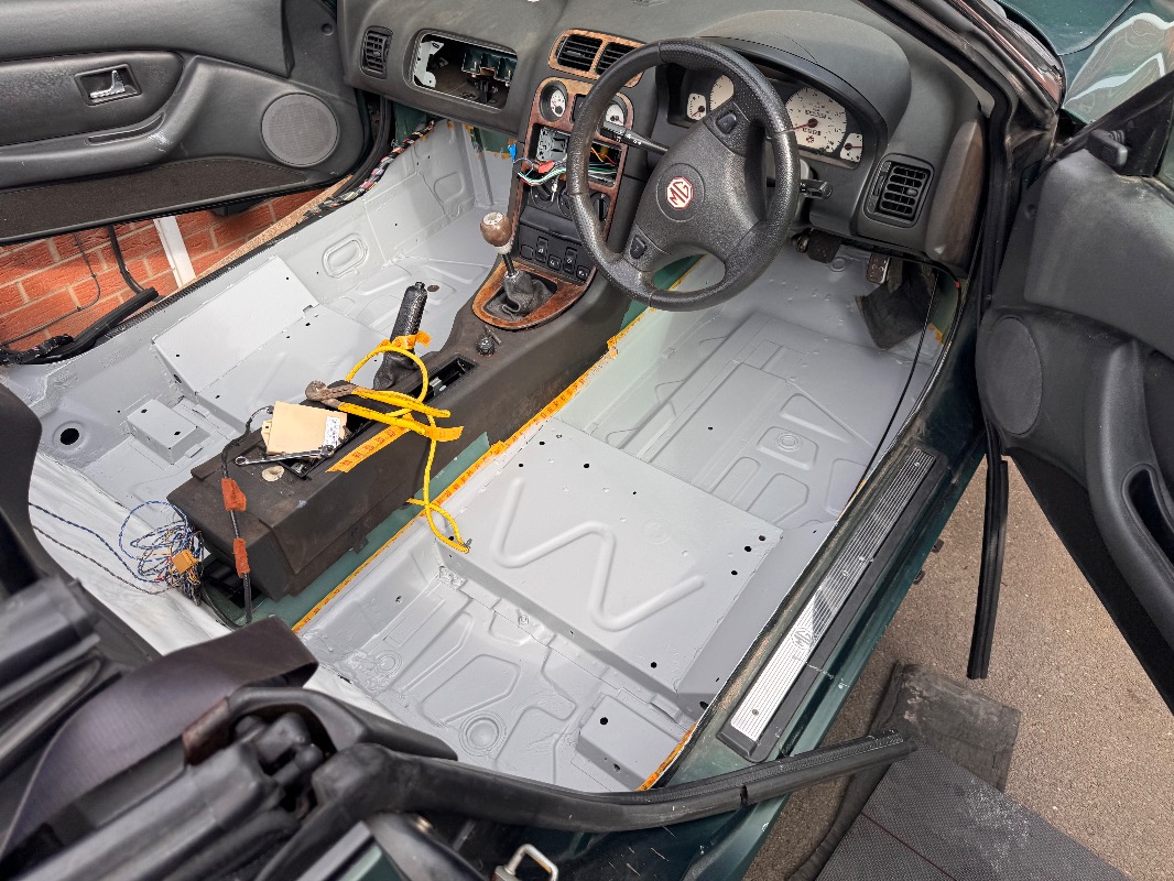

Posted 9 months 1 day ago #219710

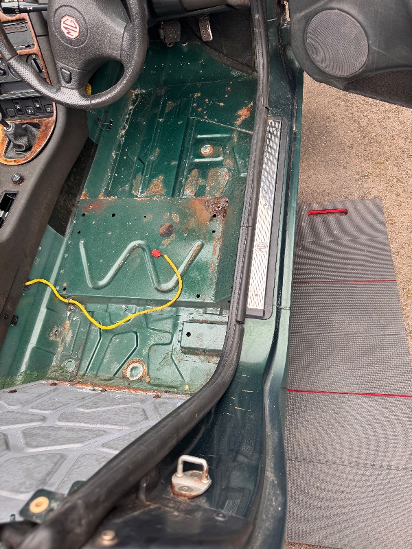

I have had the interior out, cleaned up the rust spots, treated them with rust converter, then painted with hammerite rust beater and covered with silent coat.
Last Edit:9 months 1 day ago by Daedalus
Last edit: 9 months 1 day ago by Cobber.
Posted 9 months 1 day ago #219711
Looks beautiful
Posted 9 months 8 hours ago #219767
That looks really nice.
Posted 9 months 8 hours ago #219770
That looks a lot better. Well done for defrosting those areas before they become an issue.
