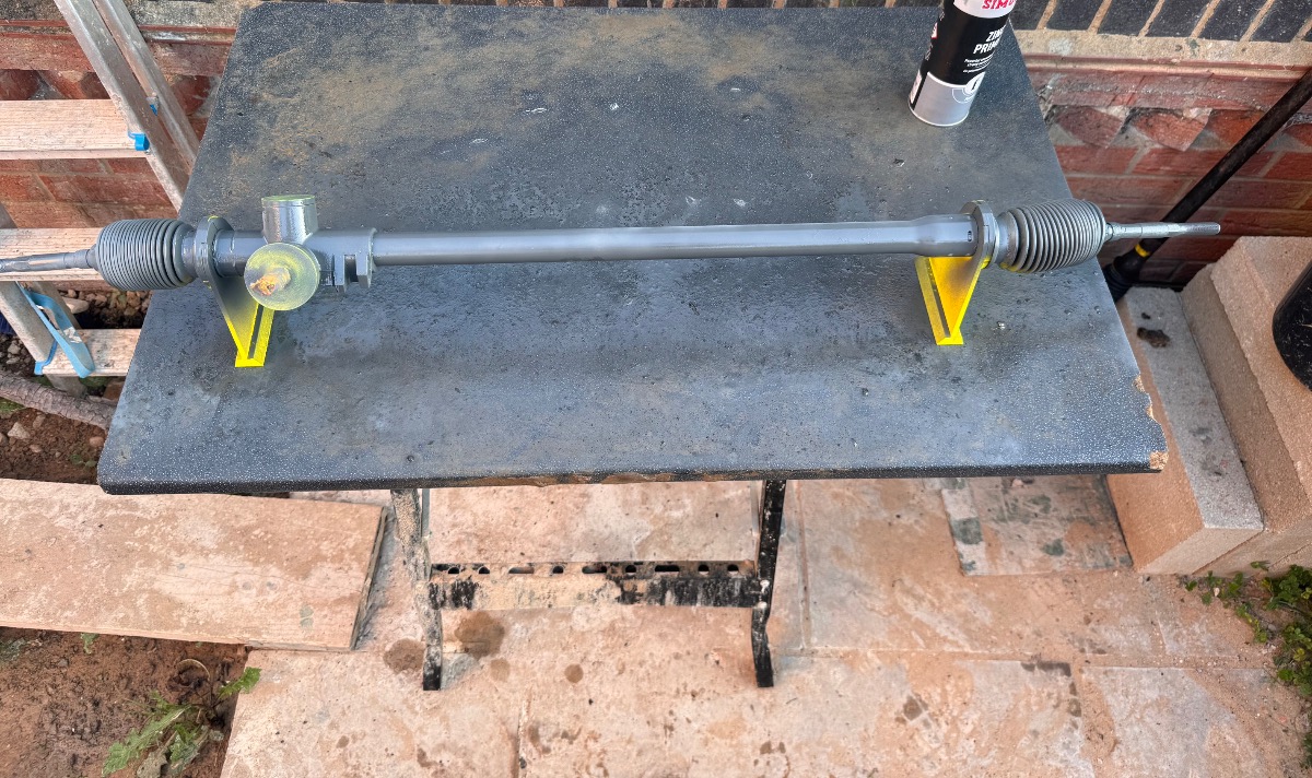

This week I made myself a paint stand and a pair of masking blanks and painted my steering rack ready for refitting.
by Daedalus
Posted 10 months 5 days ago #219093
I will of course be replacing the gaitors.

Posted 10 months 13 hours ago #219212
About a month ago I drained and flushed the cooling system and filled it back up with just water.
It was time to put antifreeze back in and I did it today.
Even though I had drained it previously I was surprised at how red the water was.
Filled it up with Oat antifreeze and bled it. Water out of all 3 airing points.
However the rad fan came on as soon as it reached temperature which was too soon.
I reached down from the bonnet and the return hose was cold.
Hmmm..airlock. A good few squeezes of the hose pumped air in to the header tank and all was well.
Ready for winter now and sludge free.

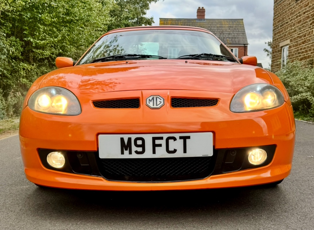

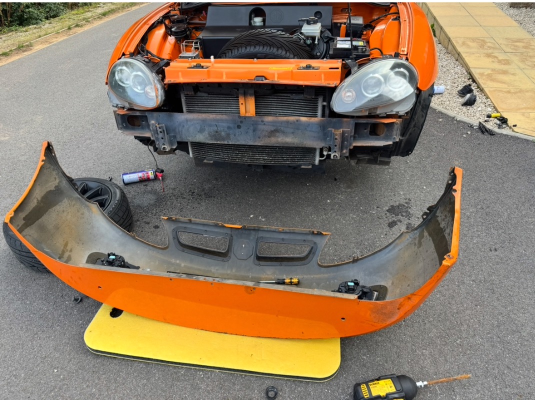

Posted 9 months 3 weeks ago #219326
I love that bumper 😍
