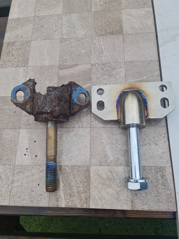

Finally got a dry day so that I could get the last few jobs done on the TF.
All of the brake pipes are now replaced and I'm just waiting for a few bolts so that I can fit the new rear calipers.
The rear subframe mounts have now been replaced.... (what a lovely job that was!)

Posted 7 months 4 weeks ago #220438
I like that the bolt screws in to the mount better than the original exposed thread.
Anti sieze of your choice would mean it will come out later.
Posted 7 months 4 weeks ago #220439
It's a really well thought out piece of kit..so much better than the original and it will make dropping the front or rear subframe much easier.
Posted 7 months 4 weeks ago #220442
Are you changing all the subframe mounts ?
Posted 7 months 3 weeks ago #220457
I'm only changed the small ones on the rear, the only bad one was the one in the photo.

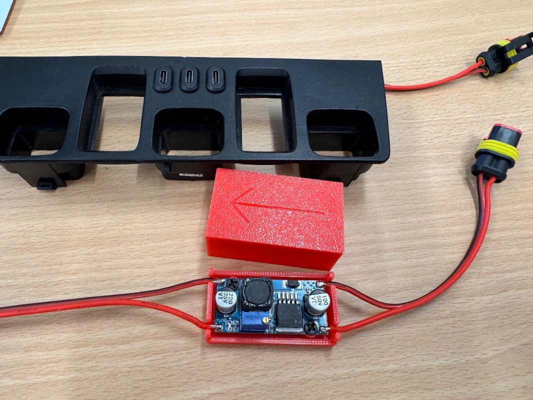

I have added three USB-C ports to my dash, next onto the wiring.
Posted 7 months 3 weeks ago #220554
That’s neat, are they for phone or other hardware. How are you routing your cables, I’m always interested in cable routing, any better methods than my own I pinch.
Posted 7 months 3 weeks ago #220555
They are just for power, so charging phones etc. they use a 5v supply so I am using a cheap voltage regulator in a 3D printed case.
I will use some double sided tape to fix the voltage regulator and run the supply from a new fuse box, which I have yet to fit.
Posted 7 months 3 weeks ago #220559
Ah! One of my favourite buck regulators, as cheap & easier to use than a 7805 & associate bits.
