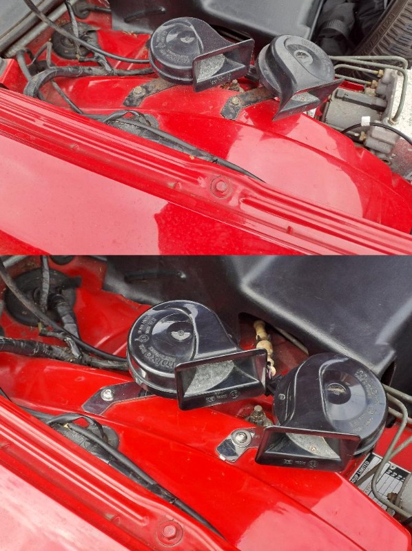

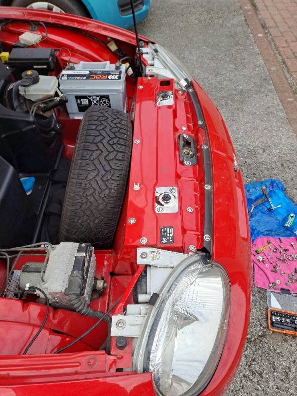

Replaced rusty and mismatched screws and bolts under the bonnet with the stainless ones from MGFnTFbits. Having done that, thought, I need to change the radiator mounts and catch plate which they also supply in powder coated black so ordered them and some rear light covers ...

Powder coating is nice, lamp covers border on an imperative.
IIRC the threads are M5, arm yourself with another half dozen nuts & place the covers over your present fixings, securing with those six.
There is every possibility your lamp clusters are water tight, removing them to fix the covers would in all probability break that seal & you’ve just created another job.

8mm according to a video I've just watched - and yeah - I'll be leaving the existing fixings and just screwing these on top. Cheers

Nut is 8mm but thread is M5..I think.

I did mine a few months ago and the horn brackets .pitty you cant get S/S catch plate but I need to get apowder coated one too as it lets it down a bit .
