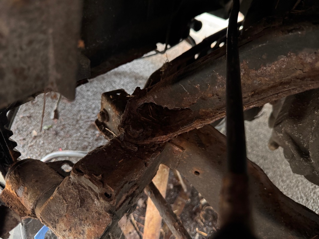

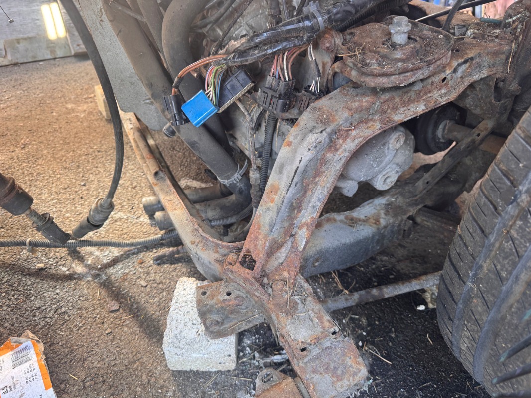

So I got a bit further on the engine removal yesterday, it appears that i may have some rust on the gearbox mount bracket !
Luckily I have a galv one that came with the subframe.

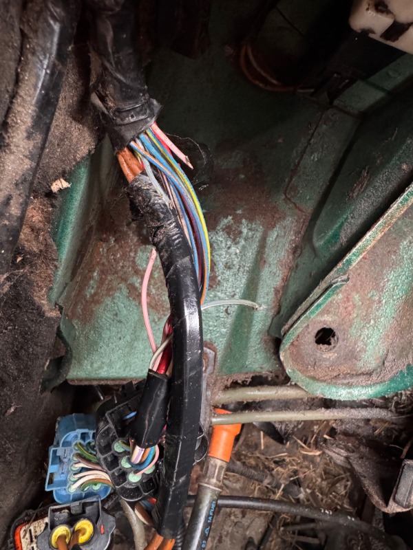

I also think i have found the source of the engine fan issue, as whatever nested in there had a go at the loom
I am assuming this is where the ABS sensor was connected, you can still see a lot of the mess from the nest. This will all be cleaned up before the engine is refitted.

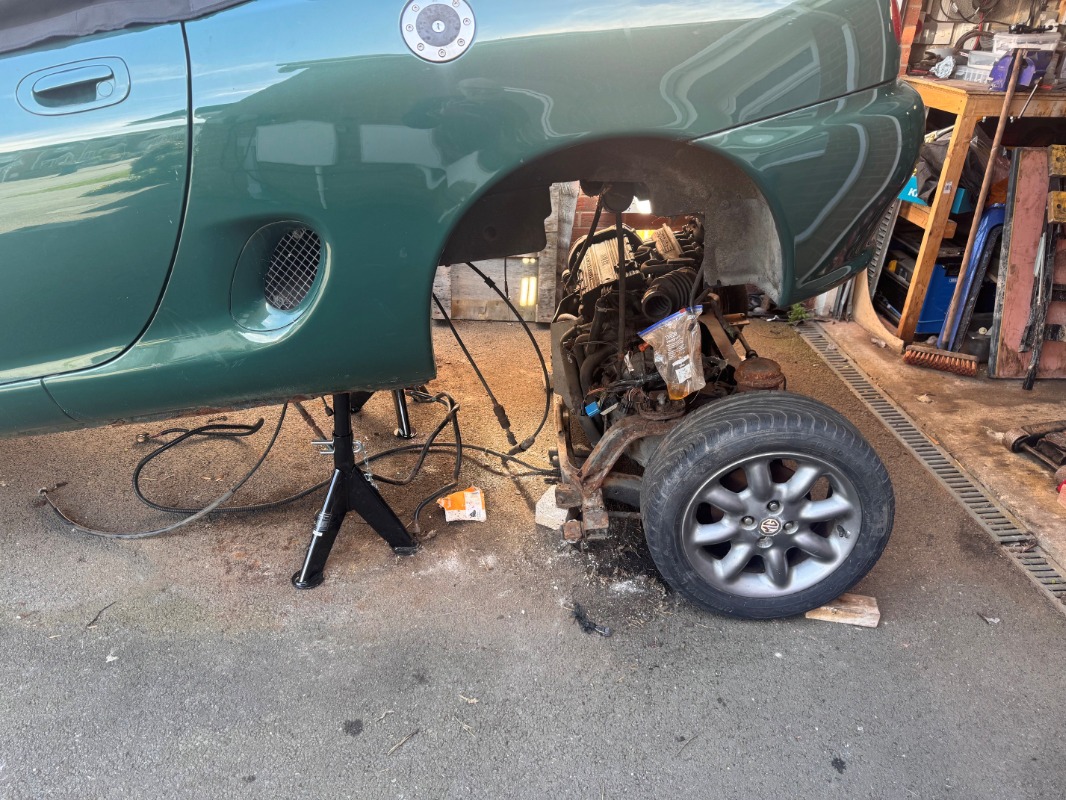

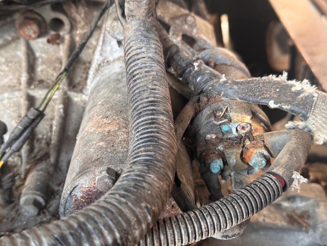

I managed to jack the car up, and now the engine is free to be wheeled away, once i have made a small trolley for the front of the subframe. The starter motor connectors look a bit rusty, is there a good way to clean them up?

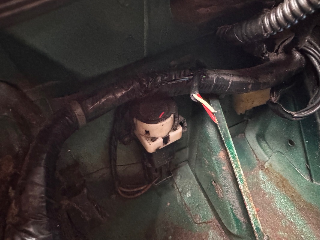

The white/red wire above the fuel inertia switch, what did that service?

Which wire are you referring to?

These are the wires for the ABS sensor, something had chewed them, they have now been soldered back together, heat shrunk and wrapped up with amalgamating tape.

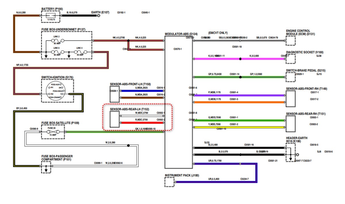

Thank you both. It is unusual to see solid colours on “modern” car electrics, other than brown & black. White & reds like these are a shorthand for left & right in audio equipment, I was wondering whether you were into “bangin tunes”. I guess this has been grafted on to obviate the rodent nibbles.

Well bugger me !! I never knew that, obviously. That makes me look monumentally dim for someone who has spent a considerable amount of time poring over those diagrams. I have spare sensors & have had that lot out, all be it a while ago.
Anyway thanks for that, I’ll not be so noisy next time.

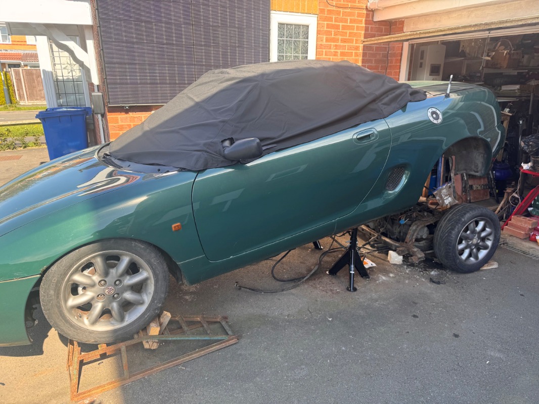

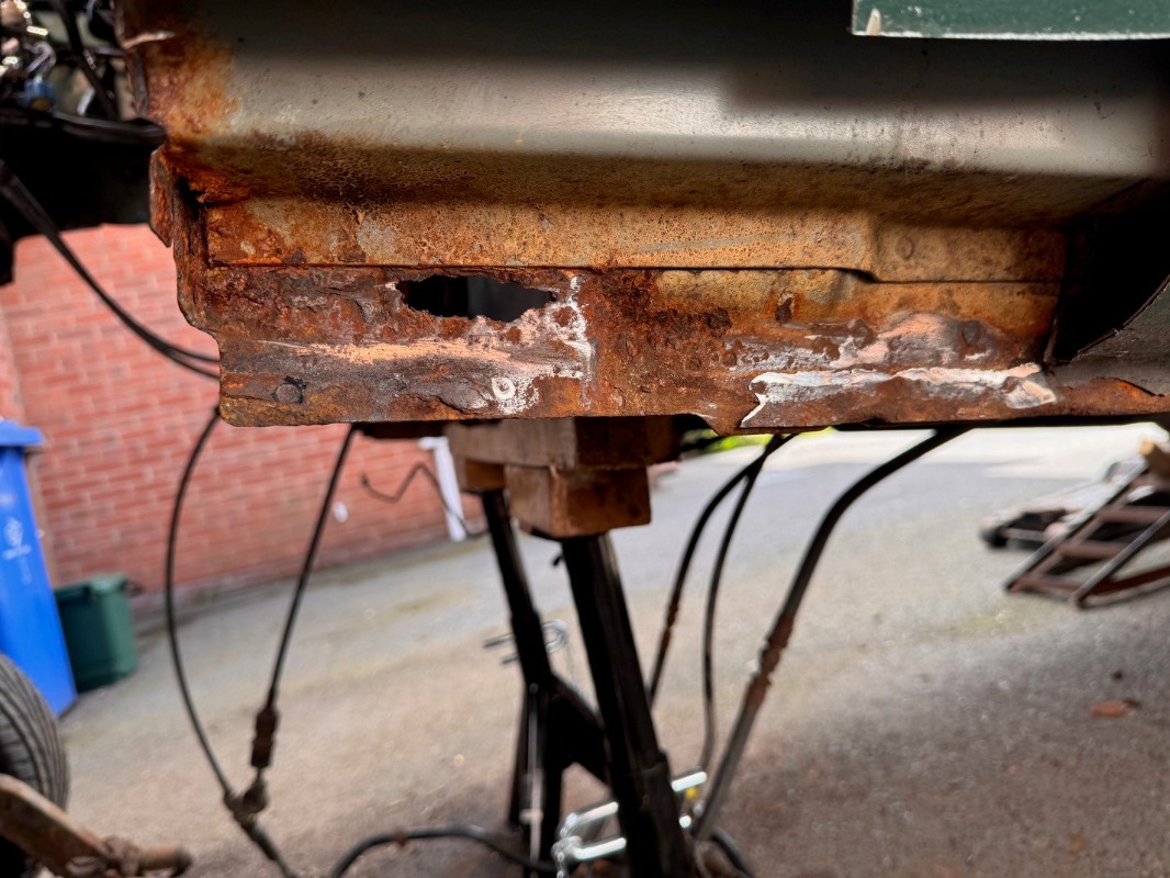

Now i have rolled the engine back, I can finally see how much remedial work is required on the ends of the sills, the offside one is worst, so i cut some of the outer sill away and remove the rotten part of the end.
A bit of work is required on the bottom of the subframe mount, but not too bad.
