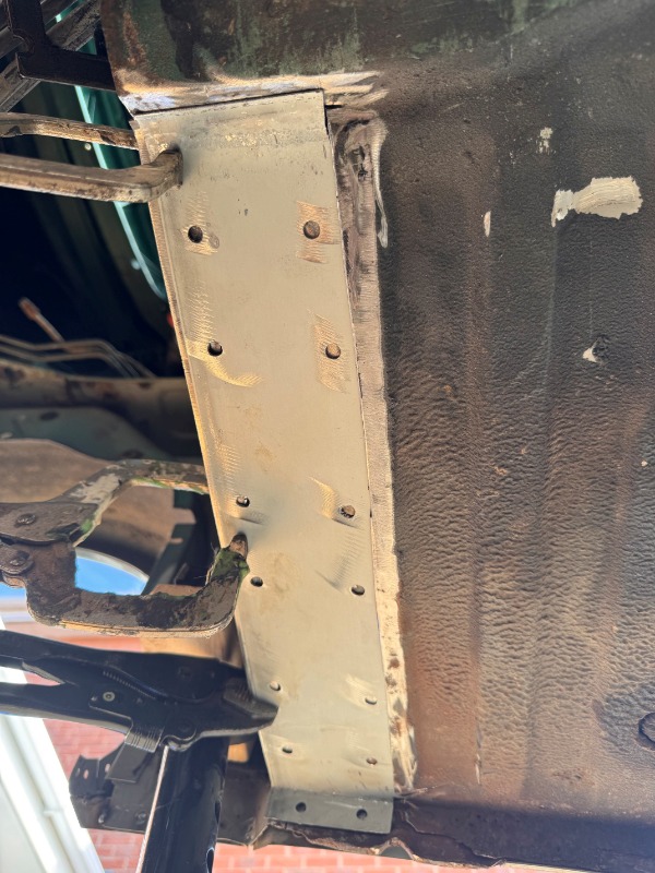

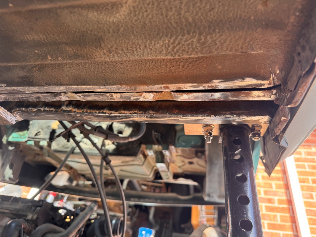

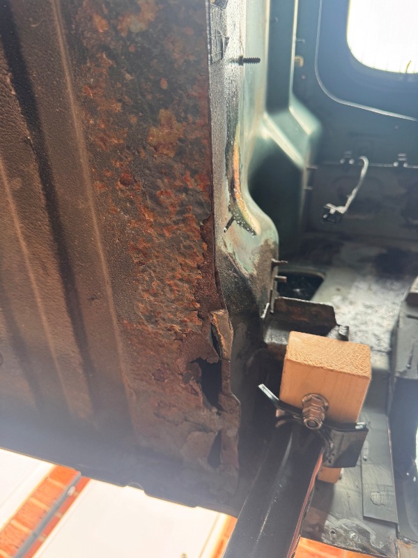

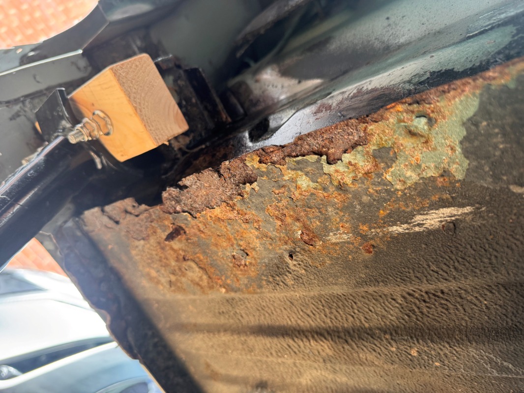

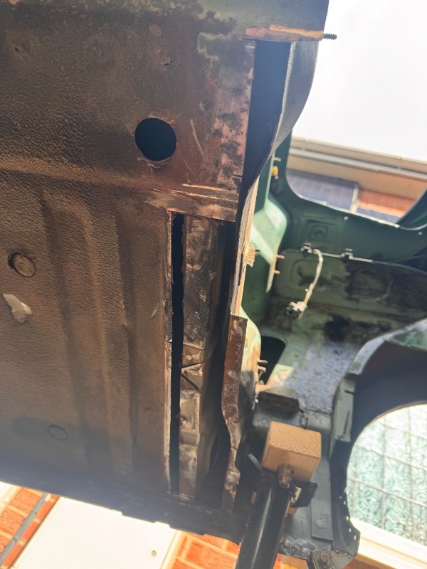

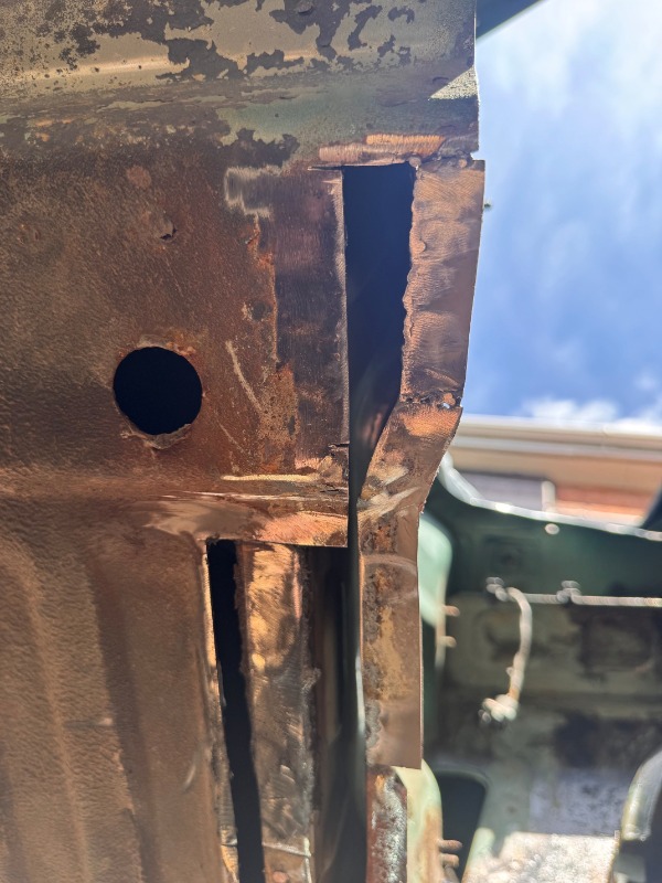

Today was the day to tackle the rear floor, both sides were rusty and the return at the bottom of the bulkhead was decidedly secondhand.
O/S Rear Floor
N/S Rear Floor
I cut out the offending rust and removed most of the return on the O/S
Welded in a new return
I welded in the repair panel and also seam-welded where the bulkhead meets the floor to ret and prevent any future water ingress.
I removed the N/S Floor and all of the return and welded in a new return
Made a repair panel, clamped it in and then ran out of gas, so its all on hold, untill i can remember where i got the last bottle from.
The fule tank sits right on top of this panel, i drained it, but i think i will remove it once i have the car back down on the ground just to make sure i havent weakened it.

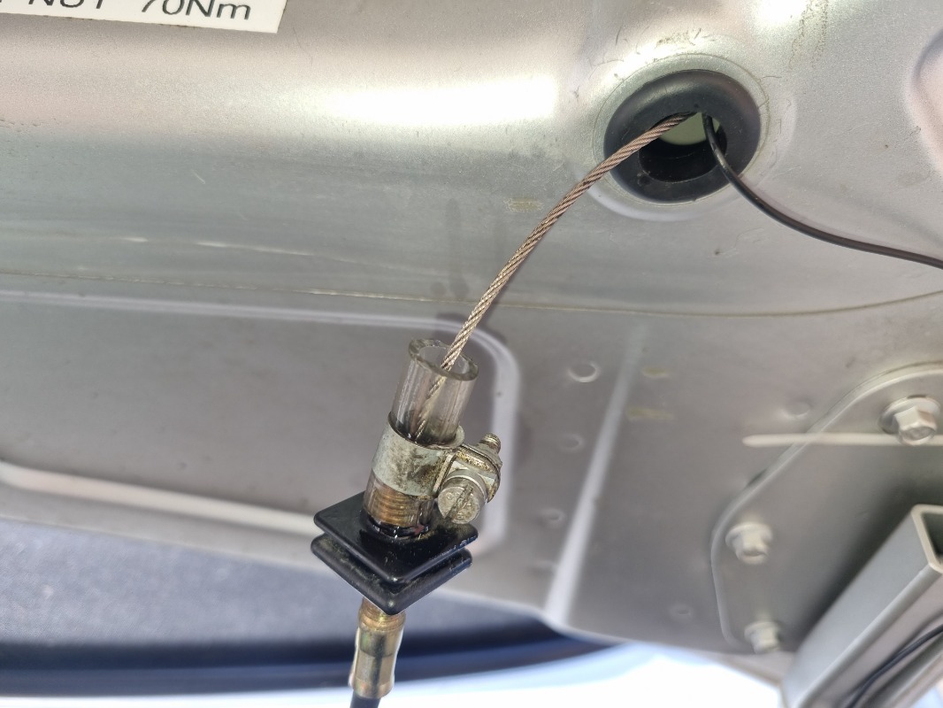

Took off the throttle cable, put an 8mm split tube on it and hose clip reducing leakage.
Sprayed lots of GT85 in to the tube and repeated after bubbles replaced the lube.
Easy job which I hope will make throttle control a bit easier.

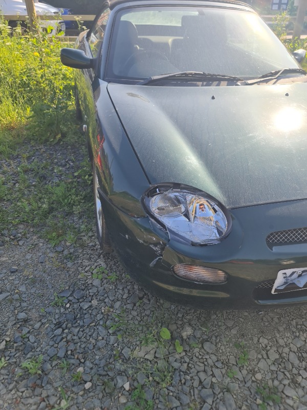

I was getting ready to  go to work this morning and a young lady asked if I was the owner of the green car in the  car park..
My next project just got much worse.
