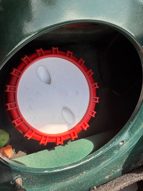

I took the fuel pump out today so I could drain the fuel, as I will be doing some welding on the back of the floor.
what a pig of a job, I bought one of those cheap tools from AliExpress which did it, but I could only turn it about 20% at a time as it was hitting the bulkhead.
i am not looking forward to putting it back on.

Posted 2 months 2 weeks ago #223105
Getting the pump located in the tanks indexing recess is the hurdle to get over. It shouldn’t be as hard with an empty tank but with fuel in there, the buoyancy of the pump fights against an easy replacing.
Also ensure the float is free to cover its entire stroke; get it wrong & your fuel gauge will be even less trustworthy, heralding a revisit & in a less than sanguine outlook.

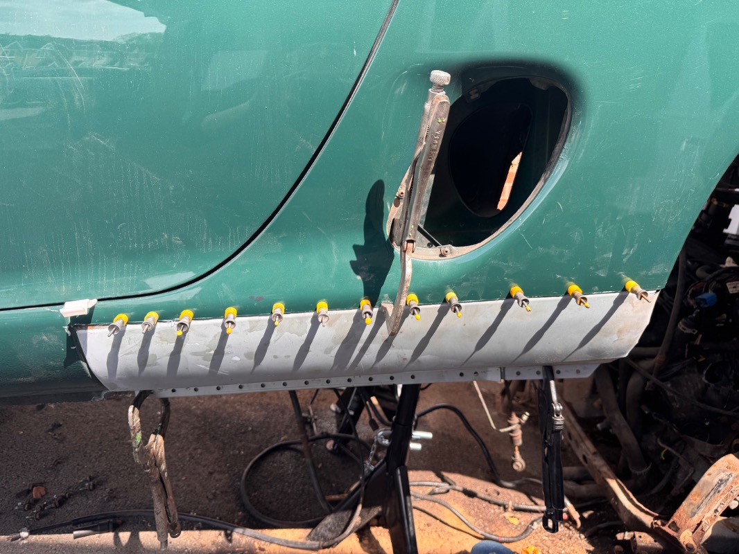

Posted 2 months 1 week ago #223199
I made a blanking plate to go in place of the fuel pump while I finish up the work in the engine bay.
and I got both sill repair panels pretty much trimmed and ready to go.

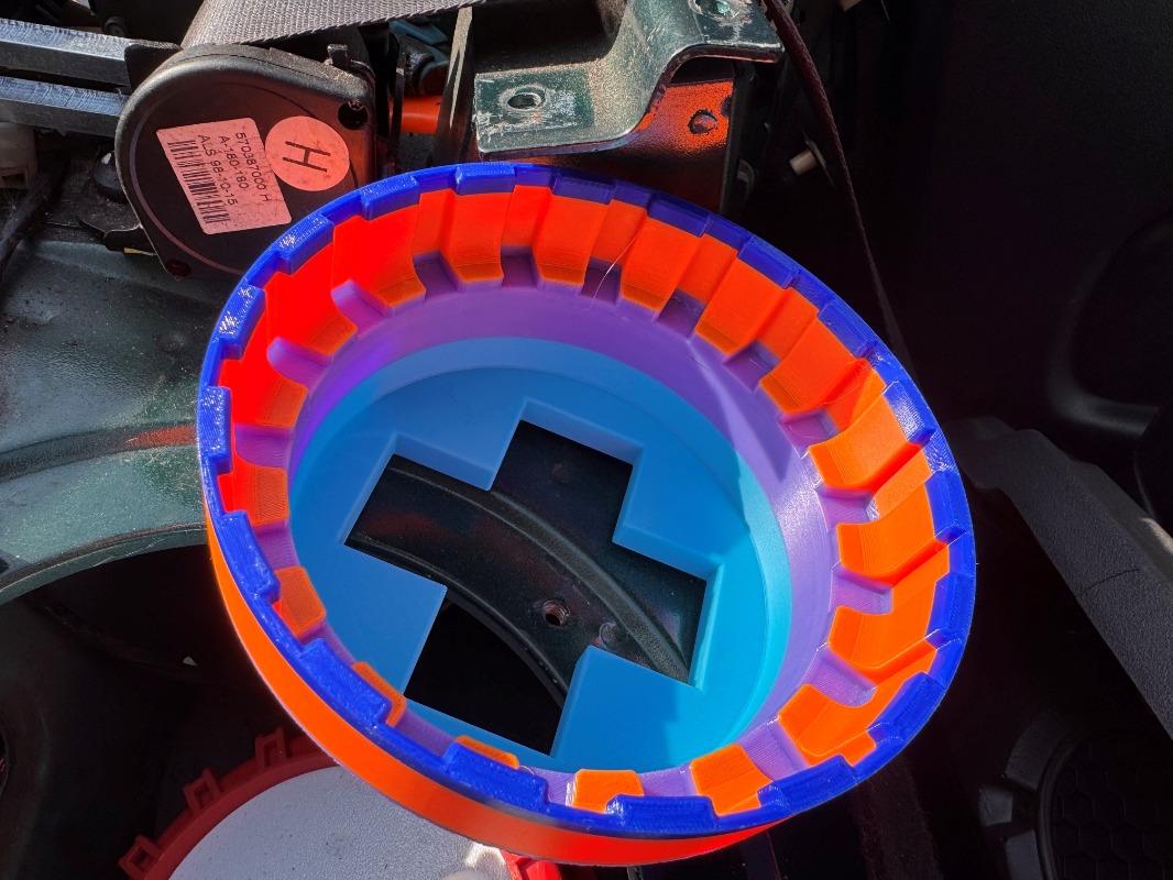

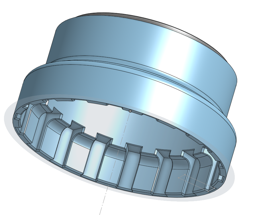

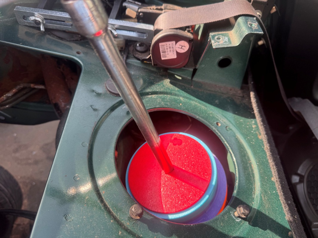

So after struggling to get the fuel pump ring off, I designed and printed a tool that should make life a lot easier when it comes to go back in. I made it in two parts as I thought the 1/2" drive would be the weakest point, so it would be easily replaceable and save a complete remake.
Annoyingly, i left the fuel pump at work, so I can't try it, with the actual pump, but i did a dry fit in the office, and it fitted fine.

Posted 2 months 4 days ago #223302
Very impresive, my guess is that it would have taken you a fraction of the time it took in making my interpretation.
I would put a picture of mine up; if only I knew where I'd put it. Its an age thing!
