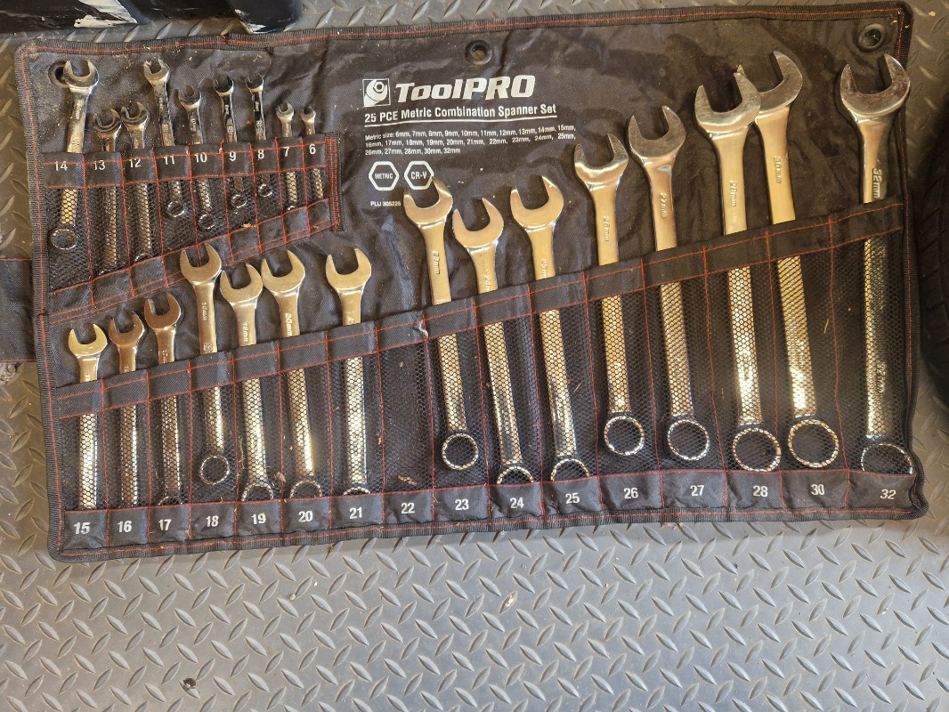

We went in to an Autostore and had a good look around. I spotted a set of spanners in a tool roll from 6mm to 32mm and they were on sale for 50 Aus dollars which was cheap for us.
We bought a couple of sets and they came home shipped with the car in the container.
They came in handy yesterday on the MG. Notice the 22mm is missing. It fits the ECT on the engine.

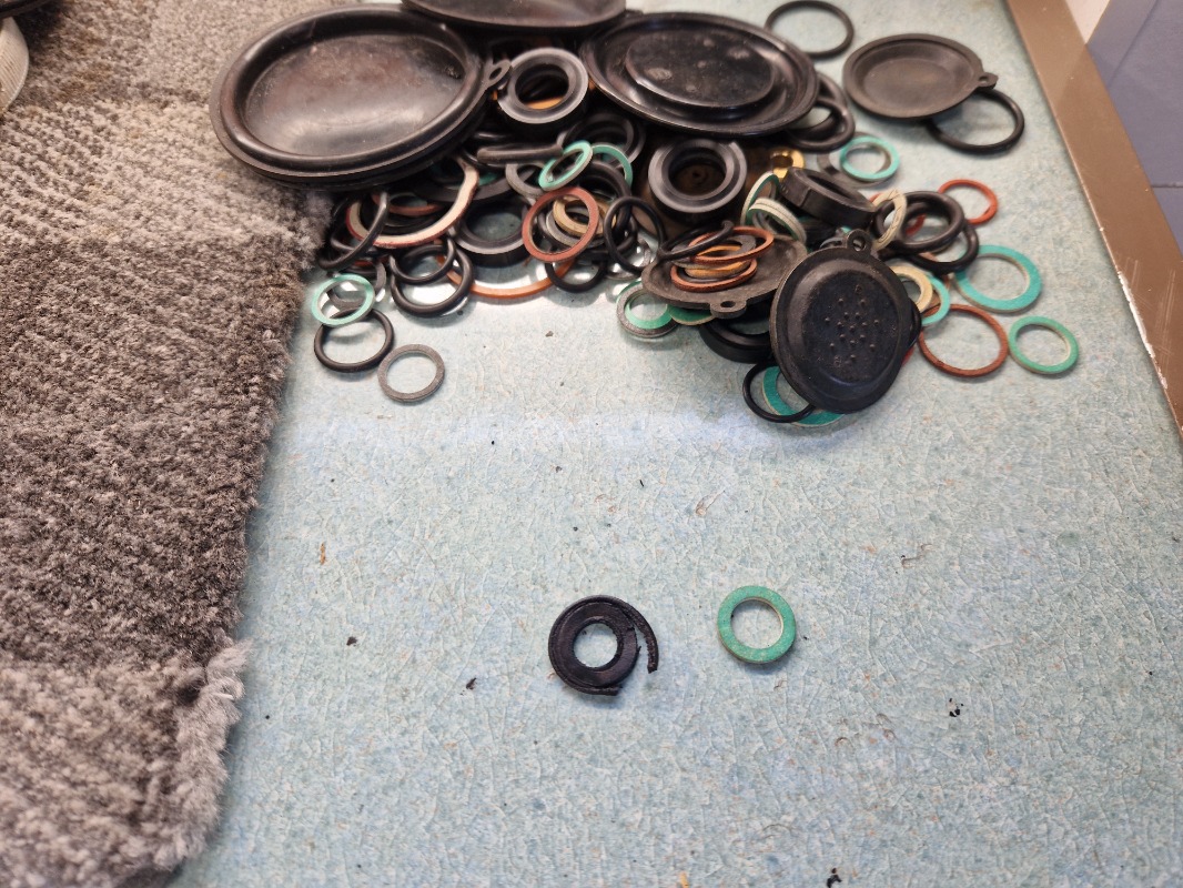

I replaced it with a fibre washer from my heating jar!

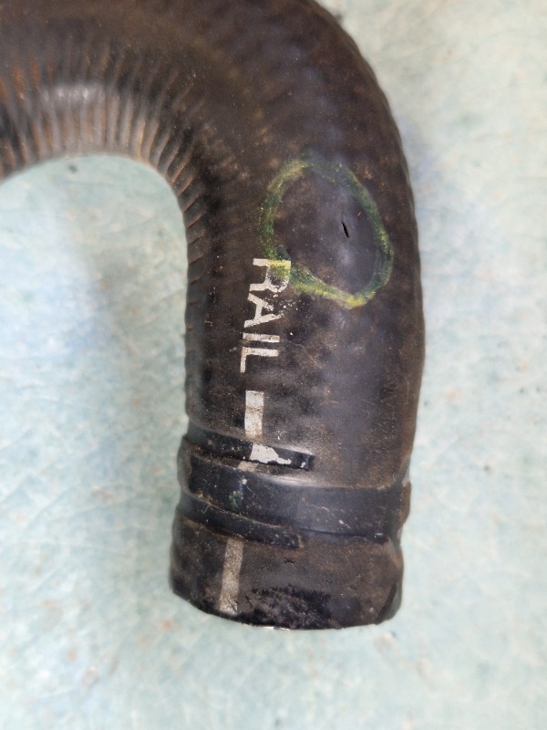

Yanked the front light from my bike and lit the engine up. The light caught a tiny spray of water from a pin hole in the thermostat bypass hose to the water rail. 6 inches of bent rubber with a hole in it.
Part ordered!
