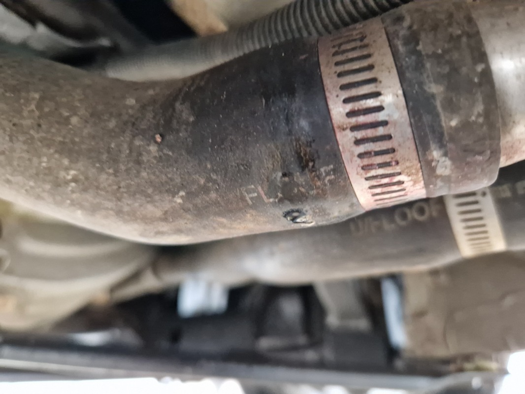

I had a tiny leak on a hose from the central SS pipes to the radiator hose and decided to change it asap.
Knowing the hose was coming I drained and flushed the system. It didn't appear sludgy just red antifreeze. I had no overheating problems at all. Heater worked all thru my first winter and the rad fan worked.
I refilled with water, cut the bad bit of hose off and ran it a few days. When the hose arrived I drained it again. It still had red in it so I fitted the new hose and ran it again with water.
