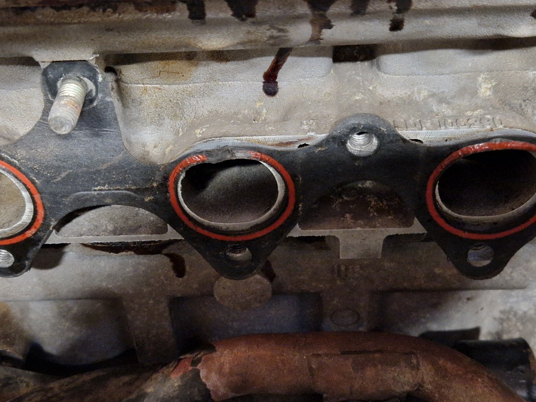

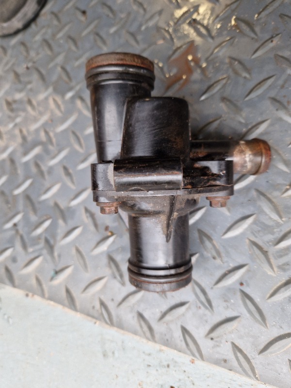

Replied by TA22GT on topic Advice on replacing 135 thermostat please.
Posted 1 week 5 days ago #224214
I am starting to form a love/hate relationship with this car. Once it was only love.
The thermostat is out. I had to remove the inlet manifold after all. The pipe pulled off the thermostat but butted up against it and no amount of wiggling or pulling would move it out of the way.
The stat hasn't arrived yet so I have time to clean up the block and cambelt cover.
I found the small hose from the expansion tank to the inlet manifold blocked at the fitting so that was not allowing it to breathe at all.
Lucas coil packs and the radiator airing plug arrived and the spare rim arrives Friday. Having a spare will be a big relief.
It's going to have to sit for a few days as I have to spend time away.
At least I now know what the pipework looks like and how to get to it!
Thanks for the help guys.

Replied by D4KGP on topic Advice on replacing 135 thermostat please.
Posted 1 week 4 days ago #224219
The rest should be easy, when I changed the stat on my F years ago I just replaced the stat not the complete housing. The stat I used had a small jiggle ball in it. I couldn't offer any advice on the removal of it when you were asking for it as I'd forgotten how I done it, I think it was done as a matter of course when I did the HG in 2012. G.
