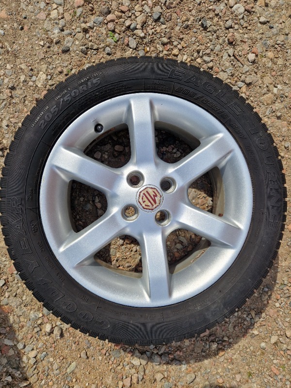

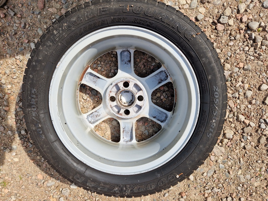

Well the spare wheel and tyre arrived today and perhaps the best ยฃ50 I have spent and included postage.
The tyre is from 2012 but is solid with zero cracks.
It came deflated so I pumped it up and let's see how it is tomorrow morning.
He has 3 more left all with correct size tyres for anyone who may have upgraded their brakes and found the spare doesn't fit..cough..Delbourt.

Well the tyre lost 10psi overnight.
Oh well back to fitting one of the spare new Falkens.
At least I will have a good spare.
I am parranoid about driving without a spare.
Replied by Cobber on topic Advice on replacing 135 thermostat please.
Posted 1 week 2 days ago #224273
Pump up that tyre again and throw it in a water bath to see where air is coming out, it may be a cracked wheel!
Way back when........I was the proud new owner of my MGF, and I had one tyre that insisted on deflating constantly, I had to chuck it in aย  water bath to find that the wheel had a crack in it.
No point paying to put a good tyre on a buggered wheel......best to find out which one is the culprit.....the tyre, the valve or the wheel!
I just thought I cheer you up with that possibility..........bet your feeling happier, now you have that thought rattling about in your head! ๐Ÿคฃ

Replied by Delbourt on topic Advice on replacing 135 thermostat please.
Posted 1 week 2 days ago #224275
Oh bad luck! I was going to buy that wheel (if it is from the supplier I think it might be) ย but delayed the purchase and bought one of the other 4 after that one was NLA.
The wheel itself is only slightly scuffed at the rim but the tyre is holding pressure even if it is a bit old with what I consider to be full tread depth.
Based on this and TA22GTโ€™s experience the others are probably good value.
