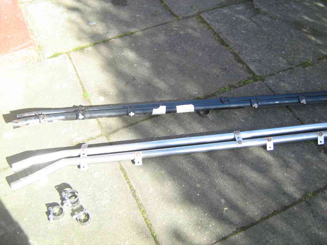

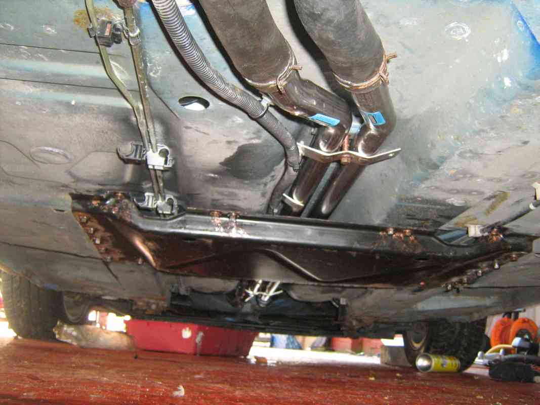

Exhaust fixed.

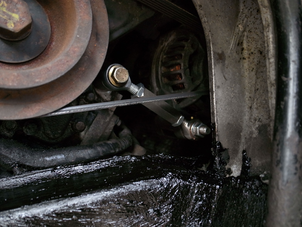

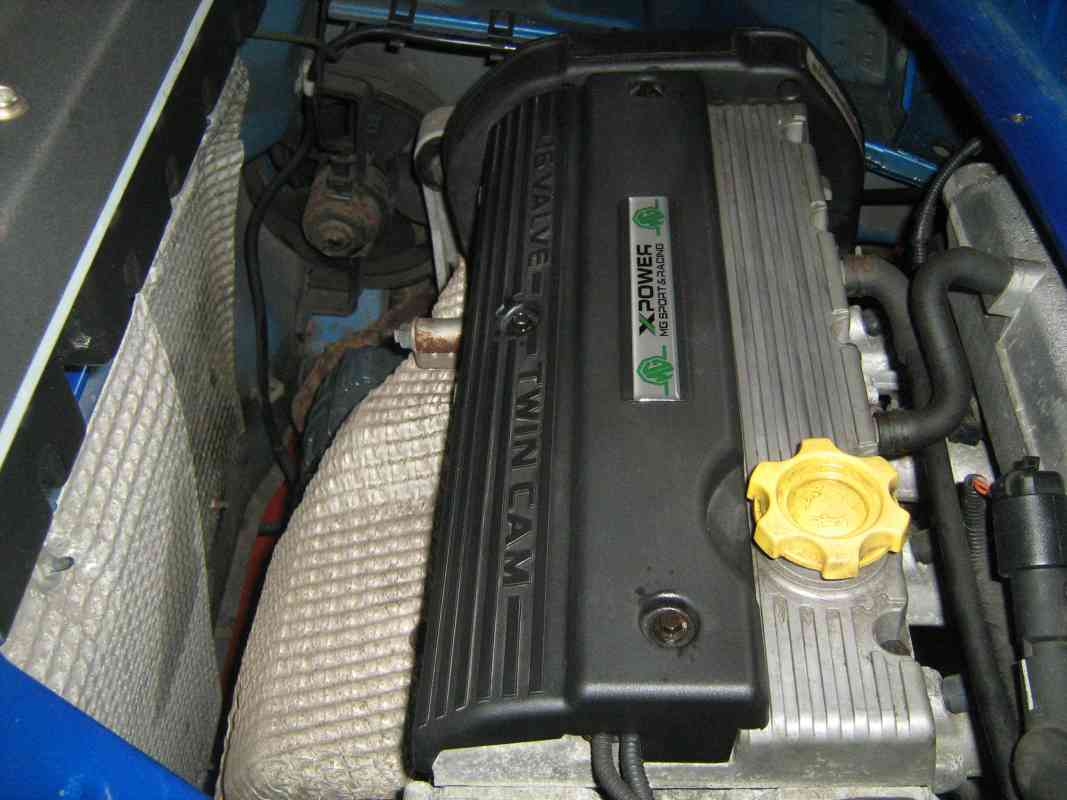

OK so it's not the weekend but there was a dry spell today so I fitted my stainless steel alternator belt adjuster. I know there is a how-to on this already so here is simply a picture of the finished article and some fresh black waxoyl on the subframe (also in my hair - better than the grecian stuff!)

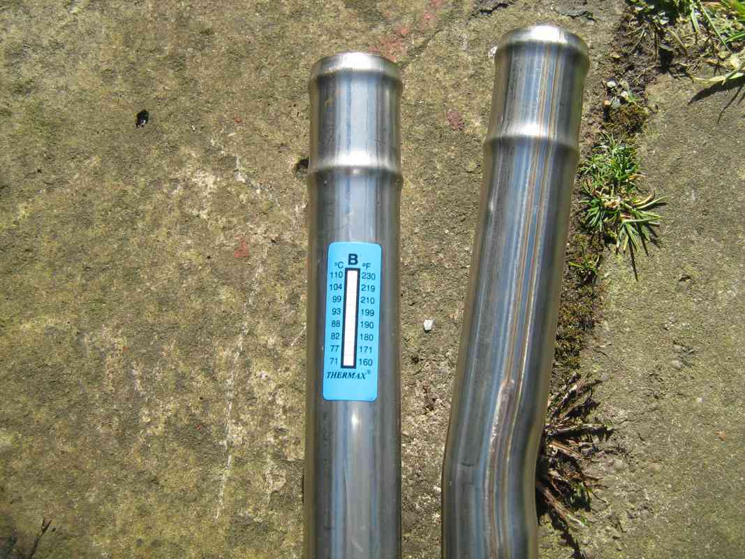

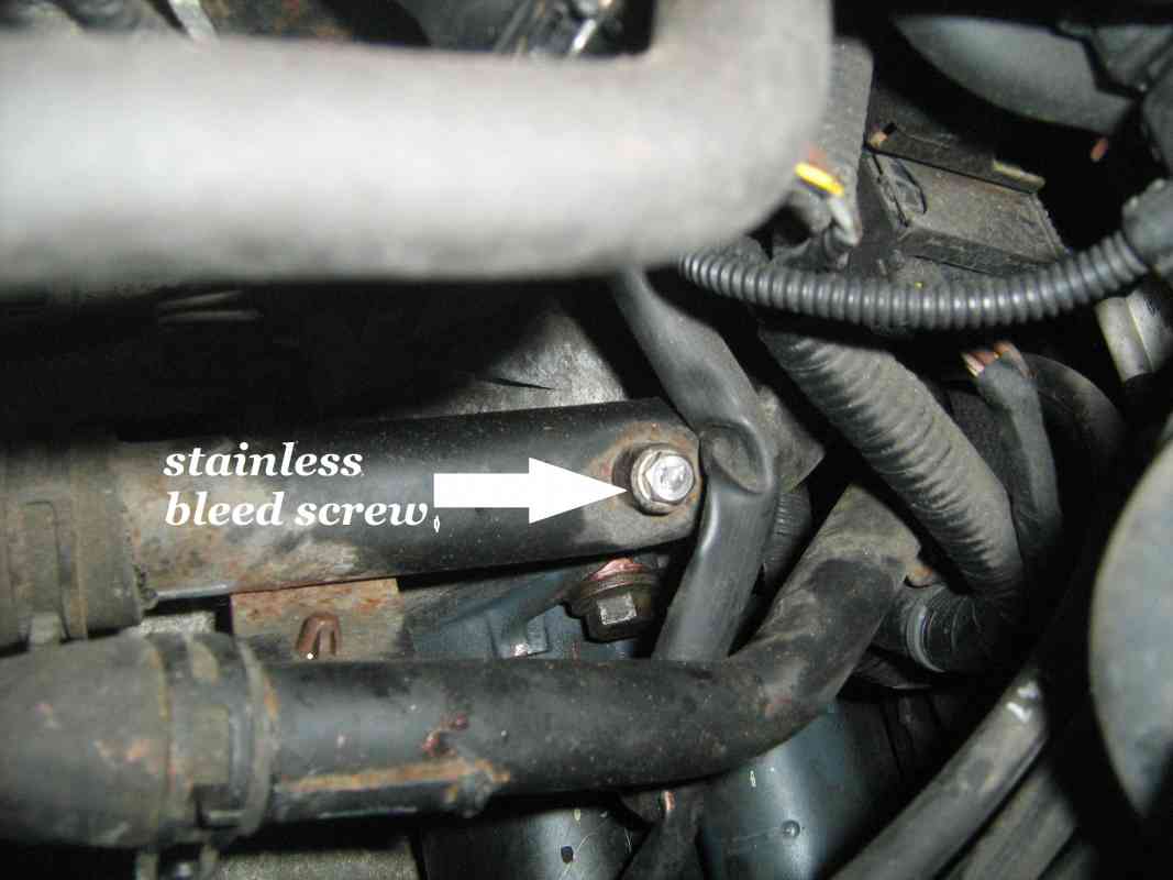

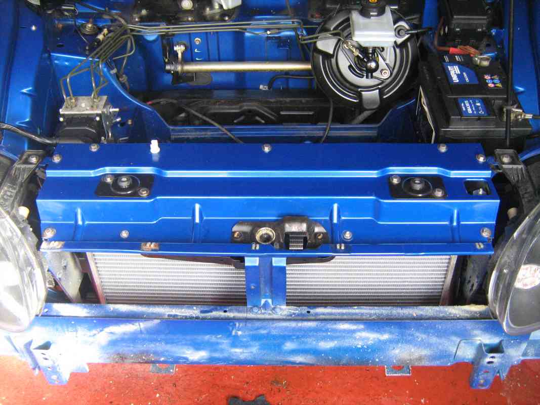

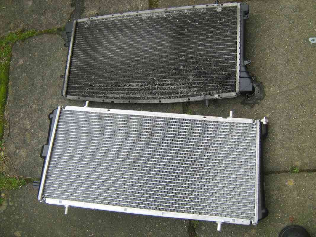

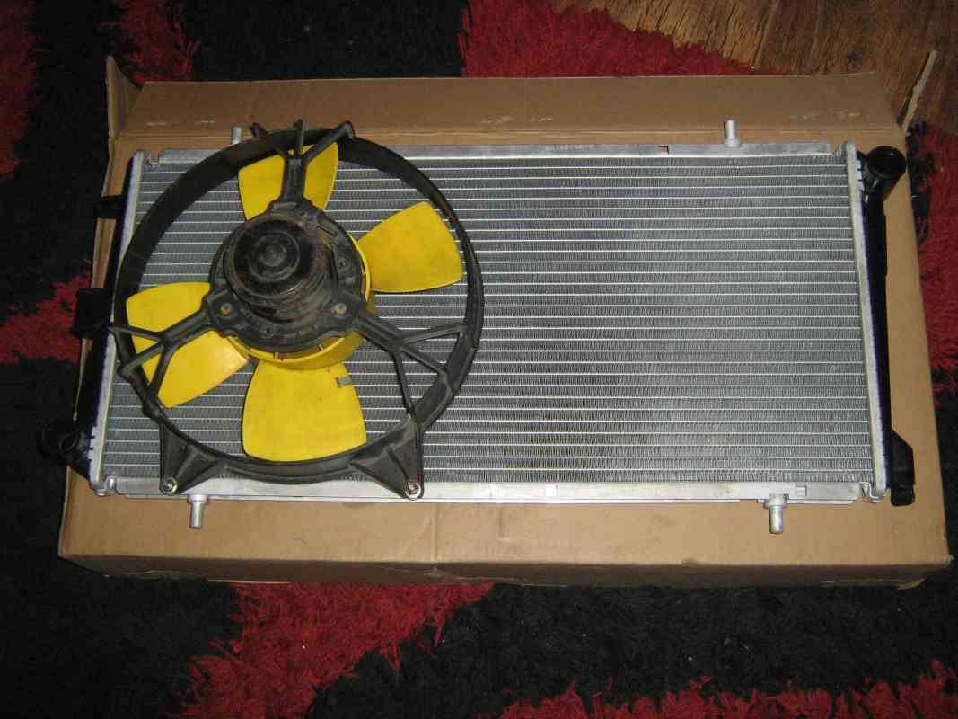

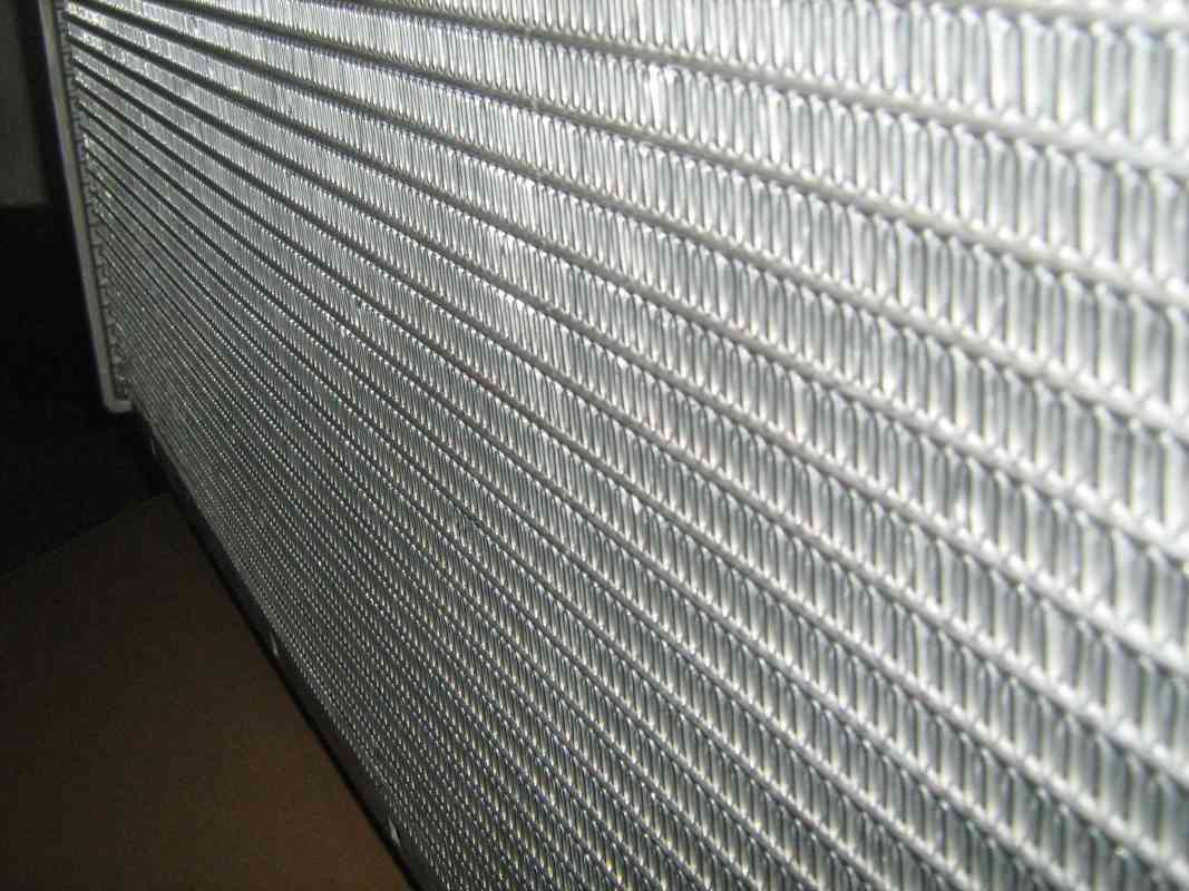

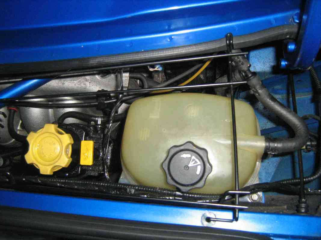

today I fitted stainless coolant pipes and a new rad and stainless slam panel bolts,thermo strips mike satur bleed valve :woohoo: :woohoo:
..........My old rad was bowed at the bottom..no leaks but an alarming shape.on further inspection I found the fan cowling was distorted...this was due to the bowing of the rad and after time memorised the position.this was apparent when it did not fit the new rad .the distorted cowling meant the fan blades were shaving one side of the cowling .melted black plastic on tips of blades...so I bought another fan complete with cowling///and yes it fitted like a glove...I was told this bowing is caused by a head gasket failure........another theory being the aluminium fins at the bottom becoming corroded and expanding .a certain disaster would of been on its way if I had not explored the radiator condition :yesnod: ...my car is in very good condition and would of easily been overlooked..don't just glance through the vents because mine looked great when peering through ......do a proper inspection......the old coolant pipes were in great condition still had mg rover stickers on they were great internally and externally......well after everyone telling you your pipes need changing you get brainwashed into putting on stainless..........if you are considering fitting the mike satur bleed valve,please note there are thread variants on non genuine rads.........mine was drilled and tapped to allow the sattur valve to fit my new rad.....the new rad had a smaller inlet than the original rad........alternatively you can make a adaptor to mate the valve to the smaller rad fitting ......................last but not least it was filled with oat longlife antifreeze and deionised water .on an environmentally friendly note.........Halfords do this type of antifreeze with bitrex added this makes the antifreeze bitter to taste.......which helps prevent the likelihood of children,pets and wild creatures from drinking this otherwise sweet potion causing them harm ......a cool thought on halfords part....antifreeze even spilt in a puddle of water is a killer..:hgf:
nice and clean with stainless bolts :clap:

I got the rad from paul depper mgs................Norton caynes near Cannock....along with a second hand fan I saw cheaper ones on ebay but I thought id rather collect face to face and get a rad that will fit first time...........has you may have heard some rads have been supplied on ebay with support legs in the wrong position..... :oops: ;)........................pardon the ignorance,but what do you mean by the 75th model

Fitted a new alternator drive belt, which was dead easy because of the upgraded adjuster that I'd fitted previously.
