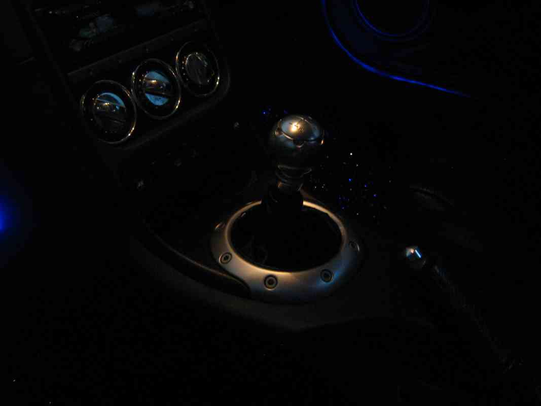

fitted a alloy handbrake button :P bling

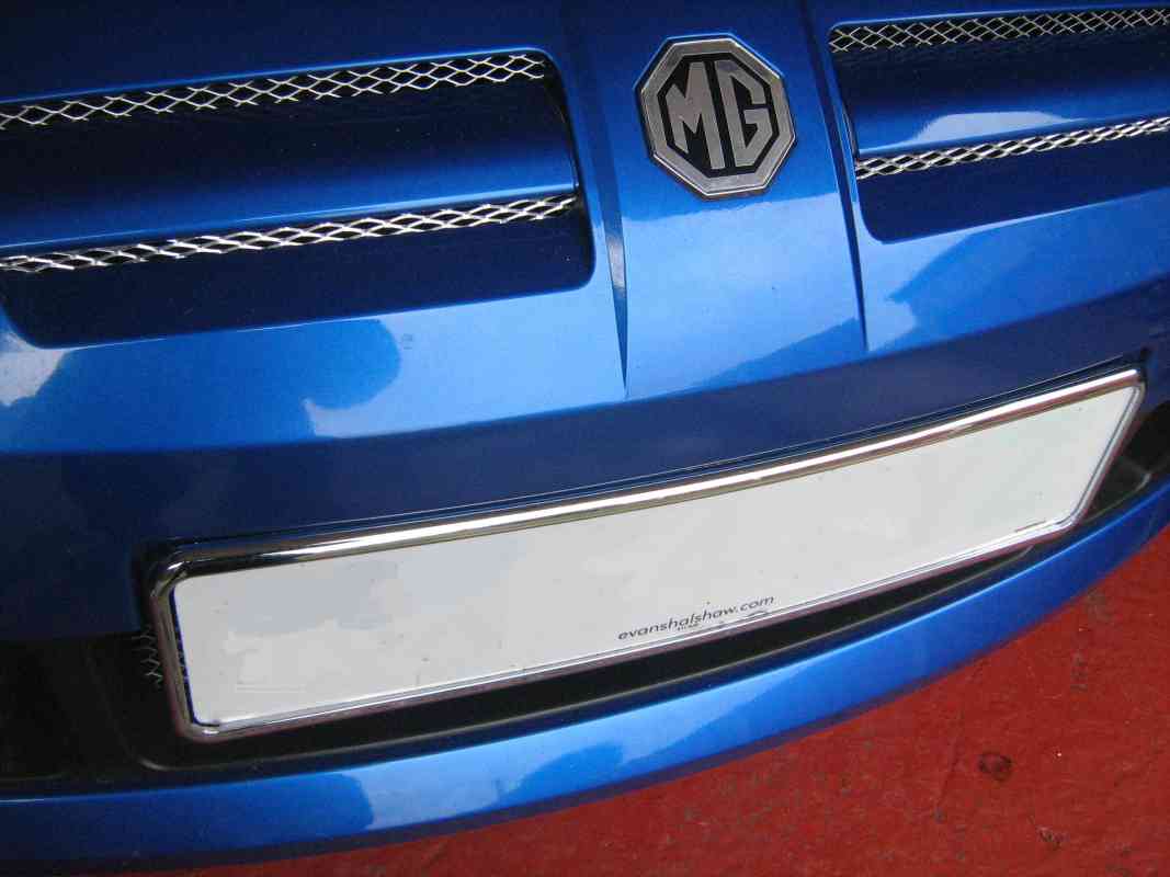

spoilt the mg this week and added some more bling this time in the form of chrome number plate surrounds

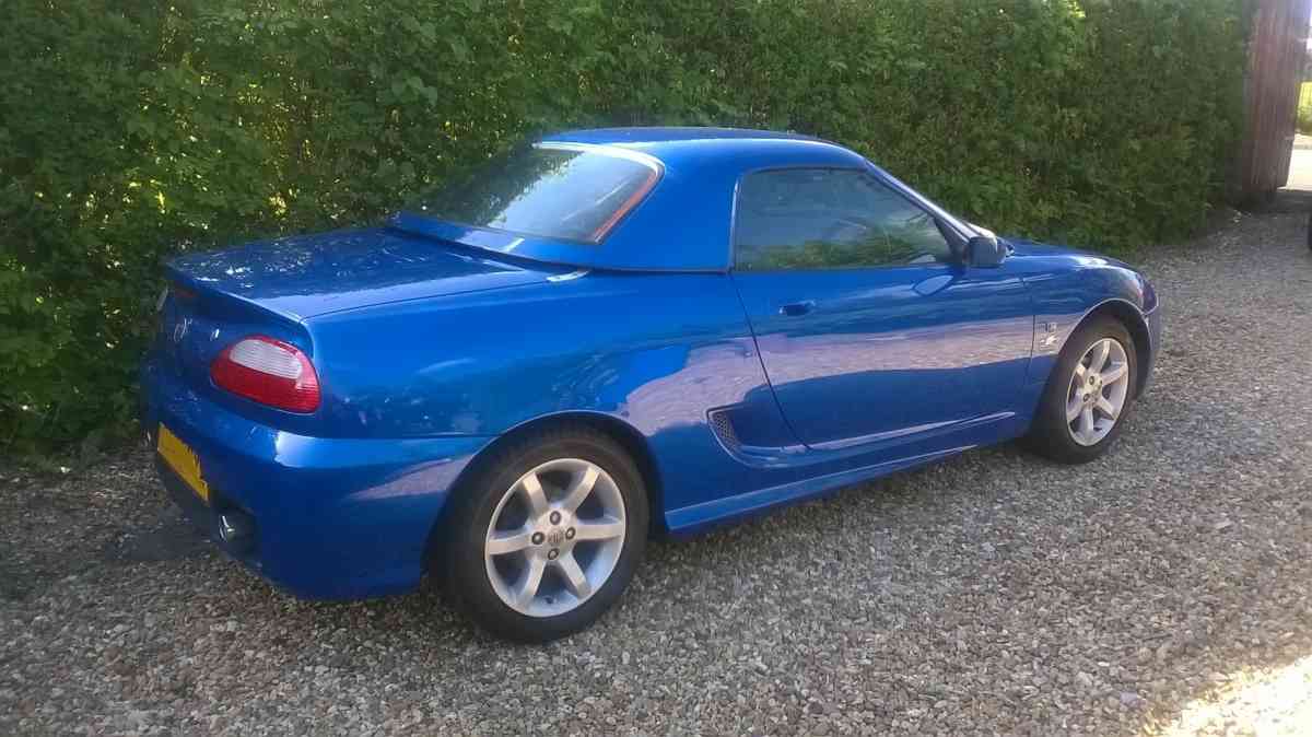

Well lets see,never intended of doing anything today so off we went for a drive in the tf.................nice sunny day.....we went for dinner in the lovely town called uttoxeter......from there travelled to leek via the peak district..................we passed through leek to a little place called Rudyard....... :dry: should have left the hardtop at home

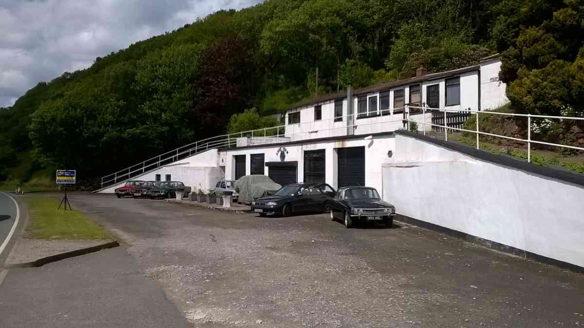

while sitting in the mg looking right there was a old garage property for sale ..the estate agents are graham Watson...was intending on viewing the property online to see if the motors came with it.................no longer used as a garage but a family home with a nice private collection of rover p6 cars v8s and a tc

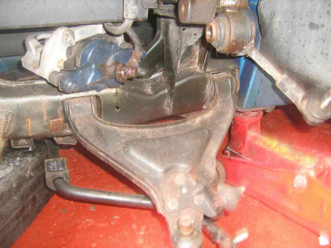

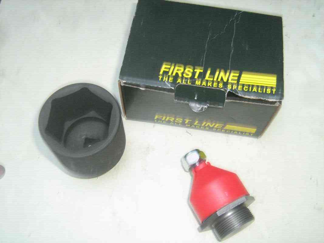

Great had a little break from work.........Gave the mg a checkover.........wheels up in the air tested the road wheels by pushing them left and right.............fine........untill i tested the wheels top to bottom ......felt some movement.....so i lowered the jack till the wheels were 5 inches from the ground and leverd the tyre up and down.....i could feel the clonk and see the movement..........taking the wheel off i could see movement around the top balljoint......The job of replacing the top ball joint is quite easy,as long has you have plenty of tools to hand.
Off i went to my local car shop who had one in stock.......they orderd me the other for next day......although it was only the passenger side with play......i planned to do the otherside aswell...
the large nut on the top balljoint is 46mm.......so you will obviosly need one......the hexagon shape socket is better than the bi hexagon,has theres less chance of rounding the nut off.........the shaft of the ball joint has a hole for a allen key to stop the balljoint spinning has you undo the nut.......becareful not to bash the end of the thread with a hammer........this will mushroom the shaft and may it hard to remove nut.......clean threads and a little wd40....ok
The torque setting for the 46mm balljoint nut to hub is 105nm.............the small upper ball nut is 54nm............satisfied when the job was done.......went out for a drive in the sun.

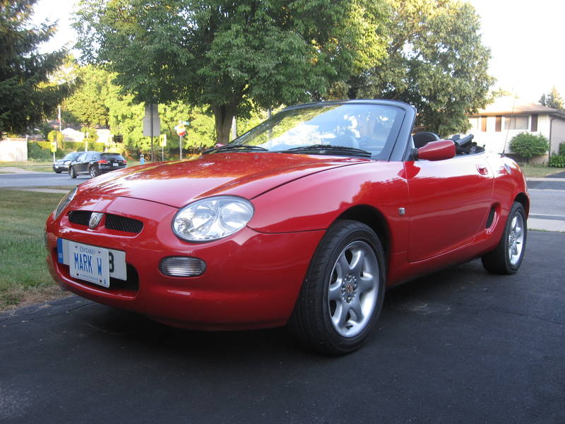

Bought a second F just over a week ago. It failed our equivalent of it's MOT, needed a frontwheel bearing and an rear upper ball joint, both an easy fix. With that sorted it's time to put the miles on.
It's an early F, number 59 off the line. Its quite original except for the silly, fake rollhoop and the later cloth seats.
