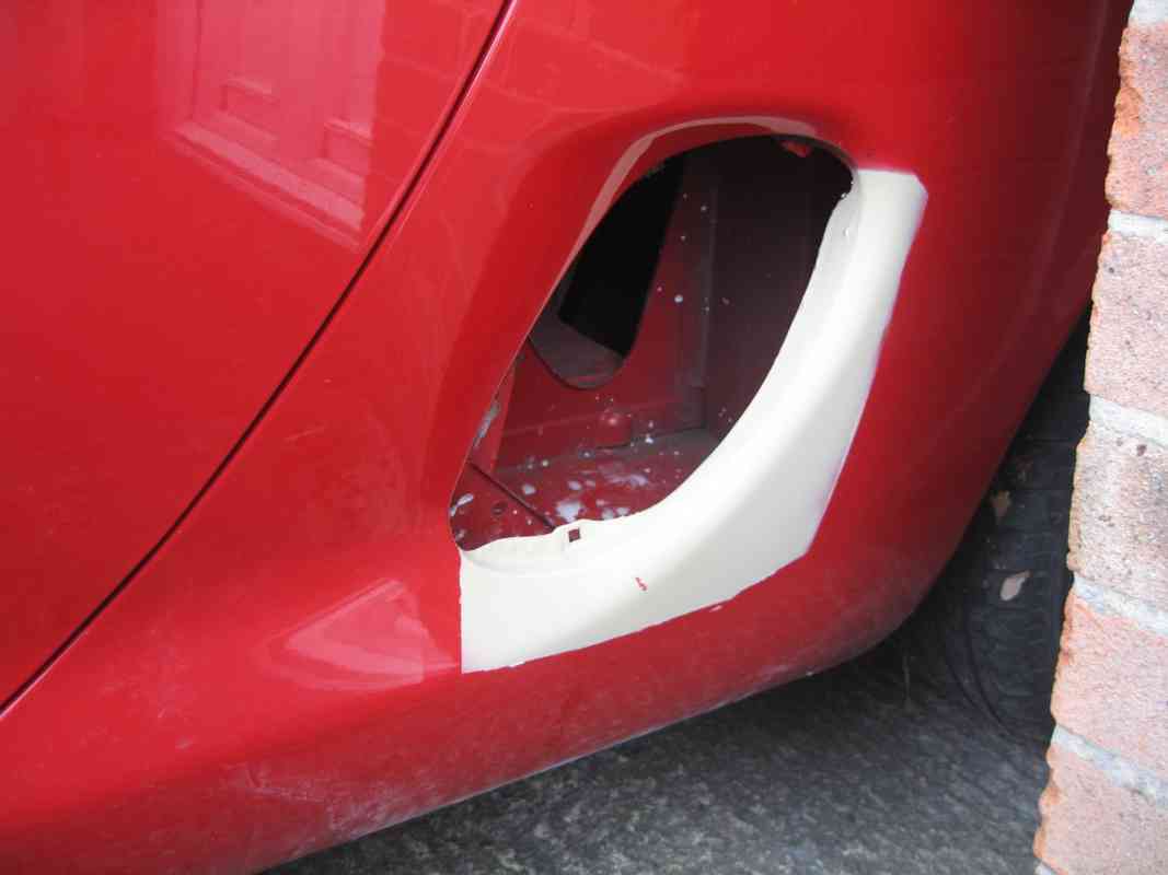

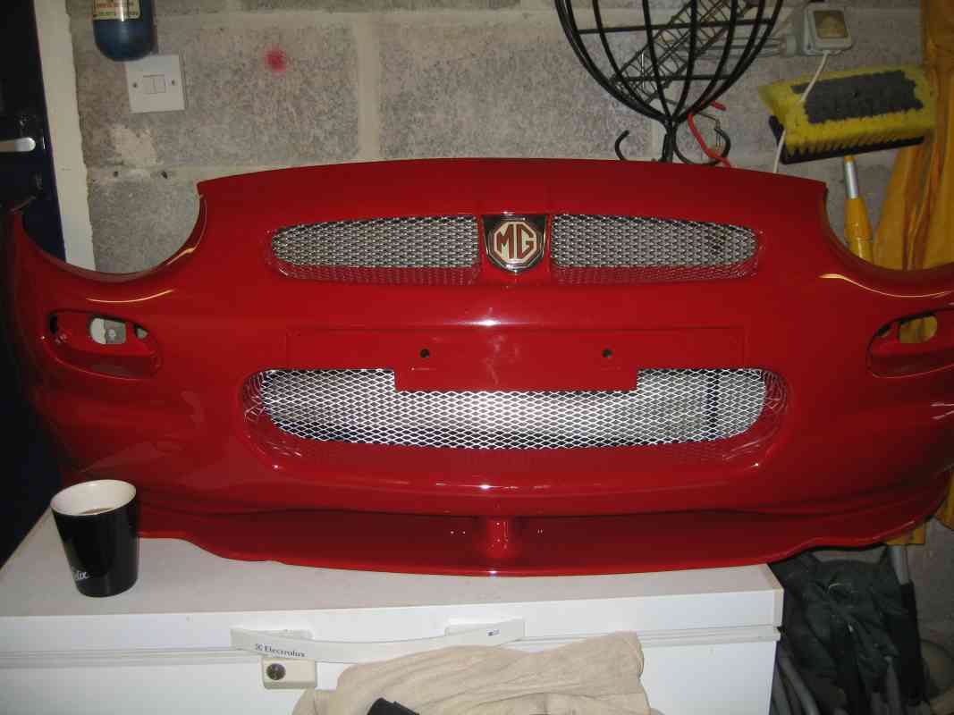

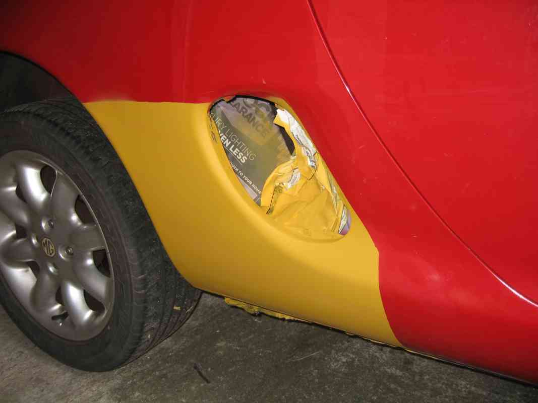

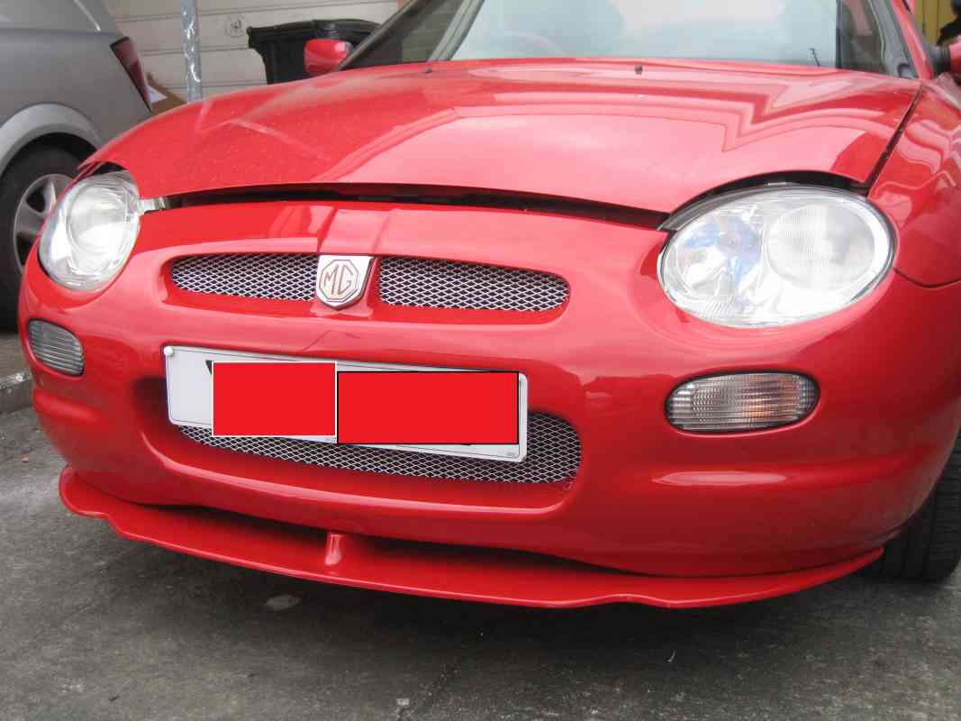

Just a few jobs have been doing over the last few weeks. Had the front bumper resprayed, now hoping to get the air intakes blown in. Its coming together slowly.

Finally got the "little one" back. Had the sides painted and rebuilt the side air intakes. When I bought the car, the intake covers were fitted in with silicone, with nothing behind them. Why, I don't know. Having found and purchased the intake ducts and retainers, fitted them today. Now just the interior and hood to clean and polish and she should be looking great.

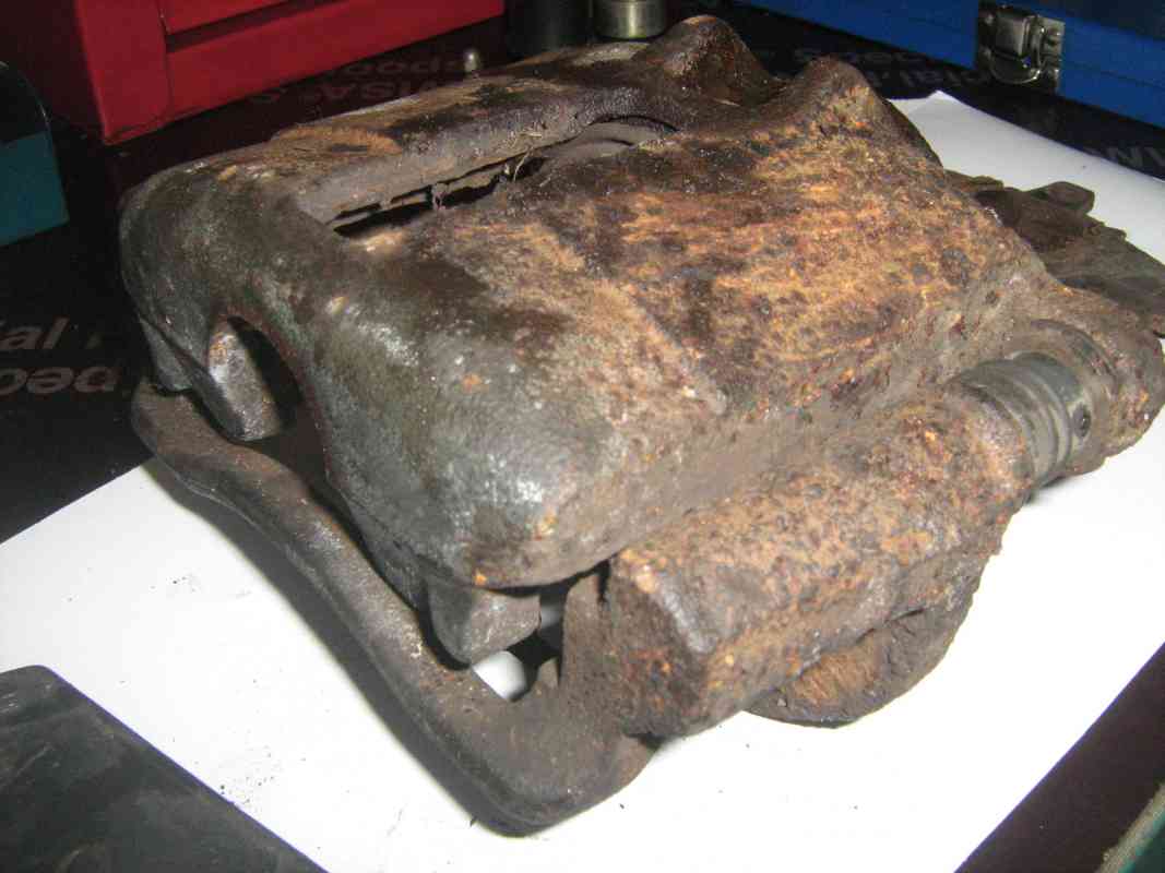

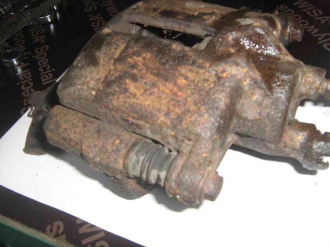

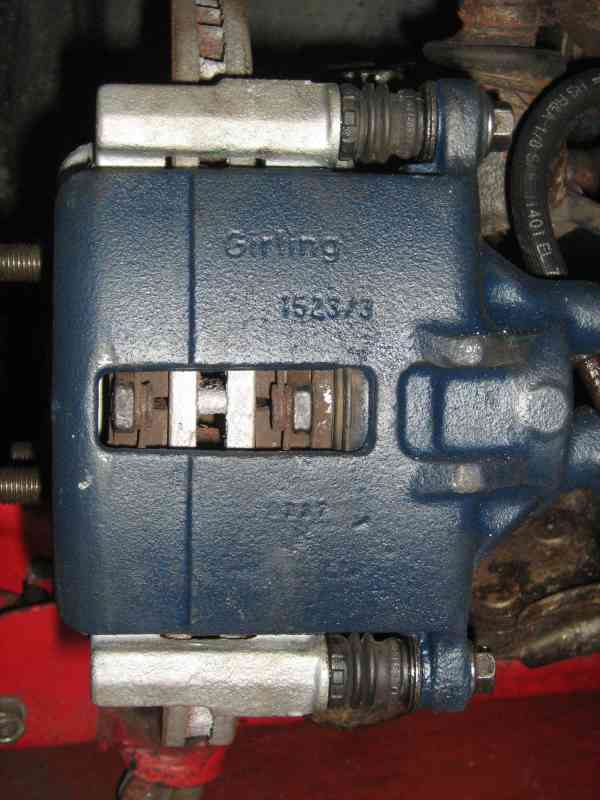

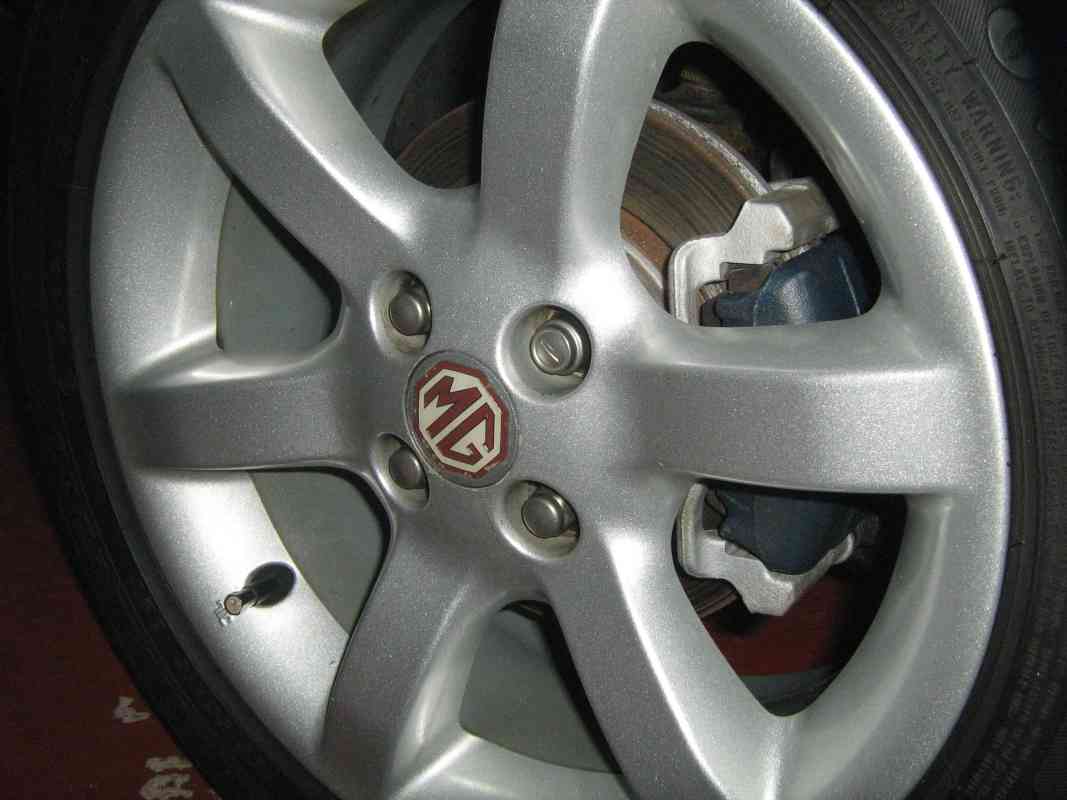

:P GIRLING BRAKE CALIPER CLEAN UP :bust:
Had a look at the brakes this week......well no issue when parked up for winter spell since October......but anyway stripped front calipers and gave them a good clean............on first appearance looked quite rusty.....theres no point polishing those alloy wheels when you can see rusty calipers peering through,,,a waste to replace with newer calipers ,so posh up the ones yer got :dry:
after dismantling and cleaning I painted them blue to match the mg
Then the brakes were bled using a one man blead kit.......simple and cheap......and some new fluid
the finished item was worth the effort looking at the calipers through the wheels now show respectable well working brakes that did not cost a fortune :P
after I finished this labour of love I went back into the house where others were taking it very easy indeed :yesnod:

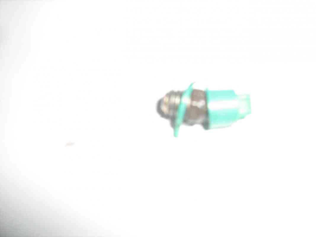

Posted 11 years 3 months ago #157762

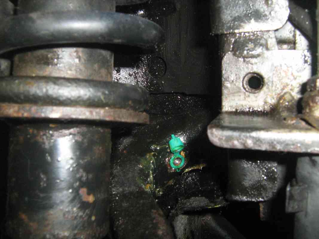

So off came the wheels to clean the brakes on my tf......good time to grease your nipples......the ones on your suspension I mean. :yesnod:
.......removed a little bit of dirt using degreaser around the nipple..........then removed and cleaned the grease nipple on refitting I attached a grease nipple protection cap to keep it clean along with a good squirt of grease..job done :clap:
Last Edit:11 years 3 months ago by mgtfbluestreak
