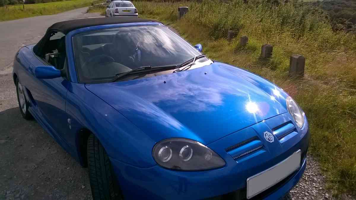

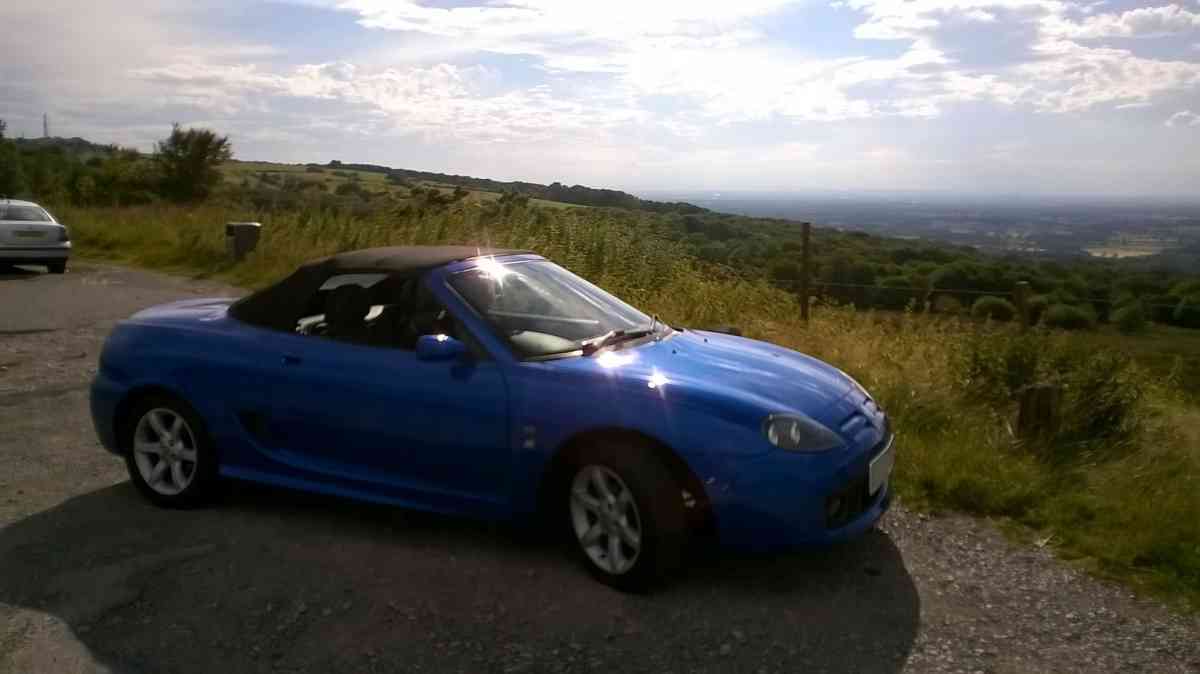

nothing to do on the tf today so about 3.00pm went for a spin in the country.......did 60 mile round trip.............stopped off to take a few pictures near mow cop..............overlooking the cheshire plains....

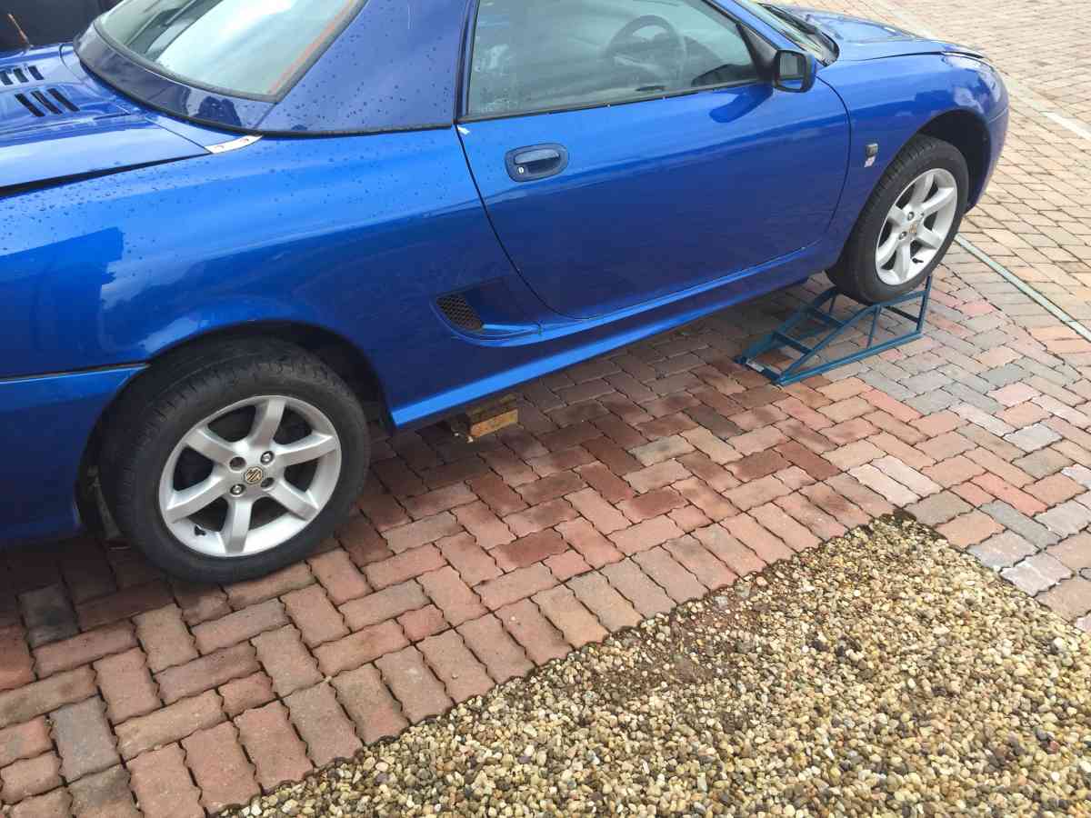

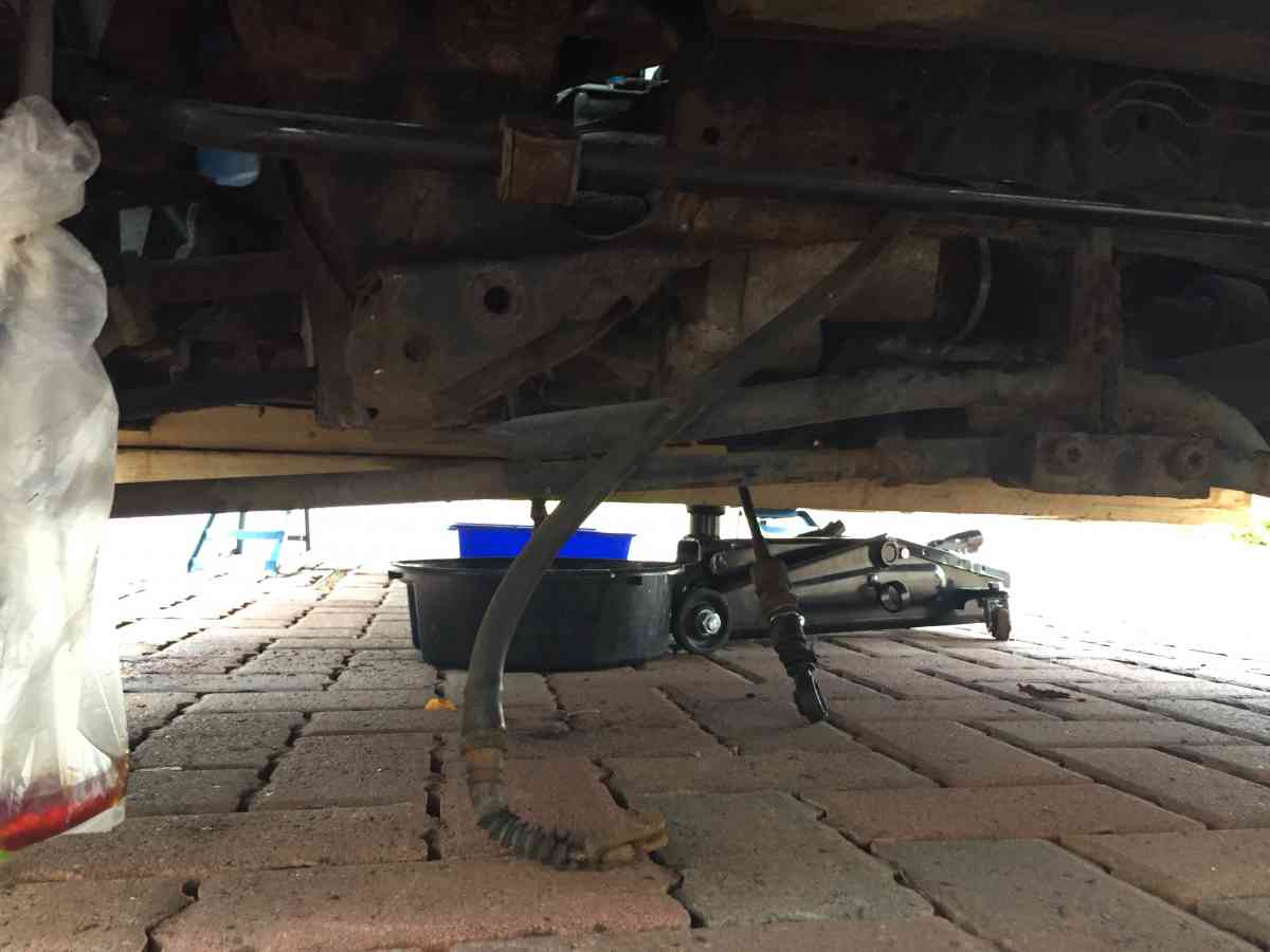

Working on my new project. Managed a couple of hours before it rained.
Removed back box and cat, broke bolts on anti roll bar mount on rear. Loosened 6 bolts on rear most sub frame mounts, removed right hand exhaust mount after setting fire to it! Spent half an hour heating up a couple if bolts on the front sub frame mounts but they didn't budge. (I just know they are going to break but I'm savouring that pleasure and will enjoy that particular tribulation on Monday or Tuesday. Have prepared the crude carpenter version of CJJ's neat joinery and begun by jacking the car on to axle stands to deal with underside.
Still need to disconnect the quick release pipes into the engine bay and somehow remove the 4 bolts at the front of the rear sub frame. The rear bumper now has 1 broken bolt in the boot and the torx bolts holding the bumper on are proving really stubborn.
I
have a new subframe ready to fit along with other bits and pieces

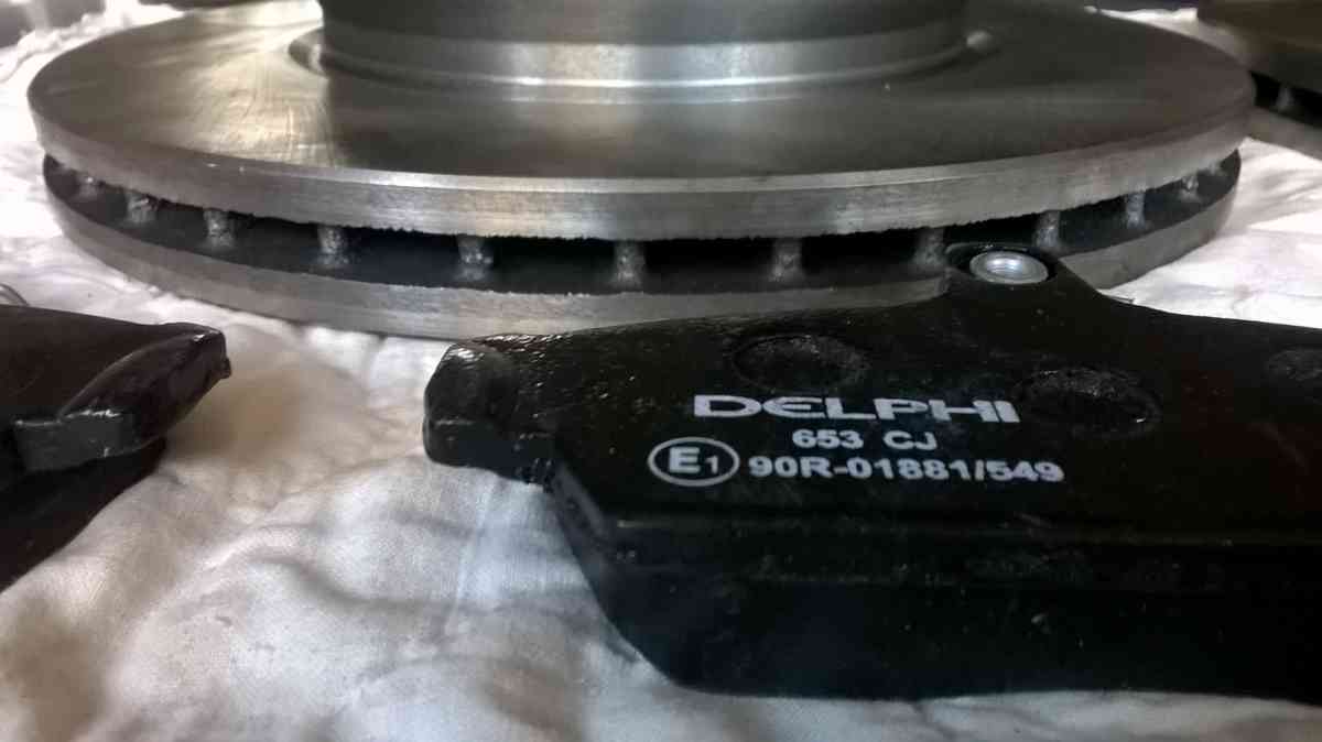

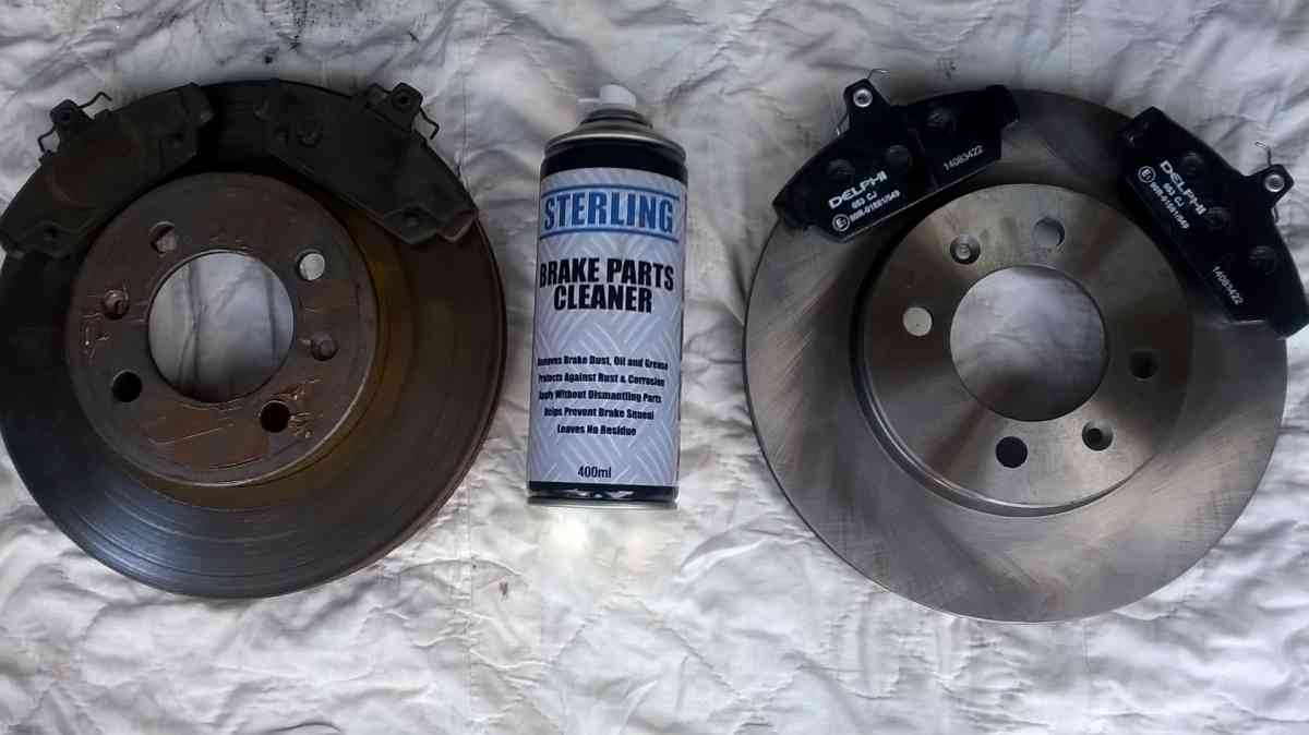

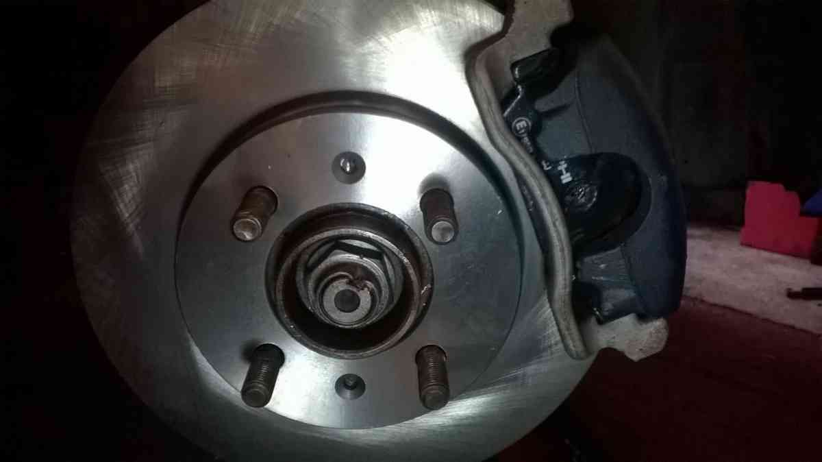

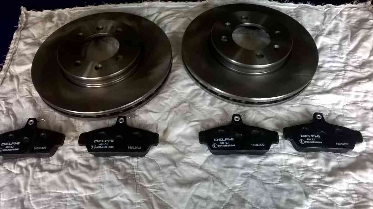

Today i decided to fit some new front discs and pads so here they are standard vented 240mm discs.... :hgf:
out came the brake cleaner to wipe the protective coating from the discs....below comparing the old with the new.

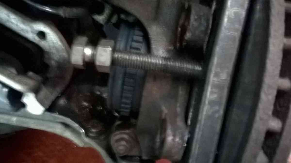

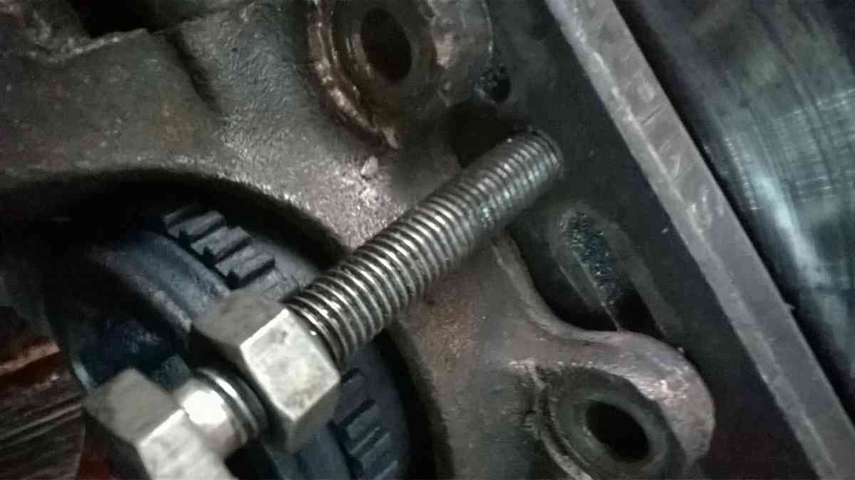

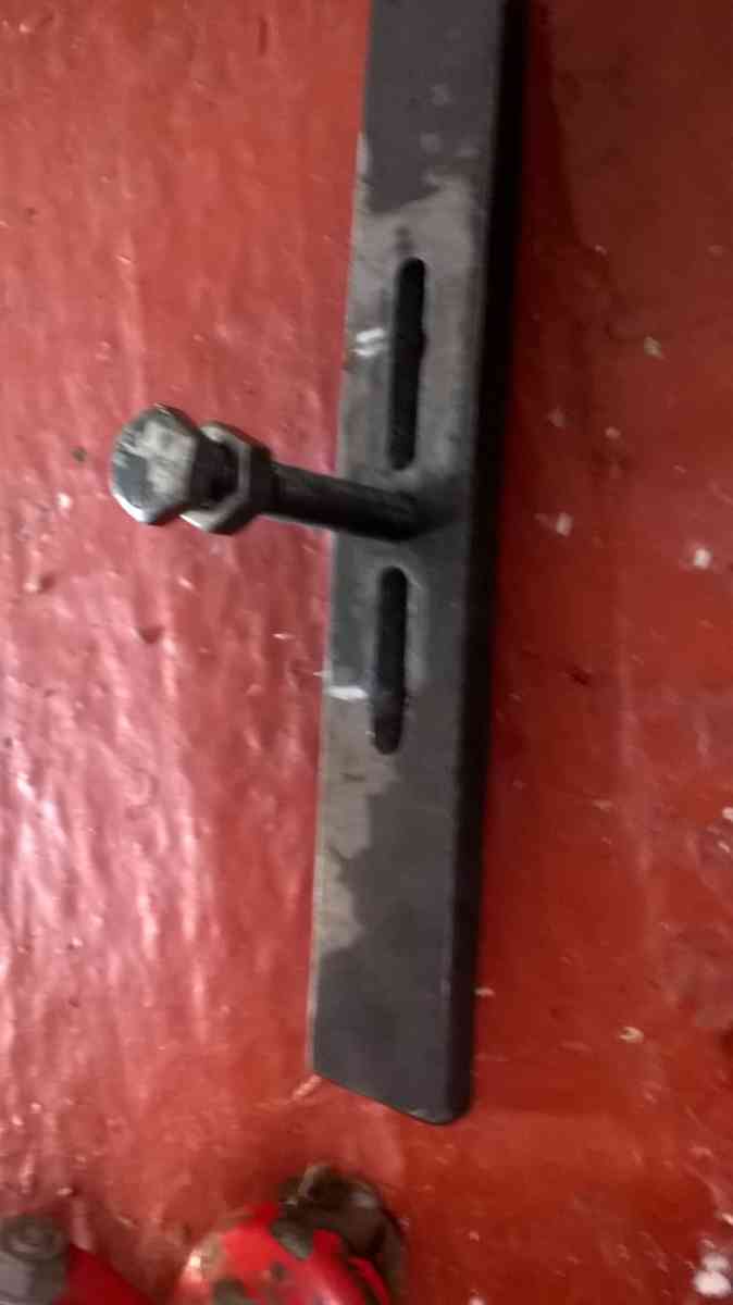

It isnt all plain sailing when fitting your discs...more often than not there rusted on solid....ive seen the posts for removing solid discs.But by luck i had a tool that could remove solid discs in seconds......it was a puller i made for removing gears from diesel engine fuel pumps.....below is the tool.
it is basically a strip of metal with a hole drilled and tapped in the middle to accept a bolt.the metal strip fits snugly between the disc and the metal area drilled to accept the caliper bolts.

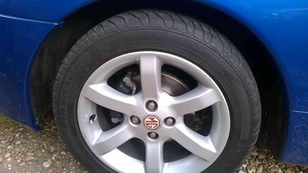

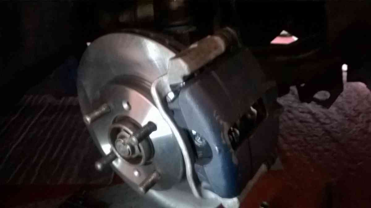

The tool spreads the load and makes it a doddle to remove discs.......the bolt easily pushes the disc away and does not push on the braking face.....the bolt pushes inside the disc.....which means no damage to the face of the disc if you wish to use them again..Awire wheel on a drill was used to clean the hub after removal......retaining screws to be drilled out of the hub at a later date has id promised to take her in doors out for a topless cruise around derbyshire.......although the retaining screws were broken off in the hub by owner unknown....i made sure to place the disc on with the holes in line because a tiny raised area of a broken screw would of offset the disc if id fitted it any how.....on..with the wheels........test drive ok ....cruise here i come....
