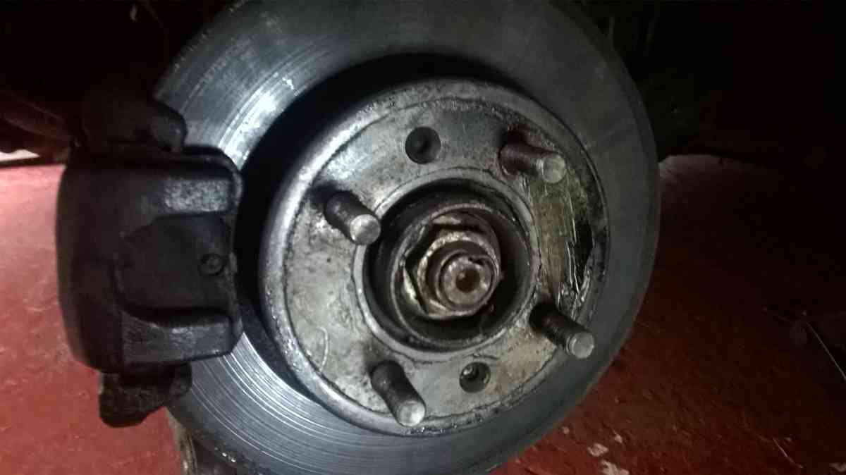

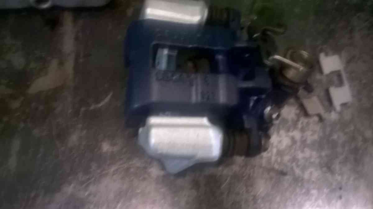

so the mot in october is getting closer by the minute..........new brakes and pads were fitted to the front a while back with cleaned up calipers..............now its time for the back......noticed the decreased breaking power and looking at the condition of the rear disc.......the caliper has siezed.....
so off they came ready for the new parts.......and a caliper clean up :hgf: :hgf:

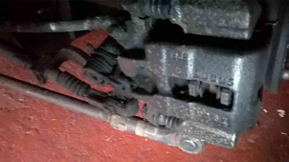

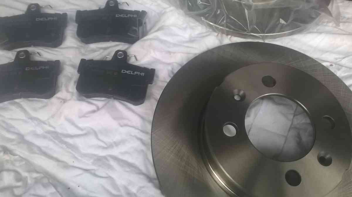

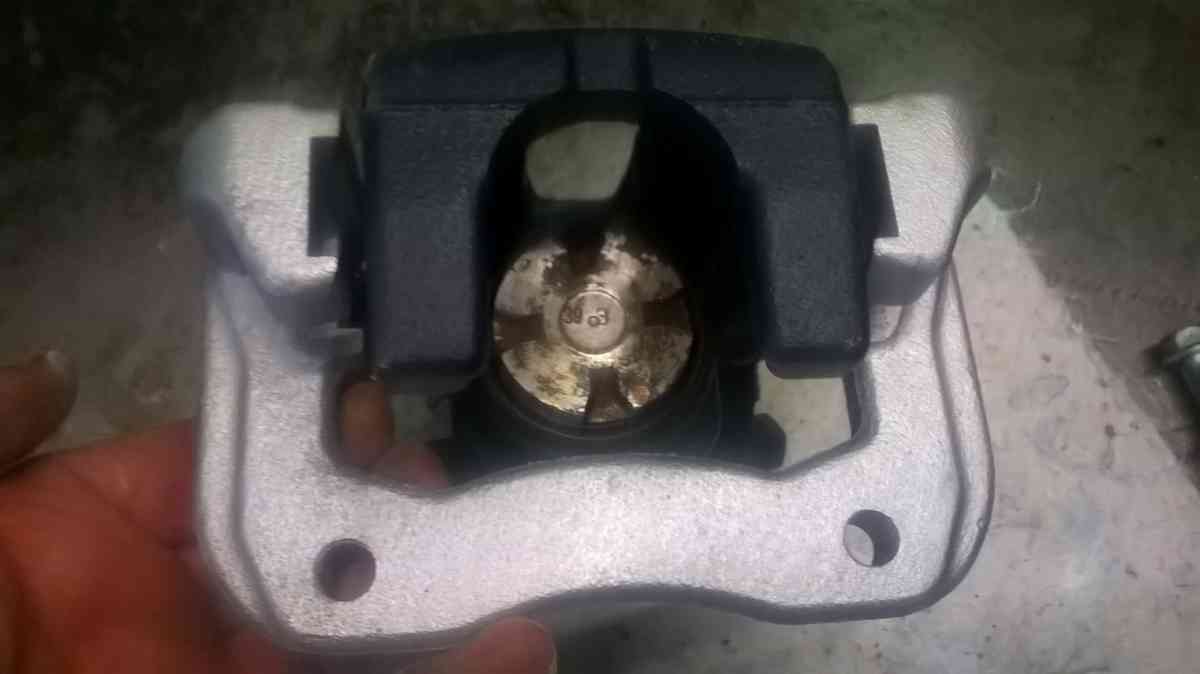

Today i bought the discs and pads for the rear and cleaned up those dirty calipers......
:P pictured below-the new delphi discs and pads :P

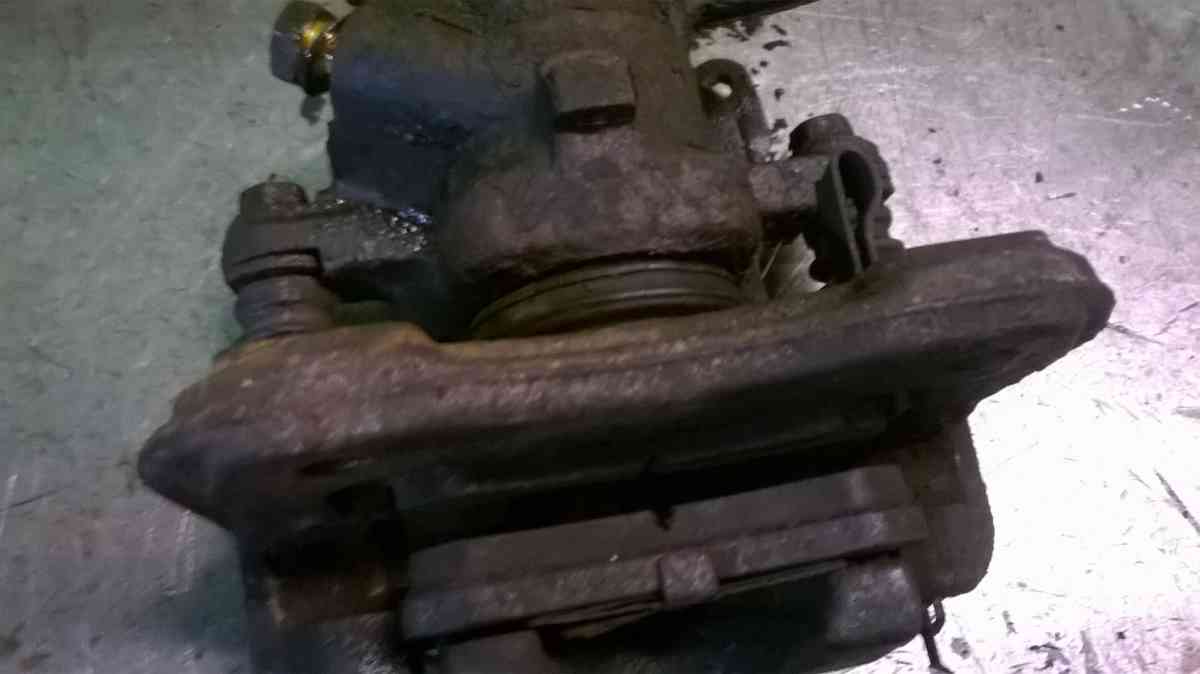

:P pictured below the condition of one old caliper :P

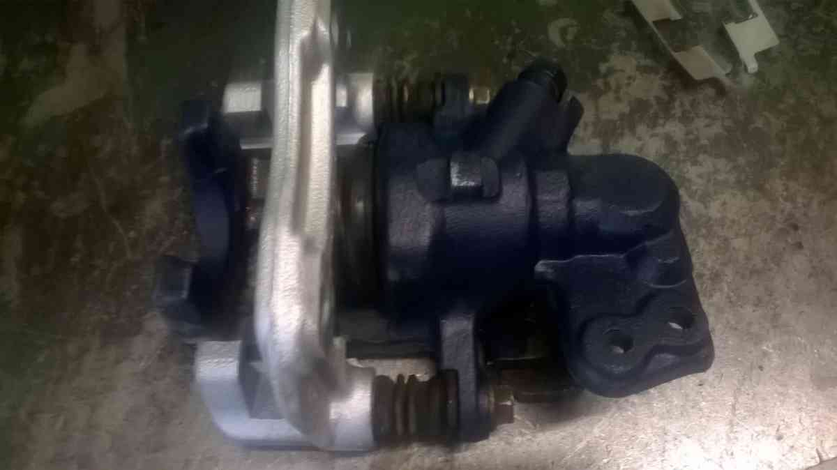

:P And below shows the caliper after a good scrub up and paint before fitting :P
now the only thing to do is fit them.............maybe at the weekend. :broon:

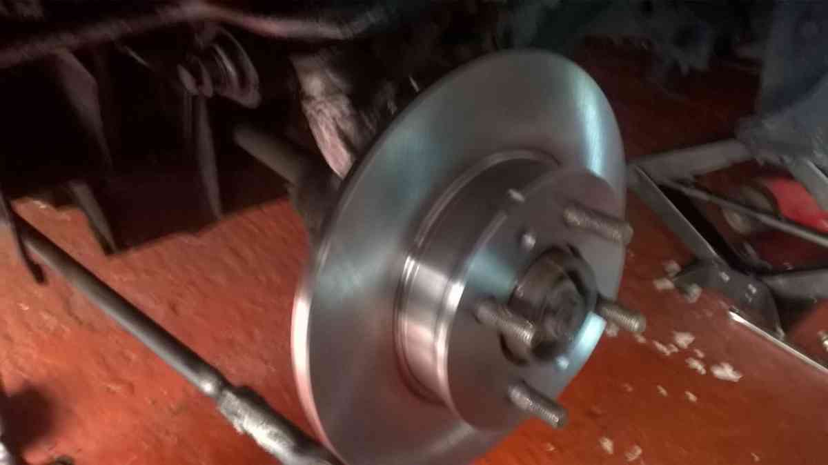

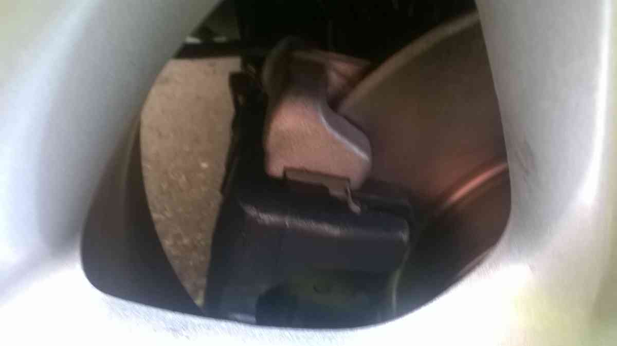

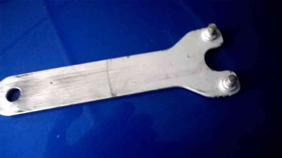

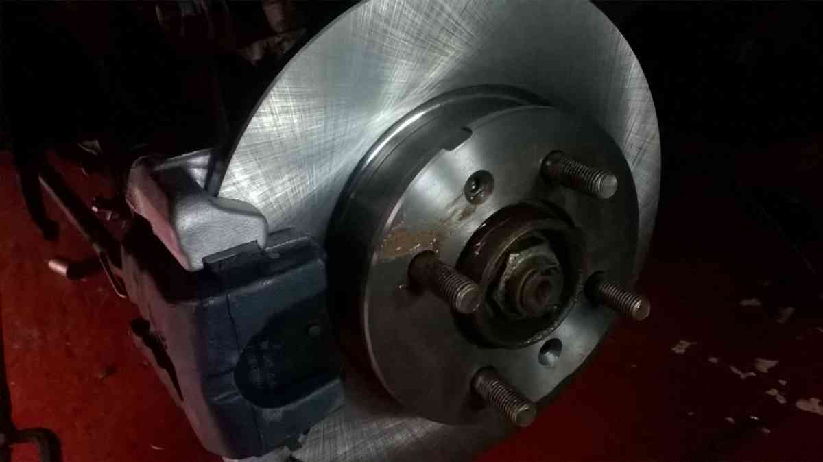

Fitted the discs and calipers today and bled the system............ :P
used this angle grinder spanner to wind back the piston fitted just fine......
and below pictured-a view trough the wheel

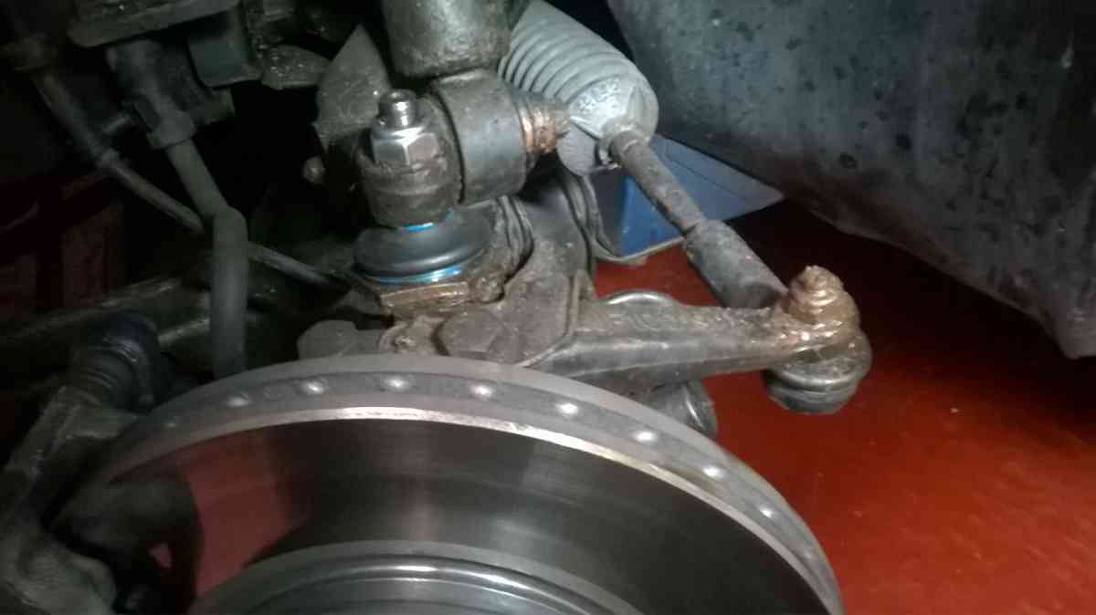

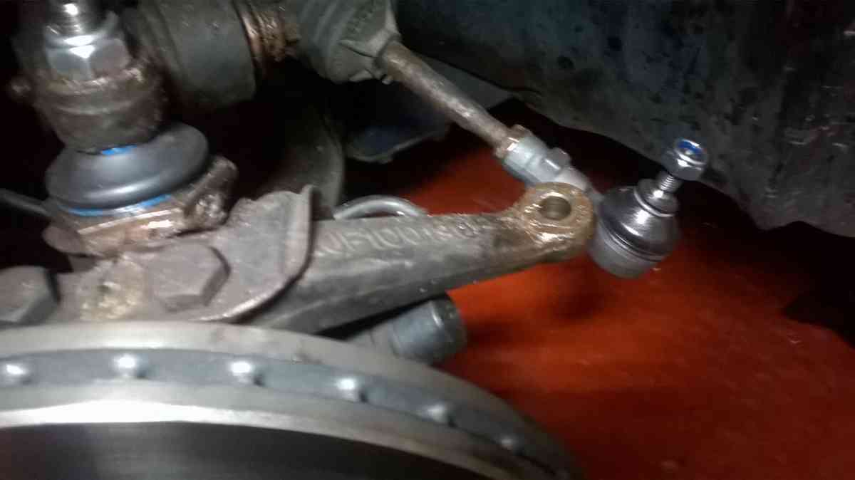

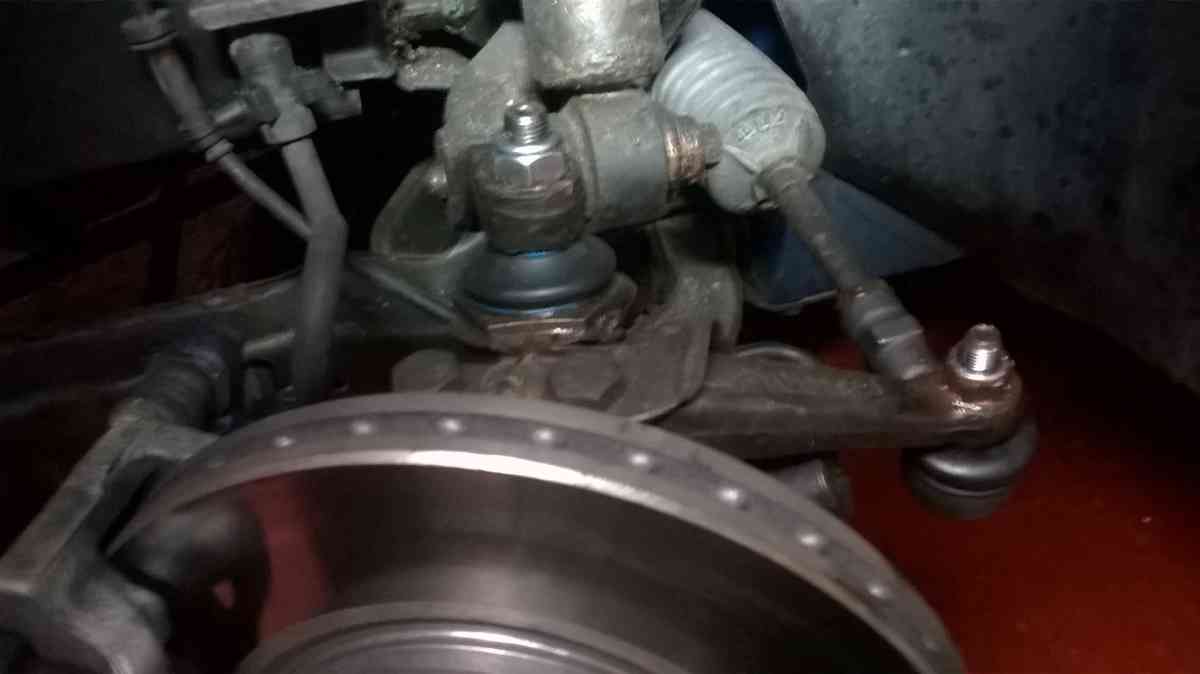

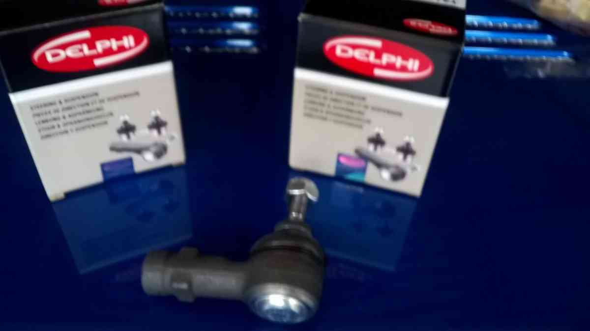

so today i bought 2 new front trackrod ends. :dry:
After dinner i started fitting them with thoughts of gas bottles and stillos..... :coat: ..

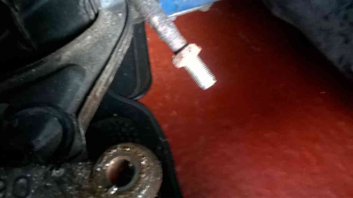

But i was pleasently surprised after undoing the top nut....i aimed my 19mm spanner at the locknut and it undid easy ...wow and now for the big one.......the trackrod end came undone using my fingers only.................... the threads shining like gold :woohoo: :woo2
now just left to fit the new one.: :hgf:
Easy has pie.........one side done in the time it takes to drink a cup of coffee..... :broon: :hgf:
