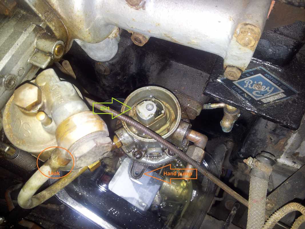

His Riley 1 & 1/2 RME has been going through a restoration which is now in it's 19th year :oops:, but really doesn't much have left to-do. The plan was to recover the roof on a nice warm day, but to-do that we needed to get the car out into the sunshine, only it wouldn't start. It looked like the fuel pump had failed, so off came the air box, to get some access, and the pump was eventually removed and then rebuilt with a kit which had been procured via e-bay. That made it sound easy. But I can tell you it was not. Just finding the right spanners that would fit the nuts and bolts was a length process, and they seem to have employed the "why use to the same size when you can have a selection" method when they originally put it together.
The following picture shows what it was like when I started the strip down having removed the top and the filter mesh.
There is a handle at the front that can be used to prime the carb with fuel (they through of everything back then :broon: )and the built in filter had done it's job of capturing the crud and dirt. I didn't notice at the time but there were signs of a leak in the pipe to the carb float.
Anyway by early afternoon the pump was rebuilt and re-fitted. In doing this, that pipe to the carb fell off. The solder had degraded over the years. So would need re-doing; Well we had some solder, but no flux, 10 minutes later some had been borrowed from a friend. The banjo would need to come of the float bowl but it wasn't playing ball so the top was taken of and went into the vice so I cold apply the necessary force more safely.

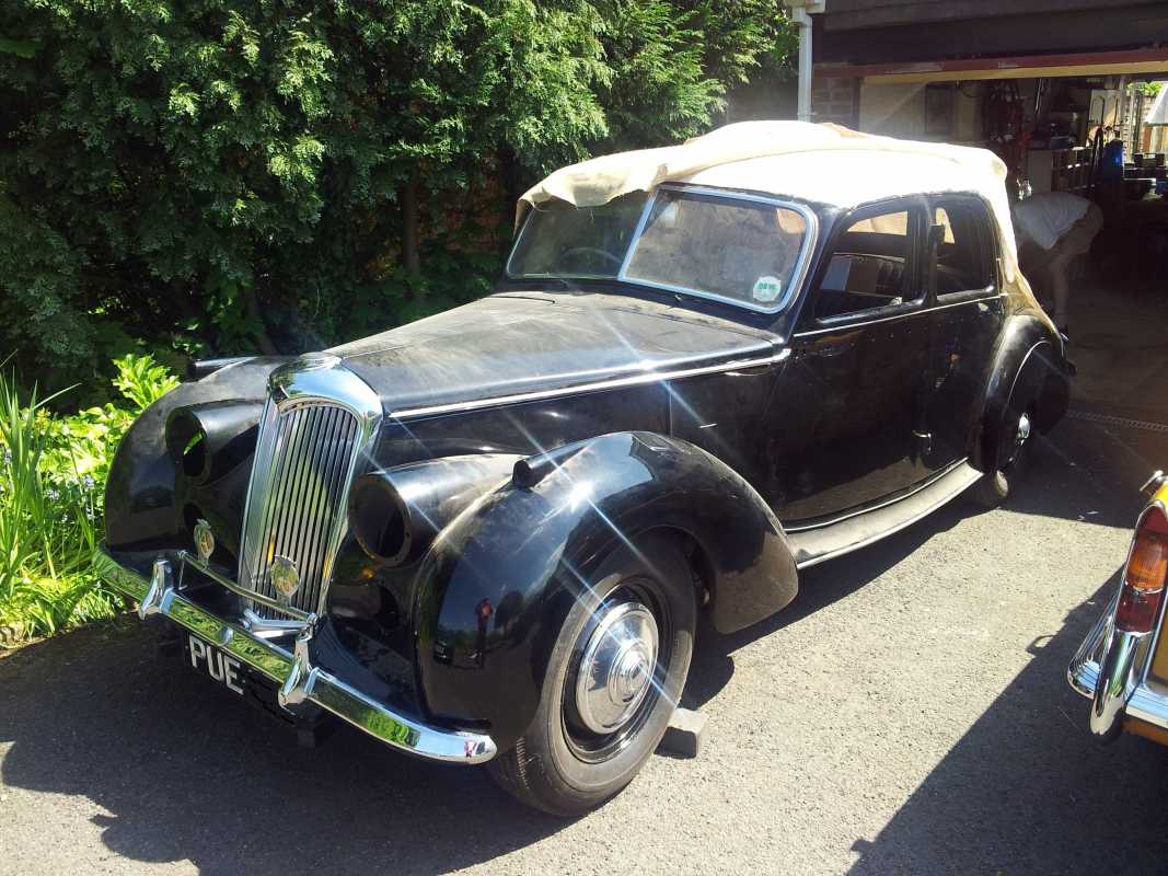

She finally looked like this...
...but it was time for me to go home.
