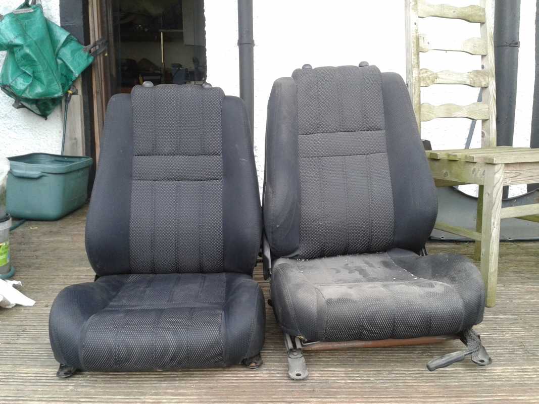

Today I am going to be investigating the possibility of lowering the seats. I'm sick of having to stoop to see under the top of the windscreen surround!
I have a spare set I acquired a while ago and have stripped one down ready for action this morning.
It looks like taking out the sliding mechanism will give a drop of around two inches.
I'll take a few photos along the way. ;)

Posted 12 years 1 month ago #143390
The result of my efforts today

So will your seat be fixed in one position then?

JanCo wrote: So will your seat be fixed in one position then?
Yeah unfortunately, I couldn't retain the slider mechs and get any meaningful drop in height.
It means that I had to measure the position carefully to ensure that if it had to be fixed then at least it was in the right position. :yesnod:
I had to do the same with my Nissan to get a decent sitting position. It's not because of my height (6') but because I have a very long back and consequently sit very tall. If that makes sense.
I have run the fixed seat past my MOT guy, and he tells me that the only stipulation in the MOT is that the seat must be firmly attached to the floor. There's no requirement for it to adjust as some people believe.
The seat is now rebuilt and I am in the process of refitting to the car. This is going to be a mission because, obviously, now you can't slide the seat to expose the bolts!
I decided not to do a HOW TO as the lowering involves a lot of re-engineering(butchering) of the frame and I'm concerned about personal liability if someone attempts it and ends up disappearing on an ejector seat through the windscreen. :omg:

As expected it was a real mission to get my lowered seat bolted into the car. :bang: But it's in and I'm happy with the result :broon: .
