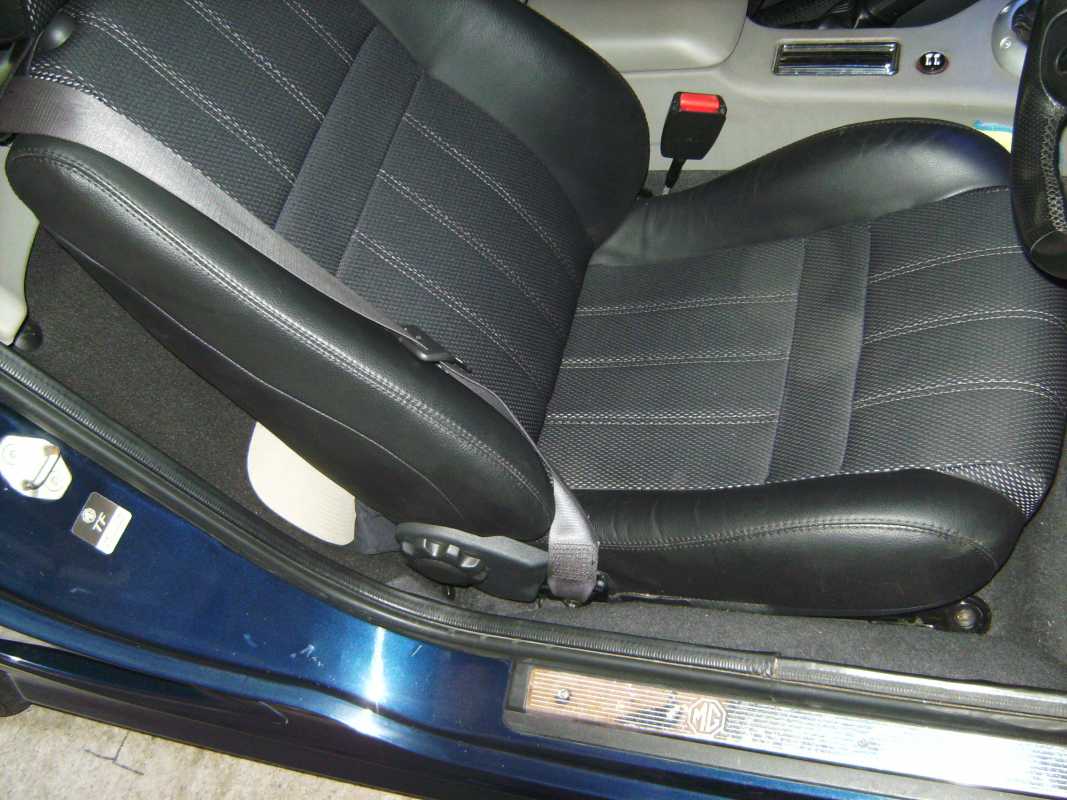

My drivers seat bolster was getting worn plus it had a gash where the door had been shut with the metal part of the seat belt against it; found one in the scrappy with same seats, the drivers side was worse than mine but the passengers was like new. The foams and covers are not handed so a couple of hours later "job done"

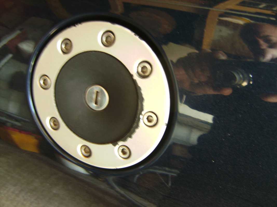

Second job was to tart up the fuel filler cap where the silver paint was coming off; armed with a can of gray primer and a can of silver I striped down the cap and started to rub it down where the paint was chipped. When I got through the paint I got a nice shine on the aluminium (probably Mazac) so removed all the paint and gave it a polish instead. The surface may oxidize but I can always spray it with clear lacquer.

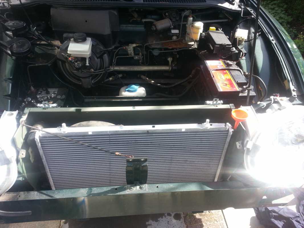

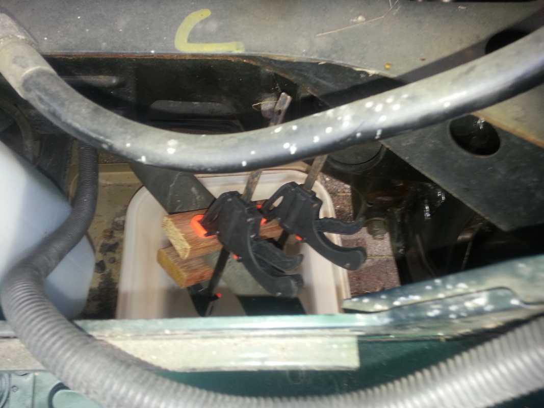

Put a new radiator in. Made use of the trick mentioned in this Forum by pressing the lower coolant tube thight. Needed only a refill of about 1 liter. Bleeding went without a problem. Took almost 1 hour of stationary running before I knew the fan was working. So cooling seems to be good. I'll be using my ODB2 BT connector for checking the cooling curves. Job done in appr. 2 hours.

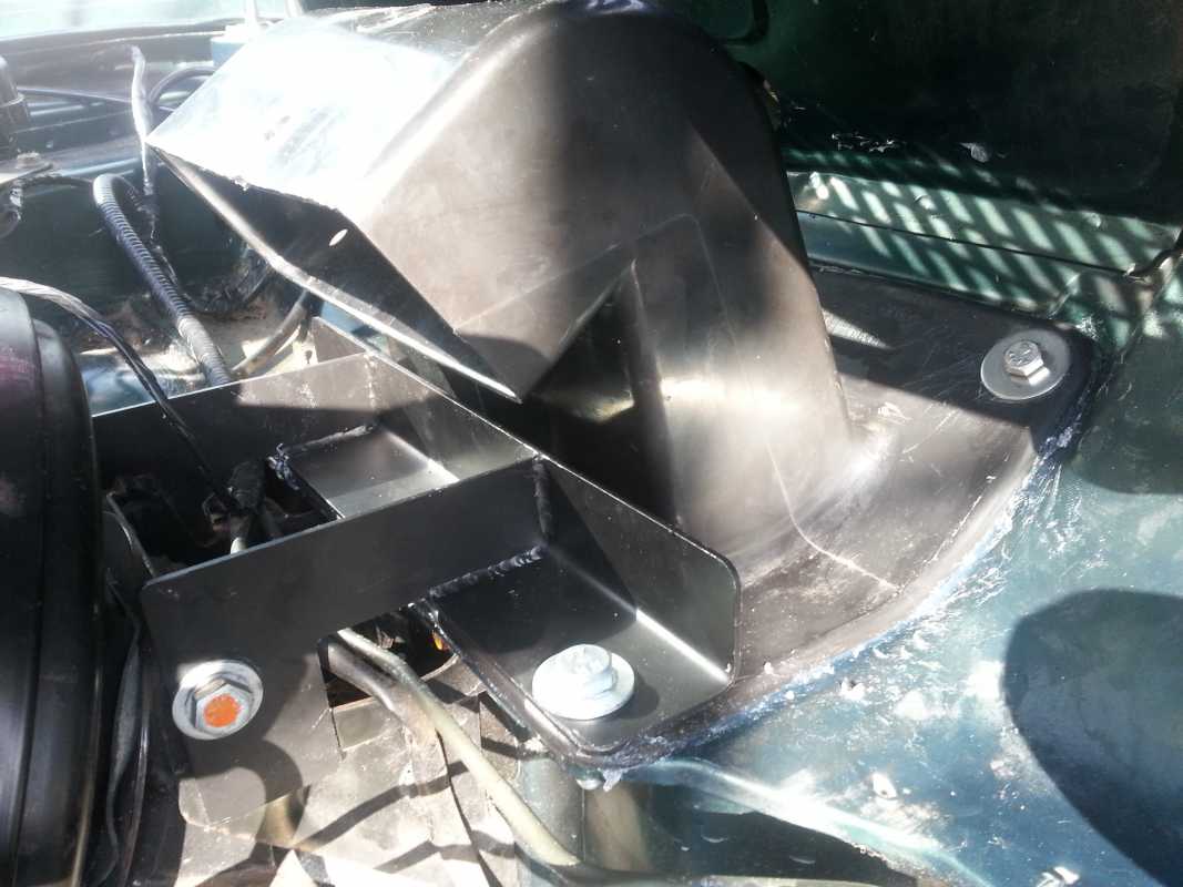

While checking cooling I went on with replacing the heater airbox for a TF style. Took 5 minutes to 'saw' the old one out. Took a lot more for getting the new one in because of a small LHD/RHD problem and because the bolts are hard to reach and tighten.
