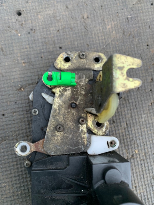

Thanks again for all input and help.
I’ve completely removed the lock. There are signs of corrosion that I can treat but I’m still worried the solenoid isn’t strong enough any more and was actively stopping the unlock position. I’m tempted to sneak a new one past the wife and change it completely. I most certainly don’t want to go through this again!

Looks like it needs some lubrication, but well done for getting it unlocked.

I know this is pretty obvious but I would be leaving the door card off for a while.
Good luck completing the job.

Thanks it was a lot more tricky than I hoped.
Yes I’ll be leaving the card off for a while, even after a lock is fitted! 😀

If in doubt 2nd hand locks aren't expensive from the usual sources.

Even new the locks aren’t too dear but there does seem a shortage for right hand doors on right hand drive cars, ie the driver’s door in the U.K.
I’m off to screwfix for lithium grease soon and may add some sound deadening bitumen tape to the order, it does ‘sound’ a good idea as detailed in another thread.
