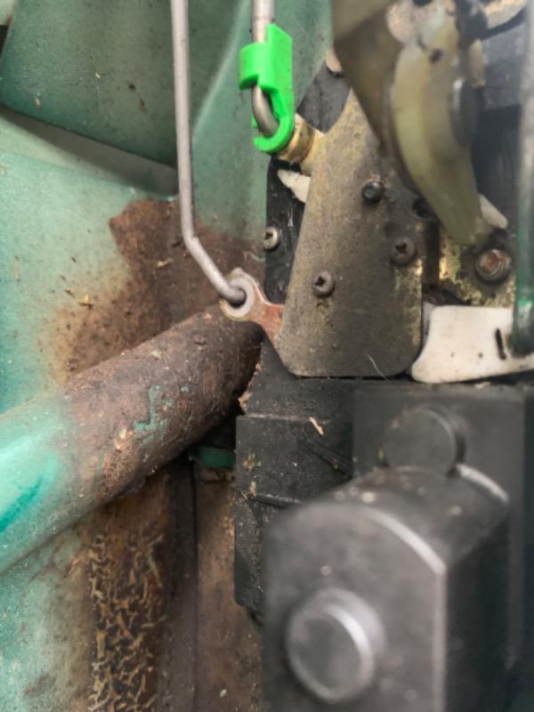

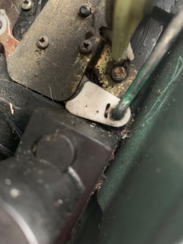

Hallebleedinglujah but it’s open!!!
After removing the trim, I investigated the passenger door unlocking with the button and opening, then tried to replicate it by moving the rods and levers.
In my case it was the white tab (immediately above the solenoid, attached to the button) wasn’t coming up far enough just using the button or remote. If you get what I mean?
So I hooked my ‘lock jemmy’ on to it, pulled firmly upwards then gently pulled the inside door handle. Like and behold the door opened normally!
I’m wondering if the solenoid was stuck somehow and preventing full travel?
Now im wondering what to do to prevent it happening again?
Replied by Uncle Nick on topic Locked driver’s door
Posted 1 year 6 months ago #210164
A couple of pics showing the offending tab that needed to be raised further than possible just using the button.
