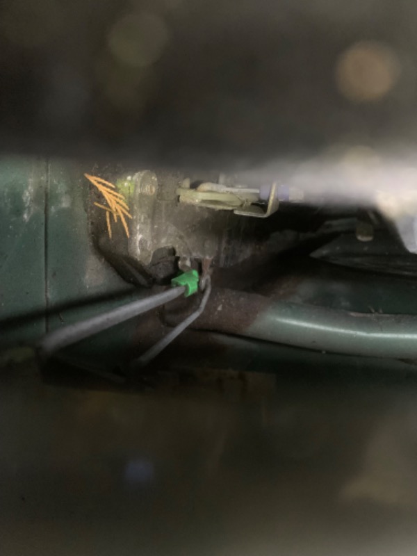

 Hi all, the driver’s door has decided not to open any more. From searches, I’ve found this is a not too uncommon problem plus a couple of ‘how-tos’, except the links to the photos aren’t working. So I’m stuck and appealing for advice.
It’s a 2000 MGF.
So far I’m removed the outer weather trim and can see the various rods on the lock.
When I move the handle, the rod with the green fitting moves downwards slightly.
I'm guessing the other rod is involved to lock the door and I’ve tried pushing it down more (to allow the other rod to move further) but it won’t move.
I don’t see a way to remove the trim on the closed door as it’s held in with two screws on the backward facing edge, or at least the passenger one is and I assume they’re similar.
Can anyone offer any ideas?
A bit more info:
I‘ve continued pushing and pulling on the various rods and it feels as it the rod attached to the button is stuck down, which would explain why it pops up on the fob but immediately goes down again. Is this the deadlock affect?
Thanks.

Replied by Uncle Nick on topic Locked driver’s door
Posted 1 year 7 months ago #210126
Hi, thanks for the welcome.
Yes I’ve tried the key, with the battery connected and disconnected. It doesn’t feel like it’s connected correctly either way.

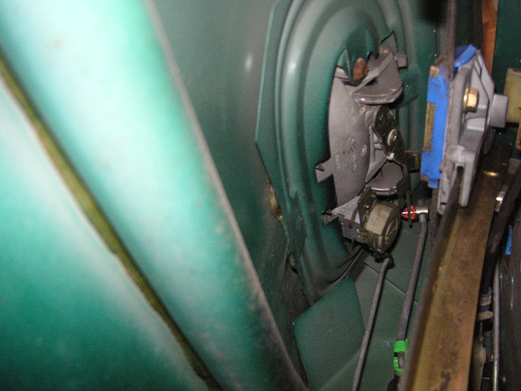

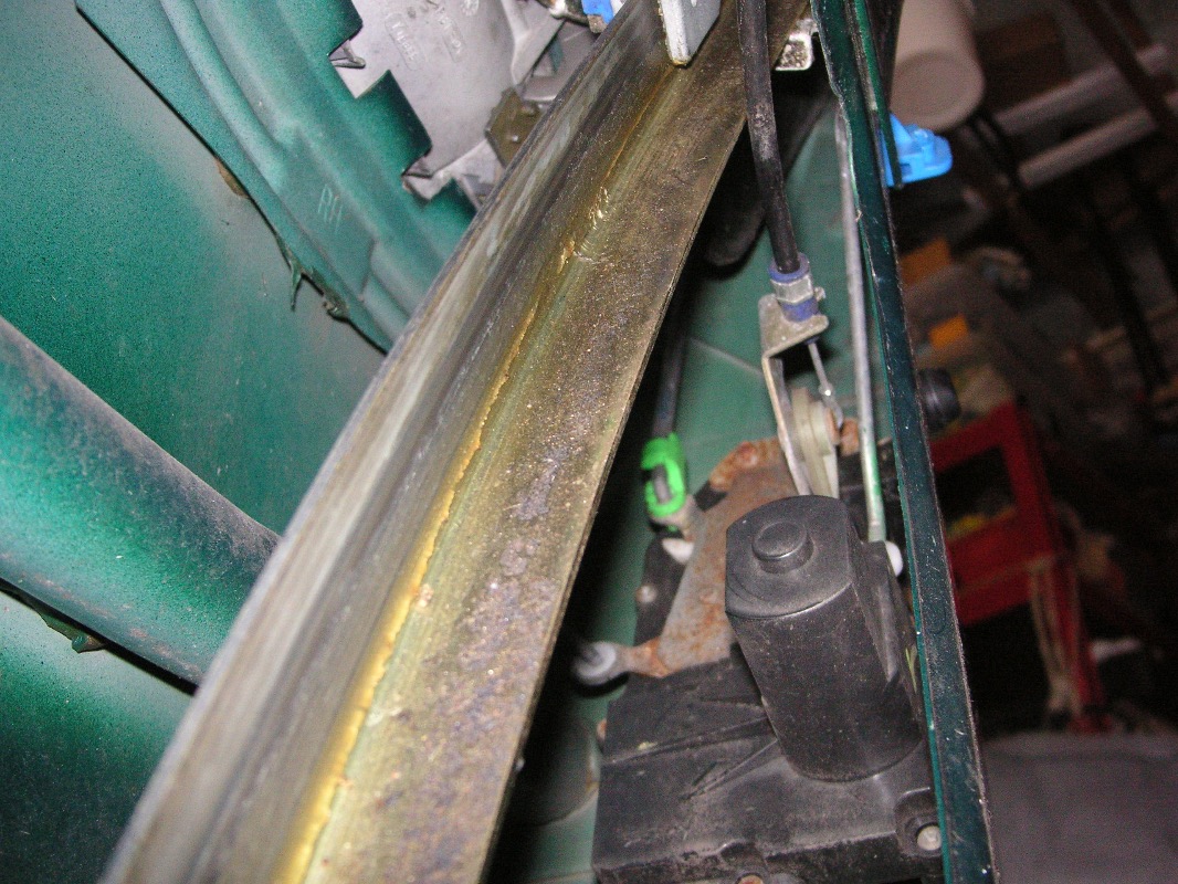

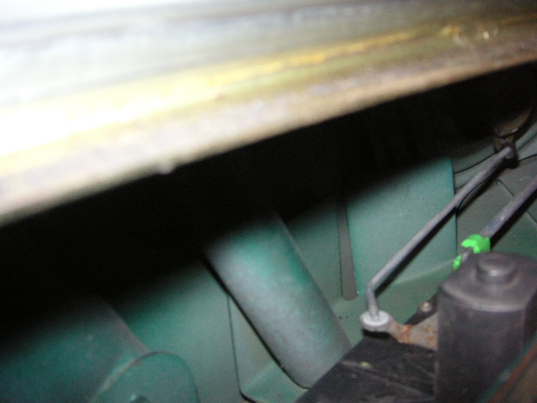

Replied by Delbourt on topic Locked driver’s door
Posted 1 year 7 months ago #210134
Not sure these images help but they might offer a clearer view of the assembled system
The following user(s) said Thank You: Uncle Nick
Replied by TA22GT on topic Locked driver’s door
Posted 1 year 7 months ago #210135
Brilliant pics.
I think it could just be those rods that are in halfway position so it is in deadlock.
I would be pushing and pulling on those with whatever I could get in there.
Good luck.
