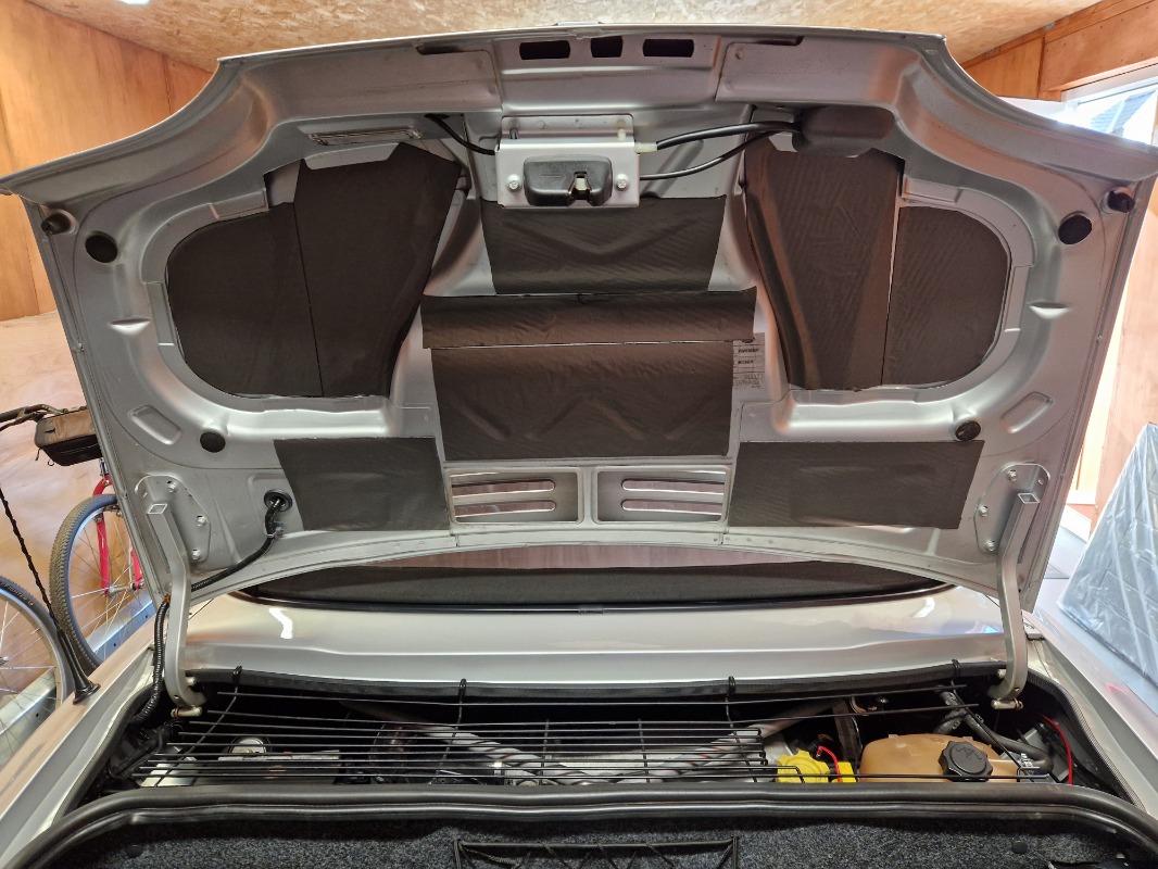

After doing my TF´s boot, I think that what you have to aim for is to insulate the bottom from the exhaust heat. Specially if the heat shield is in a bad state, as usual. The engine bulkhead is also another heat source.
Of course damping the vibrations all over the boot (specially in the lid) and surroundings is a great idea as well, it really makes a difference.
Looking at your pics it seems to me that you do not have the rear lamp protectors fitted, They are really essential.

I agree you are better off fitting tail light covers in the boot to protect the exposed circuit boards form damage by to contents of the boot.

I agree with you both about light protectors.
I had to change a rear tail light bulb and was surprised at how unprotected they were and just asking to be damaged.
I will look out for some.
I did the boot lid last night and I now have a lid that closes with a solid clunk!
It's truly amazing what a few strips of tape can do.
I live in a forest and have a mile and half of bumpy road to travel before I reach the main road and I have really noticed the difference it has made.
Driving my wife's car was always a more pleasant experience as mine rattled and crashed its way down the road but now I can't tell any difference!!

By all means snaffle those spares but that wont stop the problem I had, whenever there was something in the boot it would always seem to knock off the printed circuit boards with the globe holders attached off the tail lights leaving me driving up the road blissfully unaware the I didn't have functioning indicators or brake lights until I'd get a spray of abuse from another driver!
So on my experience you'll still need the covers!
