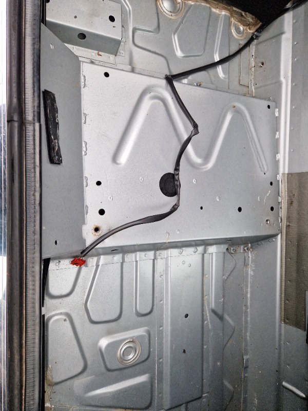

The car is amazingly rust free, in fact I can't believe how lucky I am.
I have BA Phosphate 80 for anything I find and will paint on top of that.
So I take it that under the carpets and underlay the floor is bare metal?
If so anything I put down must help.

I didn't find bare metal..it did have a dusting of paint but not much more than that.

Thanks for your input..when I said bare metal I meant no deadening..I was hoping they would have painted it! 😁

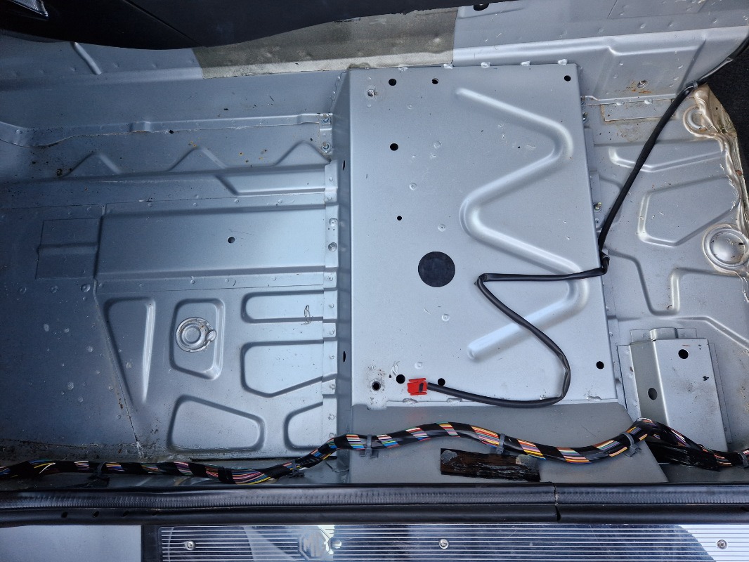

Nice rust free floorpan..but what were they thinking...yes I know...cost.

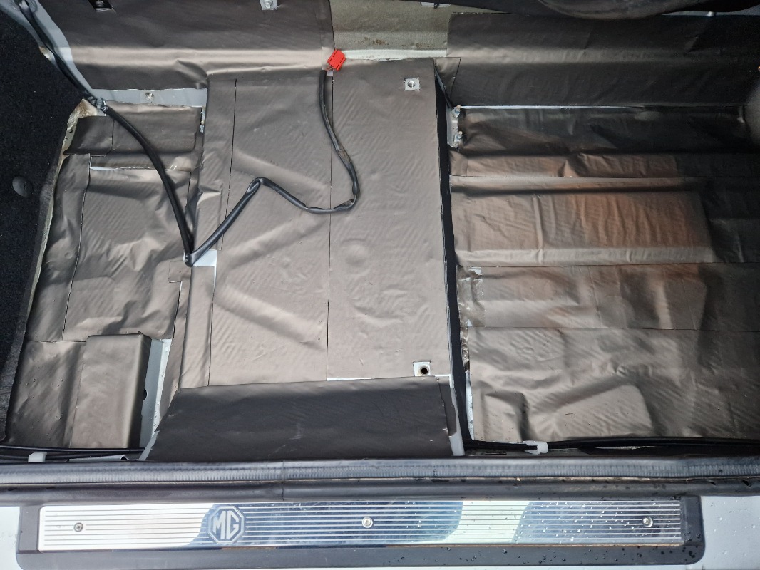

Posted 1 year 7 months ago #209884
Drivers side done and all back together.
This will ride like a Maybach when it's finished.
Passenger side tomorrow...rain and light stopped play.

Passenger floorpan was as clean as the drivers side and free of any sound deadening.
The car is completed as far as this work is concerned.
The difference it has made to the car is staggering. I do not exaggerate.
I bought a pair of tweeters after learning on here that the car was alteady wired for them.
I think I was the first person to remove the door cards as everything looked original. It was then I noticed the lack of sound deadening and the two crash bars against the doorskin. It set me off on this journey.
Total cost for 4 rolls was £66. It has lifted the car in to another league.
Conclusion:
1.The doors are the biggest vibration source. Doing those first and the effect it had on the car spurred me on to do more.
2. The floorpan is next as it is a huge area that is inside the cabin. It has cut down on road noise and it just feels like a better quality of ride as suspension bumps aren't transmitted inside the cabin as much as before.
3. Behind the seats. Covering the tank panel made a difference. Not as big as the first two.
4. The engine cover. It is already covered by the "dead dog" insulation but it did help.
5.Under the bonnet. Not sure if it made any difference. I figured anything in front of the ears must help but can't quantify really.
There was a secondary benefit for me. I have only had the car 2 months and I am getting to know it. Removing the seats, carpet etc. allowed me to see the condition of the car and how it is built. I am definitely the first person to remove the seats and carpet as there was not a mark on any of the fasteners. I now know how the boot/throttle cables are run and the loom too.
I like the car. It will be my last classic build and I will get it how I want it when funds allow but I can't help thinking that anything I do will just make it better...rather than modding it and still having a rattling car!
I encourage others to try it. The car has a very capable chassis and now it's a quiet and enjoyable chassis too.
