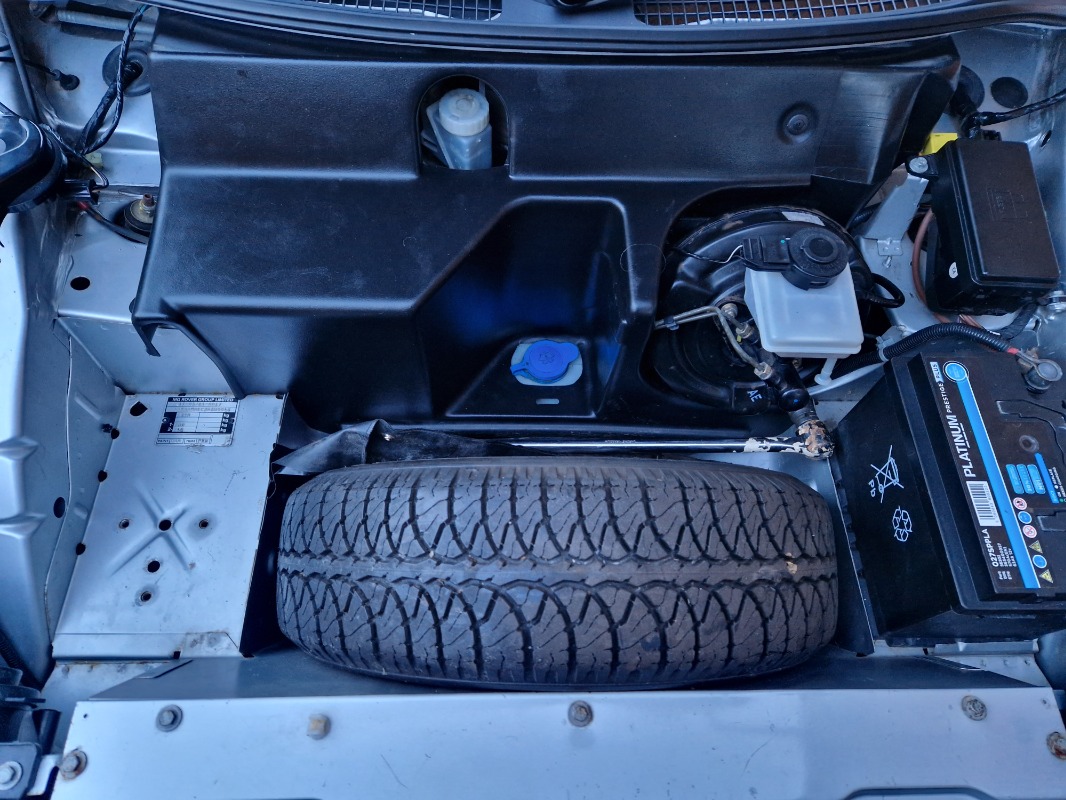

A rather pointless pic but behind that plastic cover and in the wheel well I used up the last of the roll of flashing.
