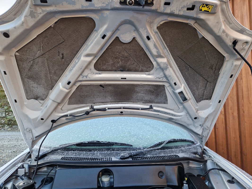

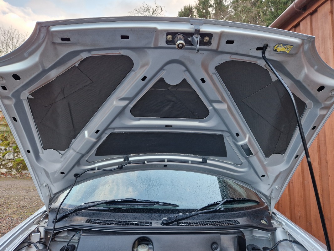

So today I did the engine cover and bonnet.
I covered the whole cover and cut around the bolt holes. It stuck nicely cos I had been out on a run to get another roll of tape.
I filled in the gaps around the bracing under the bonnet as neatly as I could. I will do the boot lid and find places to do with whatever I have left.
Went for a drive afterwards and the car is so different. The suspension is still jiggly but it doesn't set the rest of the car off in sympathy! I lifted the bonnet to see if any had dropped off but it was all intact.
It has transformed the car so I can only imagine how good it would be with the proper stuff.
