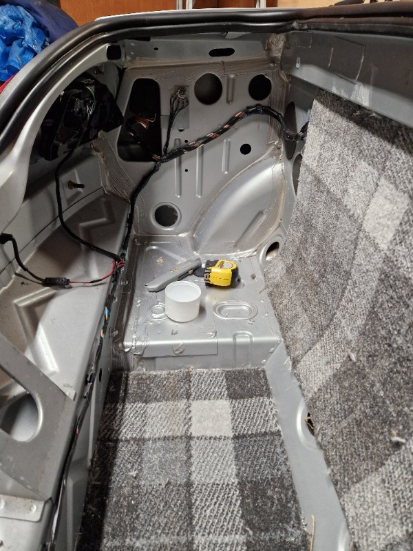

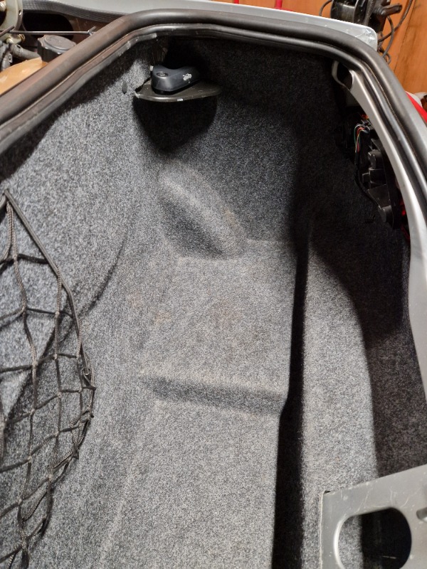

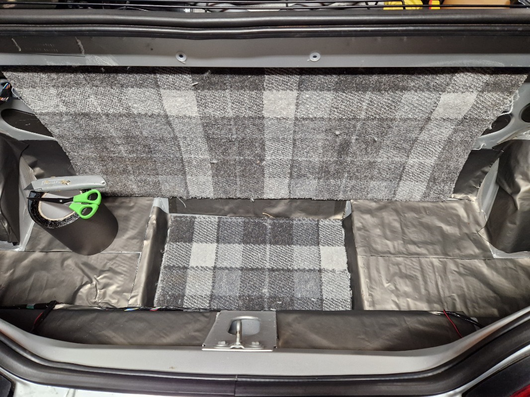

Finally got around to doing the boot. I used some old carpet on the floor and the panel next to the engine bay. For the rest I used the same Bostick flashing tape.
I have enough left to do the boot lid and will maybe do that tomorrow.
The boot floor pan is mint. I am not sure how much I will notice any noise reduction in the cabin with the engine between me and the boot but it can't harm anything.
A road test will tell. Luckily the carpet went back ok.
