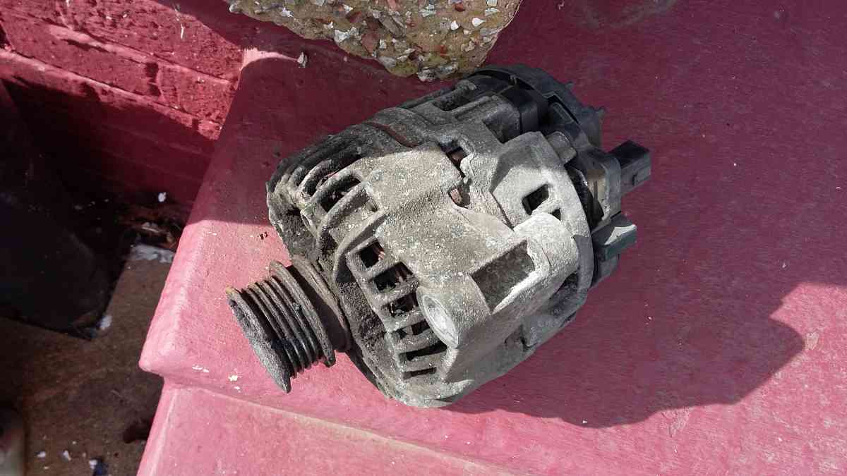

Day 2 Time to check that alternator. Why are there so many bolts holding in the engine cover.And why are 3 off them difficult to reach. ( moan for the day ) yep dam things seized. Replacemental on the way.Now what else can I do while waiting. Service required but will wait until alternator replaced, no point in overheating engine just to drain oil. Oh would you look at that ( look of pure horror on face, and maybe even a tear ) large crack at the bottom of windscreen. That's it, I've had enough for the day.

Postman87 wrote: Day 2 Time to check that alternator. Why are there so many bolts holding in the engine cover.And why are 3 off them difficult to reach. ( moan for the day ) yep dam things seized. Replacemental on the way.Now what else can I do while waiting. Service required but will wait until alternator replaced, no point in overheating engine just to drain oil. Oh would you look at that ( look of pure horror on face, and maybe even a tear ) large crack at the bottom of windscreen. That's it, I've had enough for the day.
I had this on Meg about 6 months before her last MOT ... as she wasn't used on the road at the time. I used a big spanner on the pulley nut to move it, then Sprayed GT85 on the bearing each day and moved a bit, for a few days. Hey presto it loosened up and never seized again!

adamelphick wrote: I had this on Meg about 6 months before her last MOT ... as she wasn't used on the road at the time. I used a big spanner on the pulley nut to move it, then Sprayed GT85 on the bearing each day and moved a bit, for a few days. Hey presto it loosened up and never seized again!
I've had the alternator seize on the F twice, first time we freed it off, second time it was having none of it.

Always worth a try but I think it depends 'where' it has seized. If on the collar where the shaft goes in to the alternator (or at the rear), then you have a chance as this is usually just a build up of rust/aluminum oxide mix... if the actual bearings themselves seize then I think they are sealed and you have no chance..

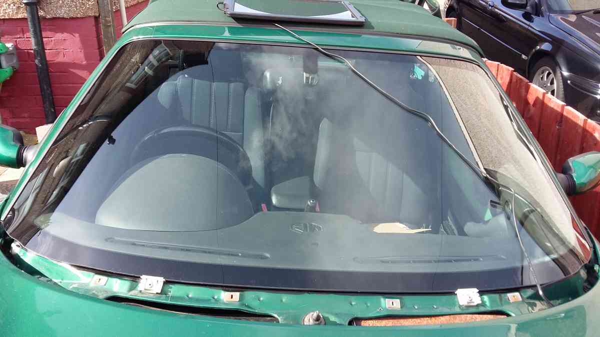

Autoglass arrived to day and fitted a brand new windscreen. My £300 budget to get my TF back on the road after a winter
break has just dropped by £75 ( EXCESS ).

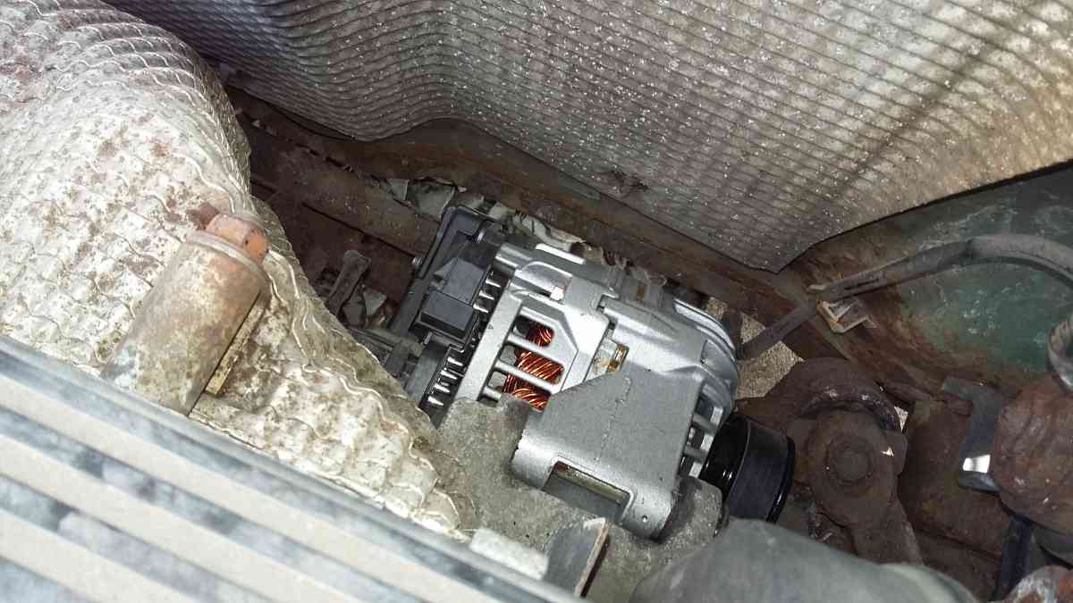

Replacement alternator arrived early so was mostly fitted before the windscreen was fitted. Now fully fitted and runs smooth with no squeal.
