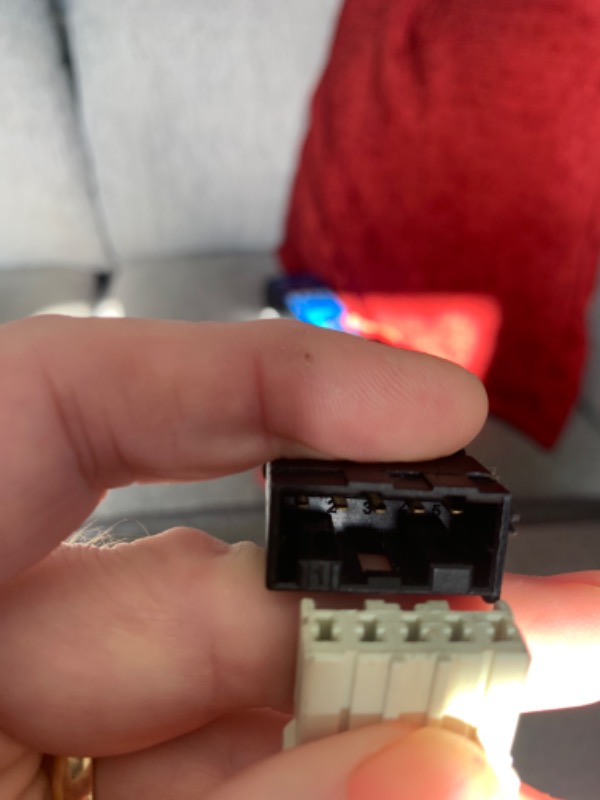

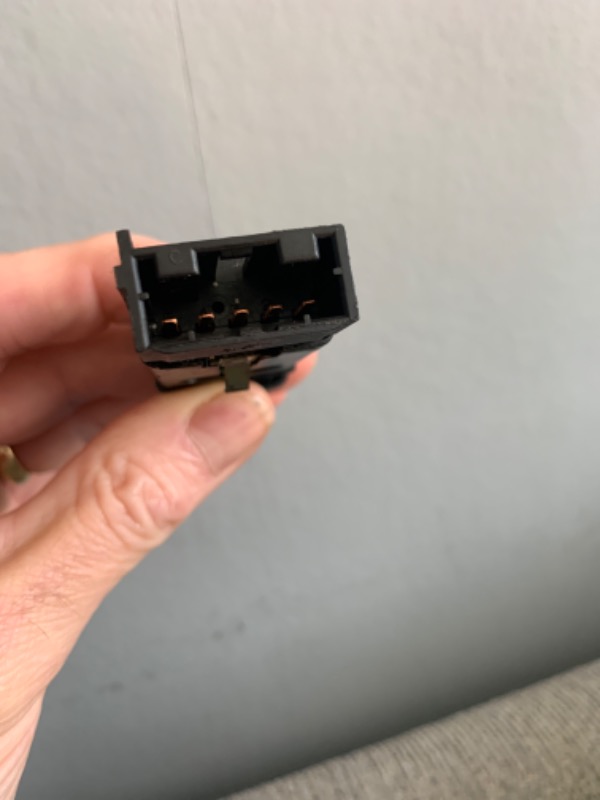

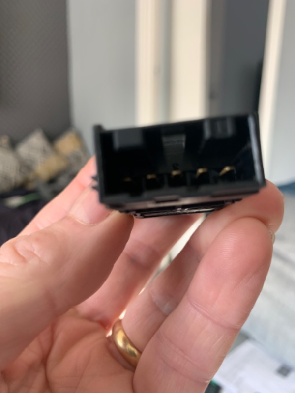

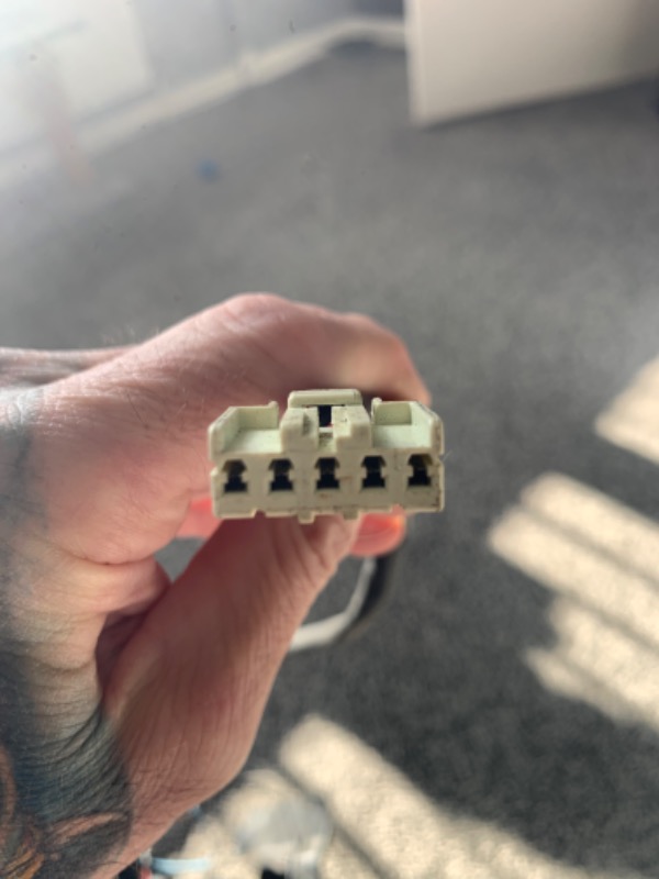

This is the mk1 loom switch connector.
this is the mk1 switch
this is the mk2 switch
the locating grooves don’t match up

Replied by Roverlike on topic MG F/TF Front Fogs - Parts, Wiring Diagram, Installation Guides
Posted 1 year 9 months ago #208561
Ok, I see, but you can remove locating pins on the connector with a cutter or scalpel.
However, my problem is I do not know where these 5 wires are connected in the rest of the loom, so cannot say will it work as expected.
Problem is I am not expecting 5 wires in front fogs switch, and I do not know how that switch behaves. It is possible that some other switch is used and because of that wires are rearranged. In that case you cannot just swap it to front fogs mk2 switch as internals of the switch are different.
I would measure with multimeter how nternaly both switches are made (with internal connections) and what you get on the pins of the swithes.
