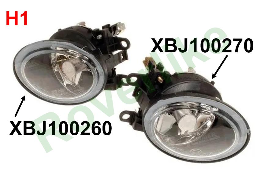

Two types of fog exist - older type and newer type. External housing is the same.
Internally older fogs type have metal glare protection cup. From the rear side difference is that older type use H1 bulbs which are held in bulb holder
Newer fogs type use H11 bulbs, In this case there is no internal glare protection cap as H11 bulbs have one on themselves, and there is no bulb holder too, as H11 bulbs have one on themselves too.
Bulbs H1 and H11 CAN NOT be interchanged between these two types of fogs.

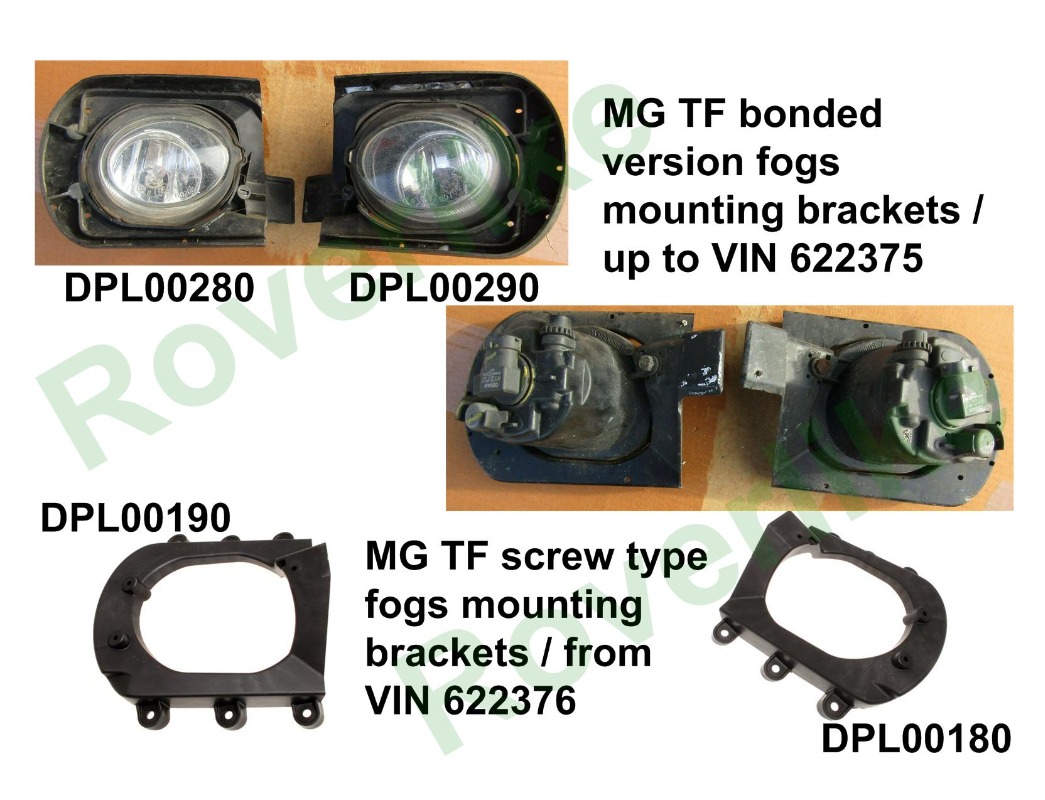

Following is the rest of parts that you will be needing if you intend to retrofit fogs on any MG F/TF car.
Mounting brackets and bezels

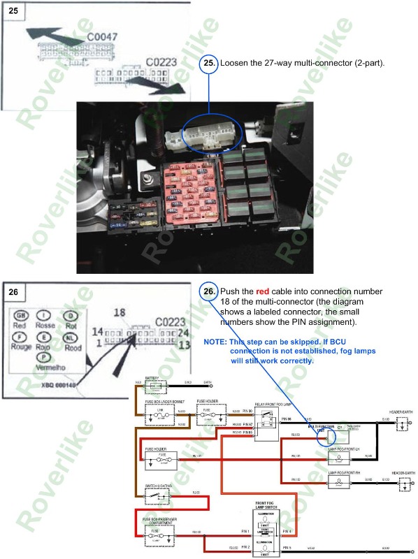

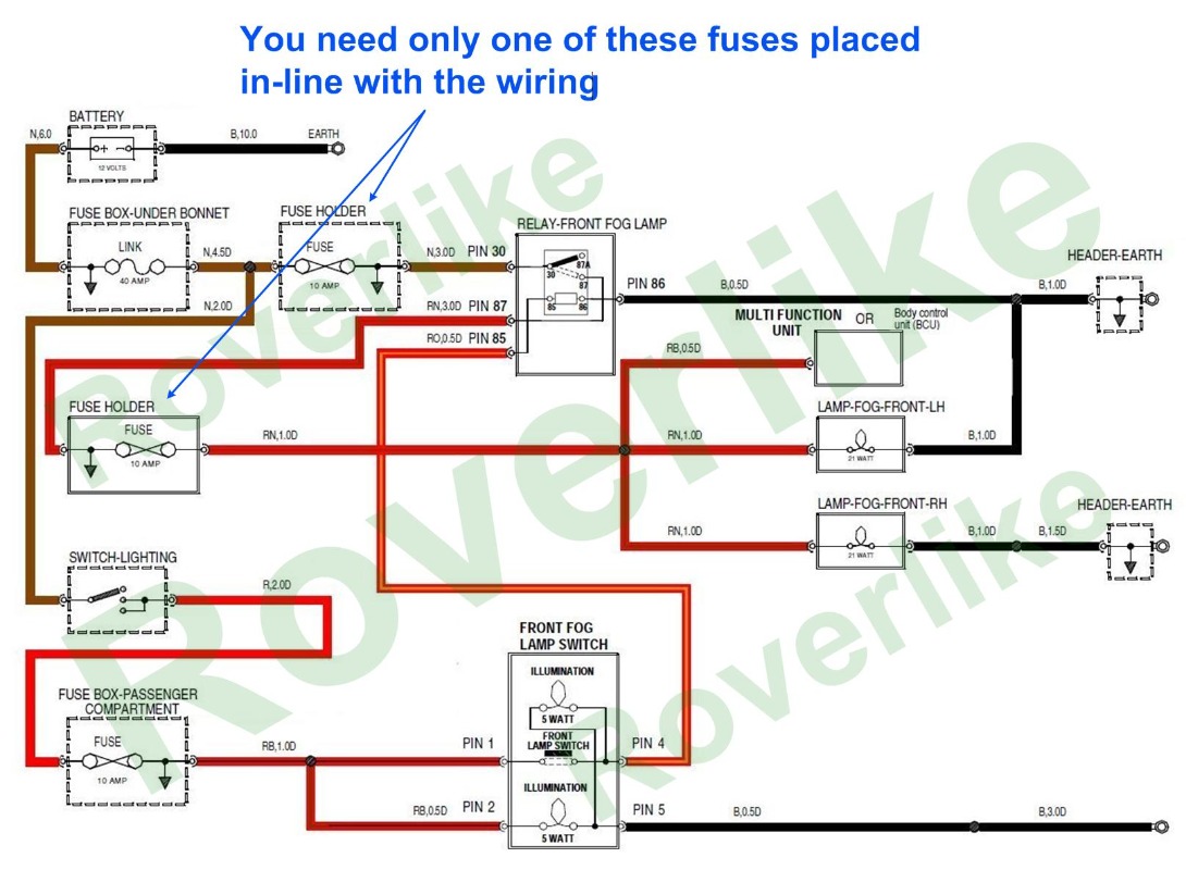

Replied by Roverlike on topic MG F/TF Fogs - Parts, Wiring Diagram, Installation Guides
Posted 4 years 6 months ago #198008

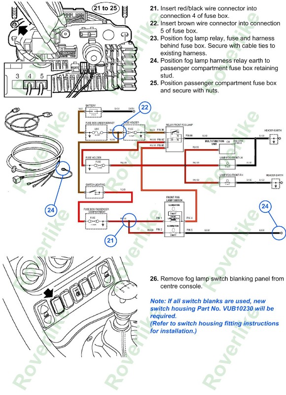

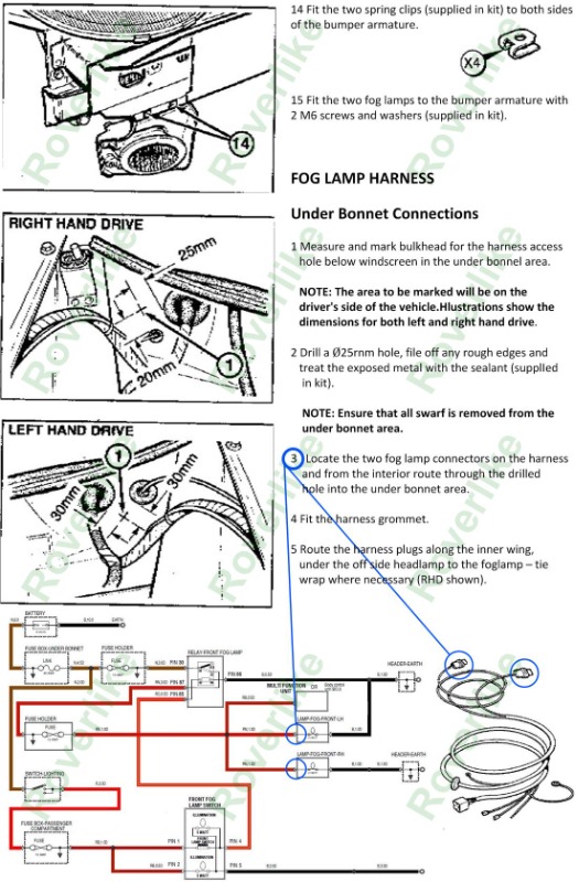

You will need to create your own or buy existing (on the market) wiring for front fogs. Below is the wiring diagram which is actually the same for all models. I included few variants which you could use or not.
In case of MG F mk1 MG F mk2 and MG TF mk1 it is expected that you mount in-line fuse on the wiring.
In case of MG TF you can use existing place for fuse which you can see from installation guide.
Wiring of Front Fog Lamps
Last Edit:4 years 6 months ago by Roverlike
Last edit: 4 years 6 months ago by Roverlike.

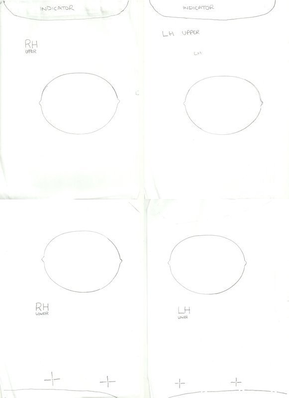

Posted 4 years 6 months ago #198009

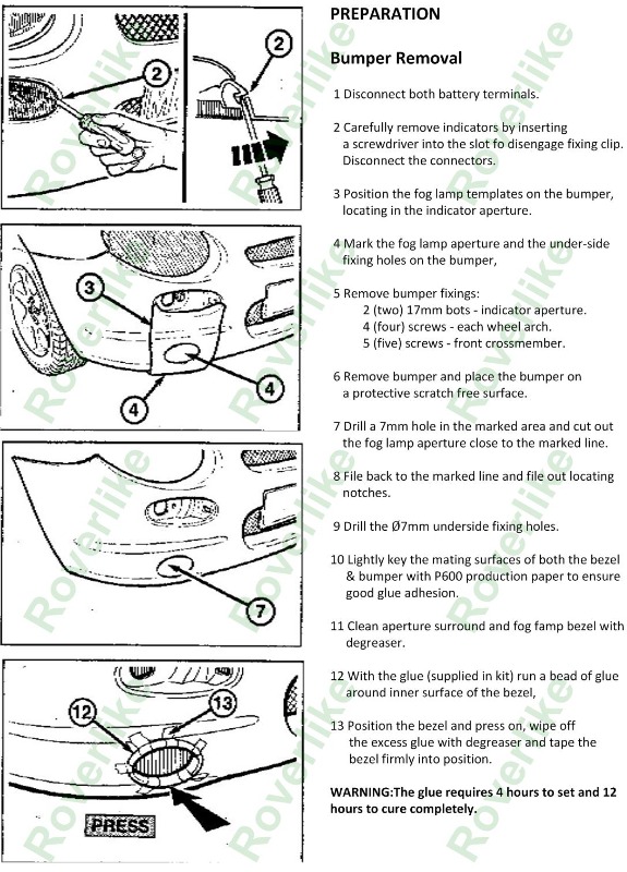

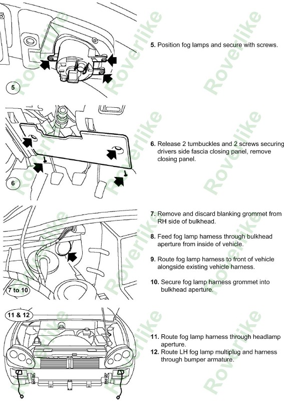

MGF mk1 & mk2 Installation Guide
MGF Fogs Template .pdf File
Courtesy of: https://www.mgfregister.org/forum/viewtopic.php?t=10112
This browser does not support PDFs. Please download the PDF to view it: Download PDF
MGF Fogs Template - how it looks in .pdf file
MGF Fogs Template - example how to apply
Last Edit:4 months 2 weeks ago by Roverlike
Last edit: 4 months 2 weeks ago by Roverlike.

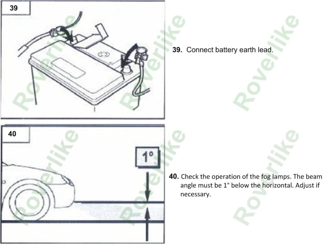

Posted 4 years 6 months ago #198010

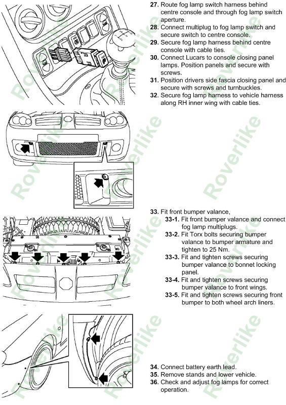

MGTF mk1 Installation Guide

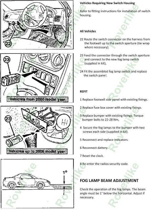

Posted 4 years 6 months ago #198011
MGTF mk2 Installation Guide
