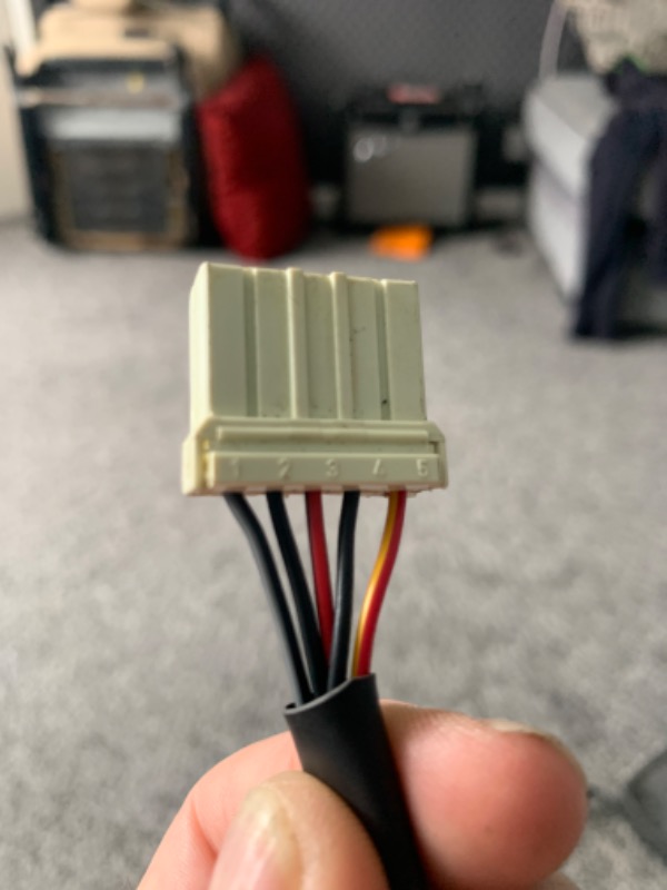

Hi all, me again.
ok so now I have managed to sort a replacement loom from a mk1 car with a mk1 consol. As I mentioned before, I have a mk1 car with a mk2 consol (still with me ).
ok so the loom has everything on it that worked ok on the car. But I need to swap the mk1 switch with a mk2 switch and of course it’s not a direct swap.
on the mk1 connector to the switch is 5 wires   as per picture, I don’t know if this configuration would be the same for the mk2 switch, if it is can I simply heath robinson the connector to fit.
cheers.
by PipL
Not sure I am able to follow you. Mk1 and mk2 switches have the same connector. If this is not the case with you can you show me what type of switch is your mk2 switch? What type of connector is expected there?
Second it is extremly hard for me to say anything with 5 wires to the switch you have in your hand without knowing what each wire is connected to on the other end.
